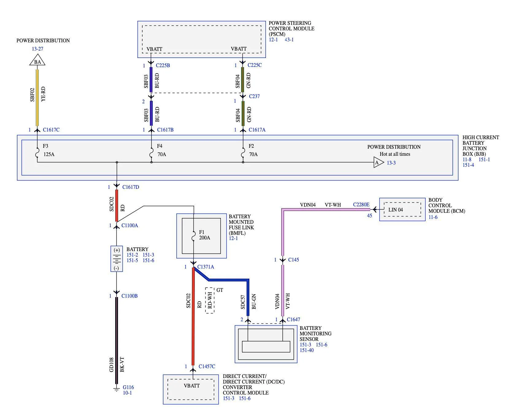

I'm back up and running no thanks to Ford or 4 different tow companies. After 6 hours and no tow, I decided to have a go at it. BTW, It's a pain in the ass to remove the frunk with minimal tools on the side of the road.
The wire on the right was reading 1.9 volts on the terminal but 12.5 on the actual wire. It took about 4 full turns to tighten it up.
Here is the diagram. That failure point is definitely MME temporarily bricked until tightened. Seems more likely to be a manufacturing failure, those metals are designed to hold tight once installed and properly torqued. Opinion/speculation: Most likely, for whatever reason, it never got properly tightened at build, and QA marked it blue without catching to problem (perhaps it was just snug and looked right). Generally loctite is not used in this type of electrical connection. The DC/DC converter (lower left block) couples to the battery via the 200A battery mounted fuse. Then both of the battery and the DC/DC converter couple to the MME 12V bus (main distribution) via that #2 red wire SDC02 left side of the drawing at C1617D, which also then extends up to the 12V jump terminal as discussed. That point of failure guarantees no 12V distribution everywhere (except the little 12V bms computer one contact point mounted directly on the negative battery terminal, which wires directly across the battery terminals). The MME stopped on the side of the road 12V bus current is probably on the order of 30-40A, so not too dangerous. I don't see much of a short to ground risk, other than a spanner wrench type accident (while tightening that nut), which would likely melt/splatter some metal before the 200A battery fuse blows, as backed up by the DC/DC converter too. But, not a lot different than any other standard 12V vehicle battery risk.
General 12V safety approach would be to lift the negative 12V battery terminal first, same as any other 12V installation work would call for. The idea is that once the 12V negative connection to chassis is open, you no longer have to worry about a tool accidentally bridging 12V positive to ground. Of course here, there is that slight nutty concern where some Ford docs (apparently concerned about torque damage to the little bms computer block), want you to lift the chassis side (13mm nut, 10 minute operation) (diagram G116) of the 12V negative cable instead of the 12V BMS side directly at the 12V LVB negative terminal (10 mm nut, 10 second operation) (diagram C1100B). Also, open the little plastic hv disconnect interlock to assure that the DC/DC converter does not come on while doing any 12V work (connecting / disconnecting cables, including tightening the nut of this thread).
That stud/nut is at C1617D below. All 12V supply, battery and DC/DC converter are below that. All MME systems (ALL of the 12V loads) are above that single point connection, including power steering, which no longer works.
