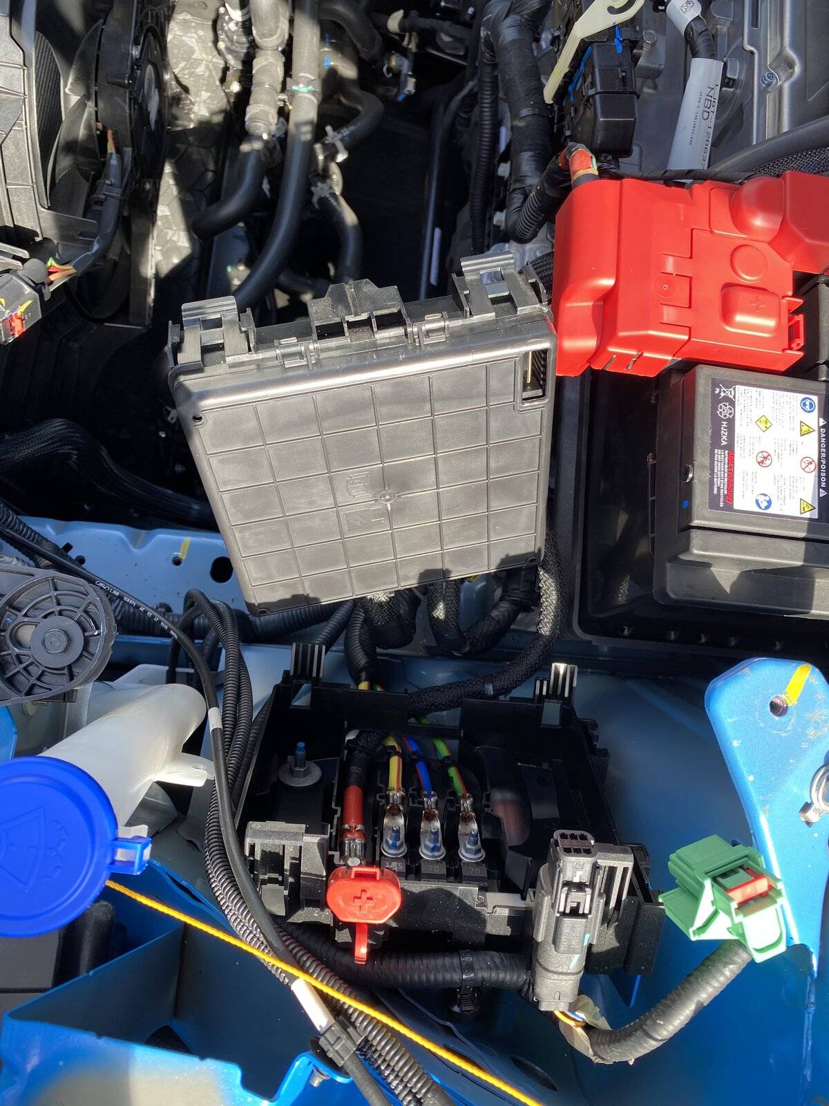

The nut in question (second picture below, right, red cable) is only accessible/visible after the BJB fuse box is rotated and lifted out of the way: The red plastic safety cap (hat), second picture is the 12V jump point (under the "+" hole in the cover we made), which is just above the nut in question. hey, there is no blue mark on my nut!

Benjamin has a good video that shows how it all comes apart, skip ahead to 8:42 (then watch the entire video if you have never removed the frunk tub and want to do it).
A couple of items of caution, the WSM (work shop manual) does suggest removing those two multipin connectors from the face of the BJB (the main/frunk 12V distribution fuse box). I found that if I was gentle, I could leave them connected and gently move the wire harness. Also, the frunk tub bolts can bind, be gentle and careful removing and reinstalling them, it does not take much force to break one of those bolts. I worked in there so many times, I gently re-tapped all of those holes.

The nut in question is only accessible/visible after the BJB fuse box is rotated and lifted out of the way:
