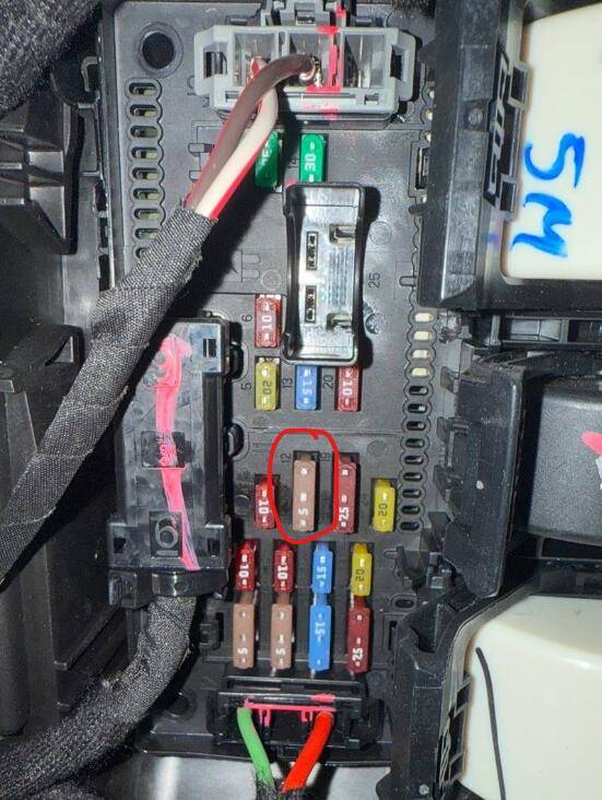

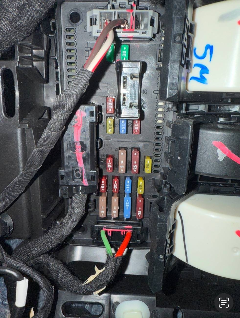

I had the same issue a couple months ago. Searched the forums and pulled, waited 10 min and reset the fuse at the bottom right red 25. The fuse box under the passenger seat. That reset the modem and got signal back.
