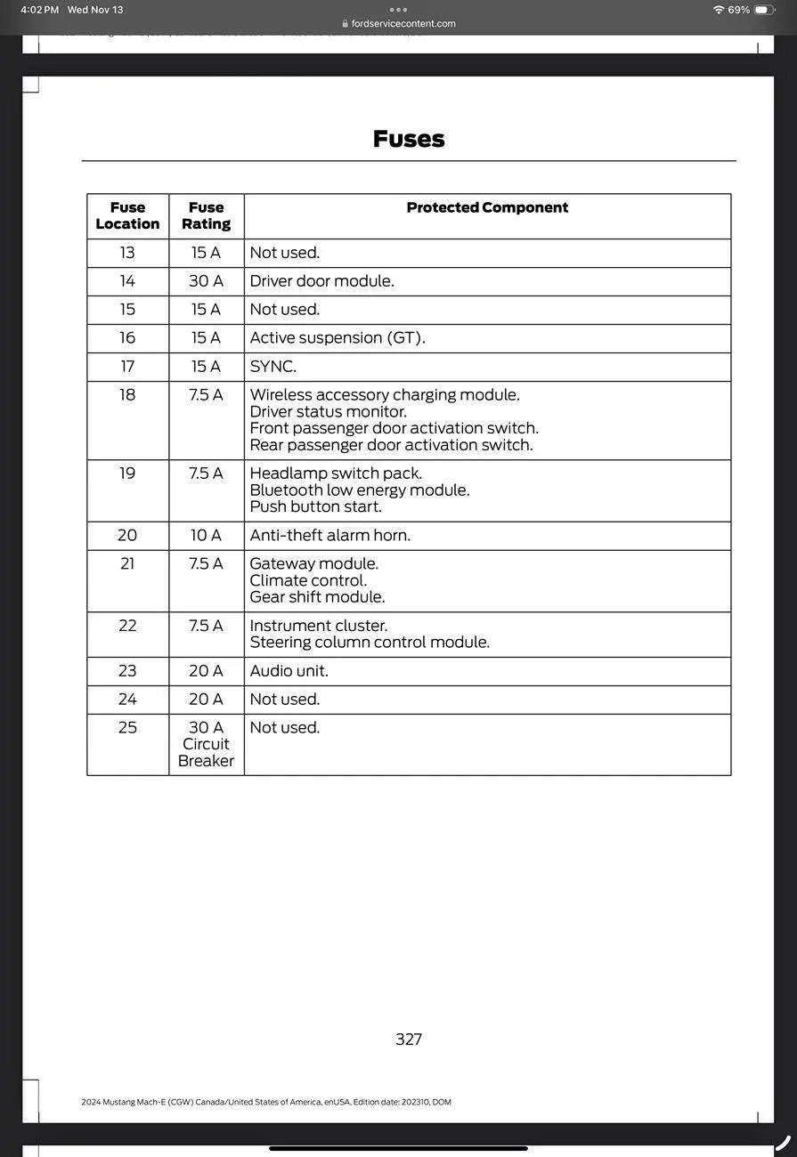

Removing the “bottom right red 25” fuse, and waiting 10 minutes, solved the problem for me! According to the manual (page 327), this is for the Gateway module, climate control, gear shift, instrument cluster and the steering column control module.

@UConnPony @EVEE-G @Gloff @Kamuelaflyer @Snakebitten Ya’ll are the BEST! Saved me a dealer trip, taught me a thing or two AND ended my anxiety over this issue. I pulled the fuse in the middle (that 11/12 one) first and waited the 10 minutes with no luck. Tried with the bottom right red one, waited 10 minutes and BOOM - it showed it connected again on the main display! Then I pulled out my Ford Pass to reconnect right away and that’s working well again too. Thank you all so much!!!

My own Mach e lost connectivity, fuse 11 didn't restore, but fuse 21 did, I'll be changing my strategy going forward

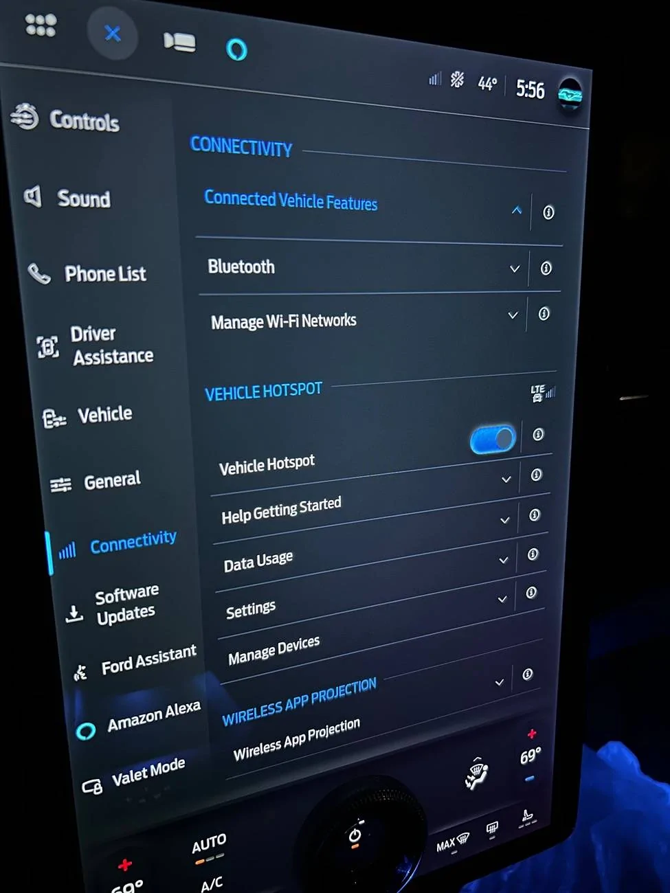

Tried to search and didn’t find much on this - apologies if I missed it. My MME lost connectivity last night while charging. Ford Pass not updating was the first give away. Today, after troubleshooting the app and deleting my car from Ford Pass, I saw the data icons missing on the main screen. And nothing comes up under connected vehicle features in settings. Anybody else see this? Known issue? Is there a fix?
Many others may have said this already but I heard from Ford that you actually need to delete the FordPass app. Especially if you've updated to any new Ford pass app software the latest one caused the FordPass app not to update properly and you have to remove it physically from your iPhone and completely reinstall it and re-set up your phone has a key that solve the problem. The short story is uninstall the FordPass app on your iPhone, reinstall it delete your phone settings on the car and reset them up that should fix it according to Ford.
