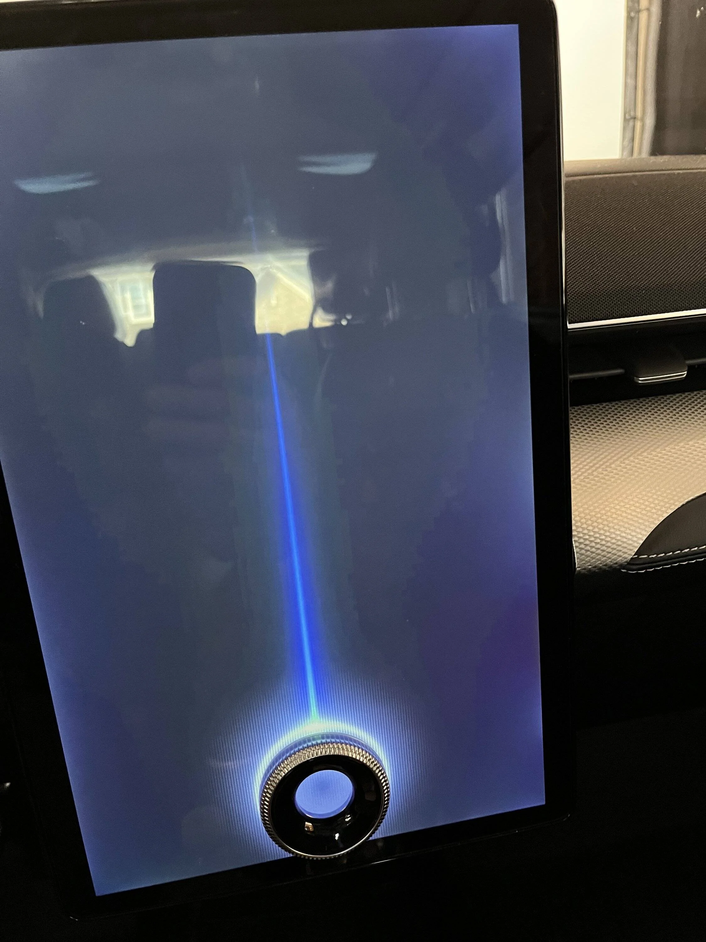

My center screen started having issues today. Originally it was black. I attempted to reboot it with the down and forward button. Every time I do this, it begins to reboot but freezes with a blue line down the middle (picture). If I reboot the screen and put it in reverse the cameras will pop up for a second and then freeze.
I have checked fuse 17 as well and everything is good there. I have waited, plugged into the charger, tried everything I can think of.
Does anyone have any idea what could be the issue or how to solve?

Thanks for the help, is there an easy way to disconnect the 12v battery? I can’t find anything on it.
I came back after a few hours and still had a blank screen. The blue line got a little further in the process after the reset but still froze.
I also plugged the charger in and it said it was going to take about 24 hours to charge 5 percent which would normally taken about 1 hour.
That blue line is actually just a video, not a very good loading status indicator. It was freezing hard enough to not be able to play the welcome video.
