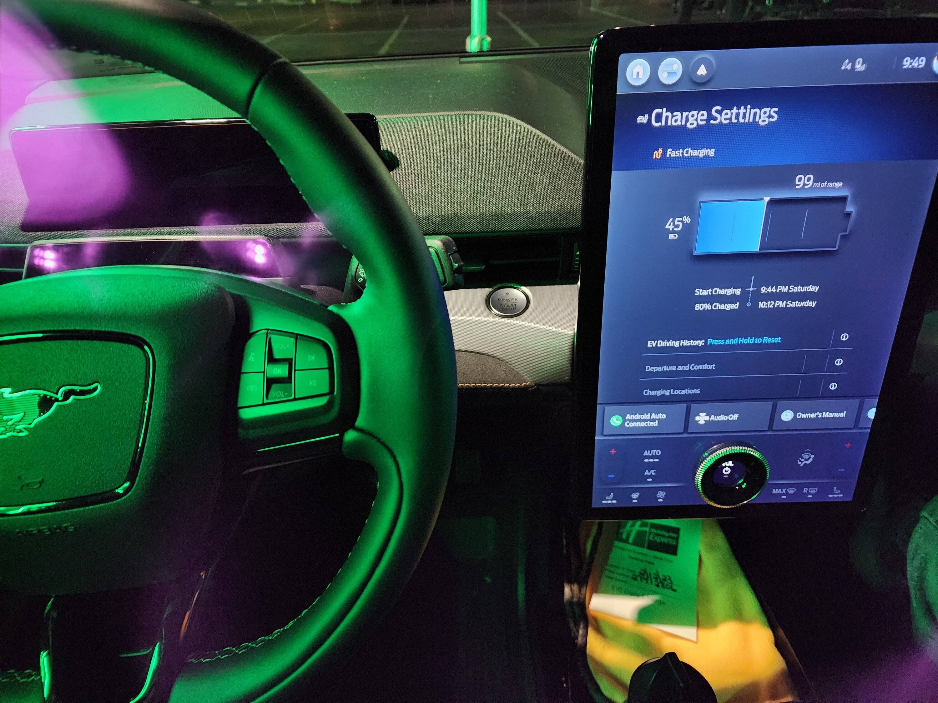

Ford Mustang Mach-E Center Display Screen failed - again 20230211_214943
How about driver screen off but center screen on when charging
