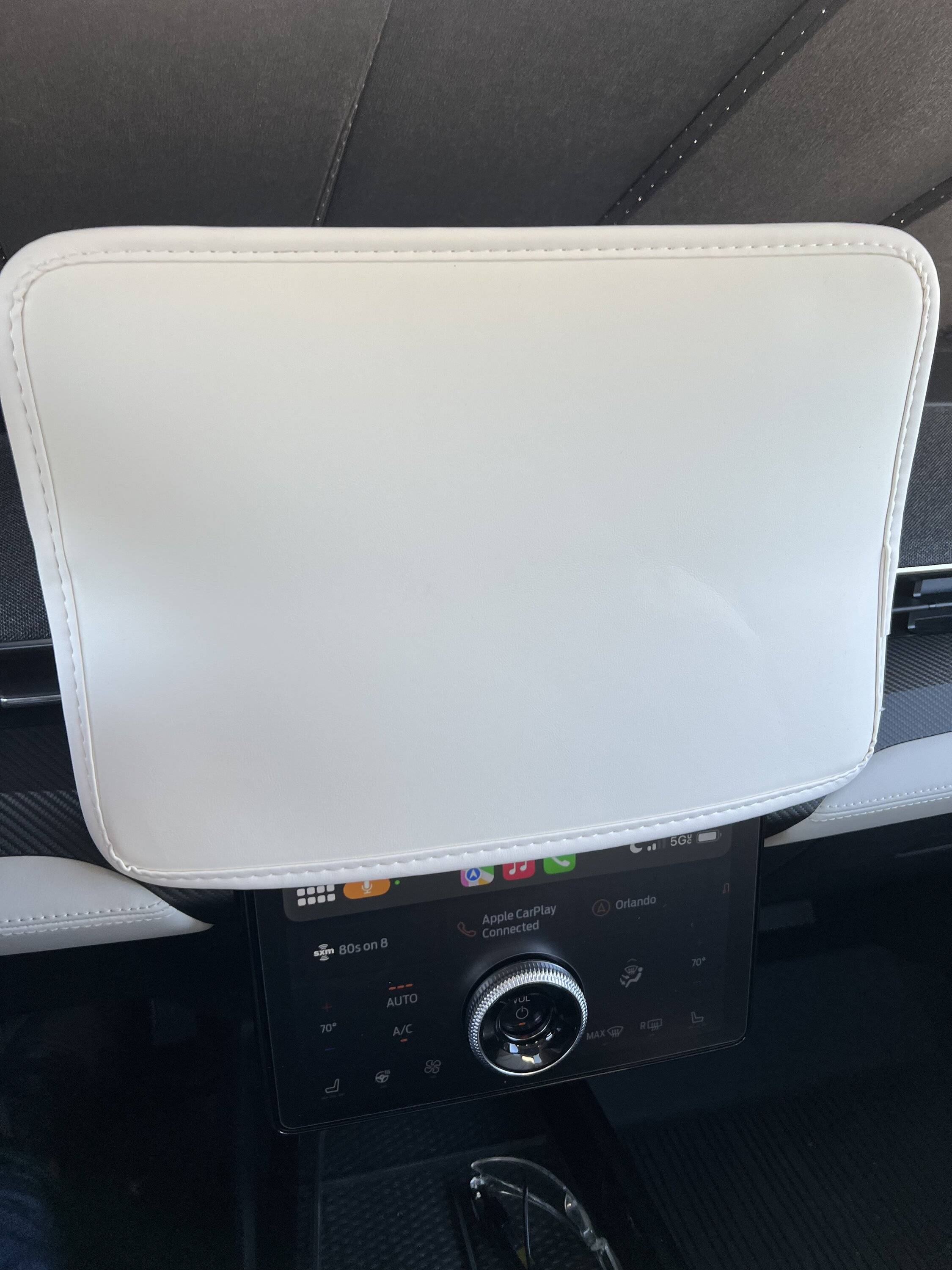

I live in Florida and obviously it’s hot. Anytime I go into the office and then leave a few hours later my center screen will be blank. It is usually hot to the touch on the back and will not reset until I’ve driven for several minutes and the car is cool. I’ve tried using a sunscreen combined with a cover for the center screen (Tesla cover since none available for Ford) and it hasn’t helped. Has anyone else experienced this? Is there a resolution? Should I pre condition the car before leaving. It’s odd that it only happens at the office. Never has happened when out at a store but those are also shorter durations. I’m going to be screwed one day if this happens at the same time as an AC off glitch.
Can't imagine covering the screen would help cool it down. I'd think the windscreen cover would be a better option. My Silver folding screen came with a reflective steering wheel cover, I put that on the back of the SYNC screen to 'help'
Covering would definitely help if the UV rays from the glass roof are causing it to overheat. The windshield screen wasn’t helping. The cover was just a test and it didn’t help either.
Thought the Windscreen/Pano roof both had extra UV protection (hence the issue with Toll roads etc.). I know I can't see into the car at night when my security cams are on IR (Yes I know, not UV)
It does block UV it but I wanted to be sure it wasn’t cause by UV especially since the side windows were downgraded to tempered glass. I’m going to schedule service.
