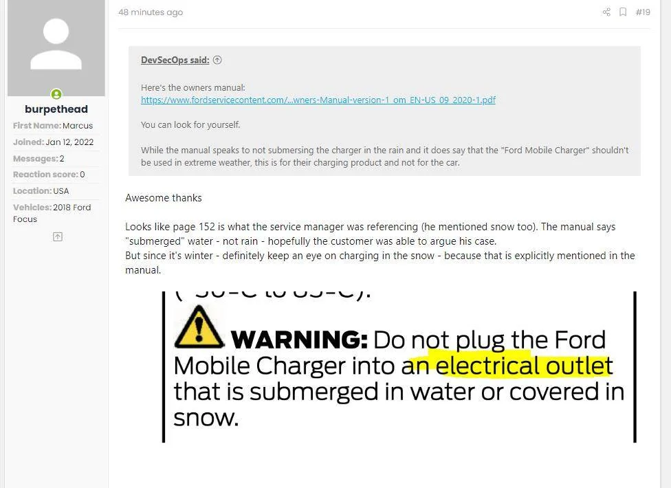

Awesome thanks

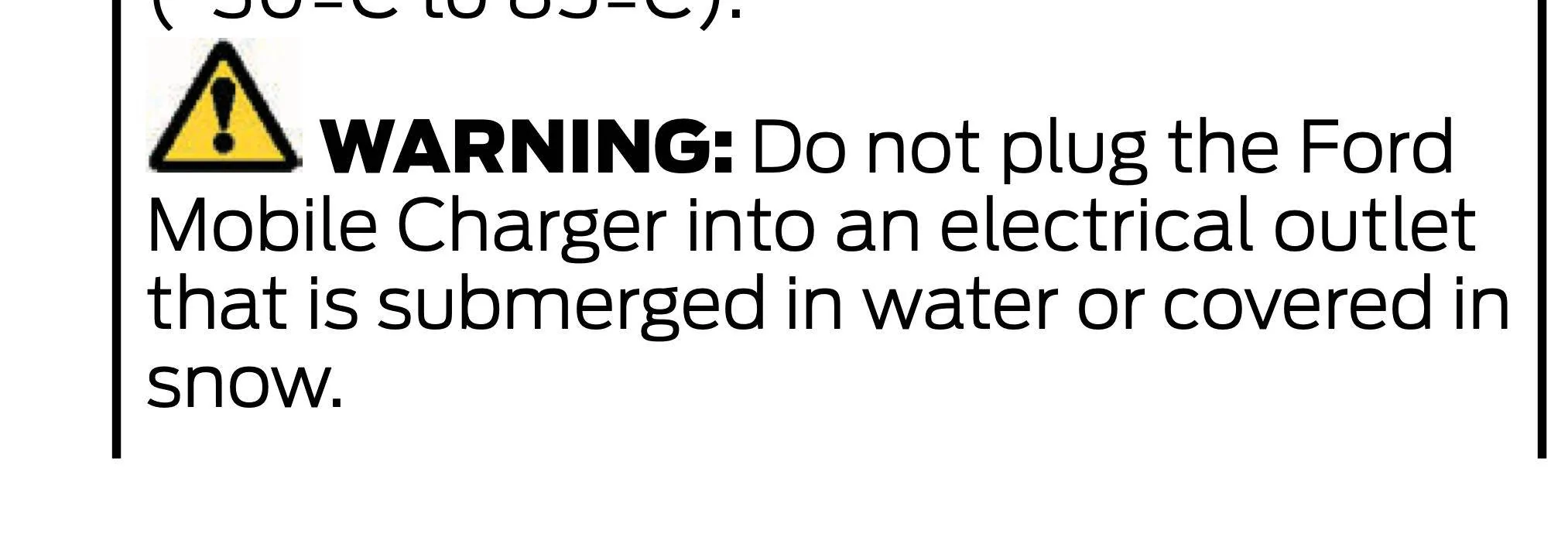

Looks like page 152 is what the service manager was referencing (he mentioned snow too). The manual says "submerged" water - not rain - hopefully the customer was able to argue his case.
But since it's winter - definitely keep an eye on charging in the snow - because that is explicitly mentioned in the manual.

Awesome thanks
No, charging in the snow is not mentioned.
An outlet, COVERED IN SNOW, is mentioned.
Basically, the outlet one plugs into needs to be clear of snow and not underwater. Same is true of any outlet that you plug anything into...

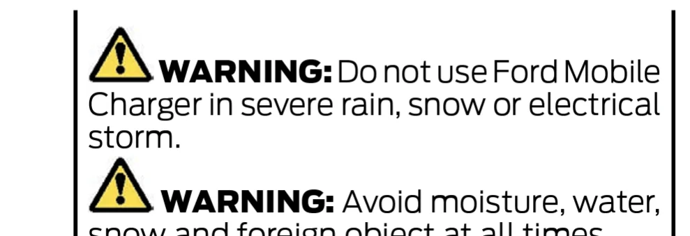

If you would bother reading the manual that I linked it does say that... But again it's for the mobile charger not the car itself.
And because I know you're stubborn and will argue, no where does the below say "outlet" as that's covered in another warning in the manual.
I have read the manual, thanks...
I was responding to the specific citation that was made that clearly says the outlet should not be submerged in water or covered in snow, which is what the posted.
And yes, the mobile charger has a warning about not being used in severe rain, snow or electrical storm. And it tells you to avoid moisture, water, snow, and foreign object at all times.
And it says that you shouldn't allow charging equipment to be immersed in water or liquids.
Wasn't talking to you. Responding to the person that posted the picture that said the words "electrical outlet"... Have a good day.
