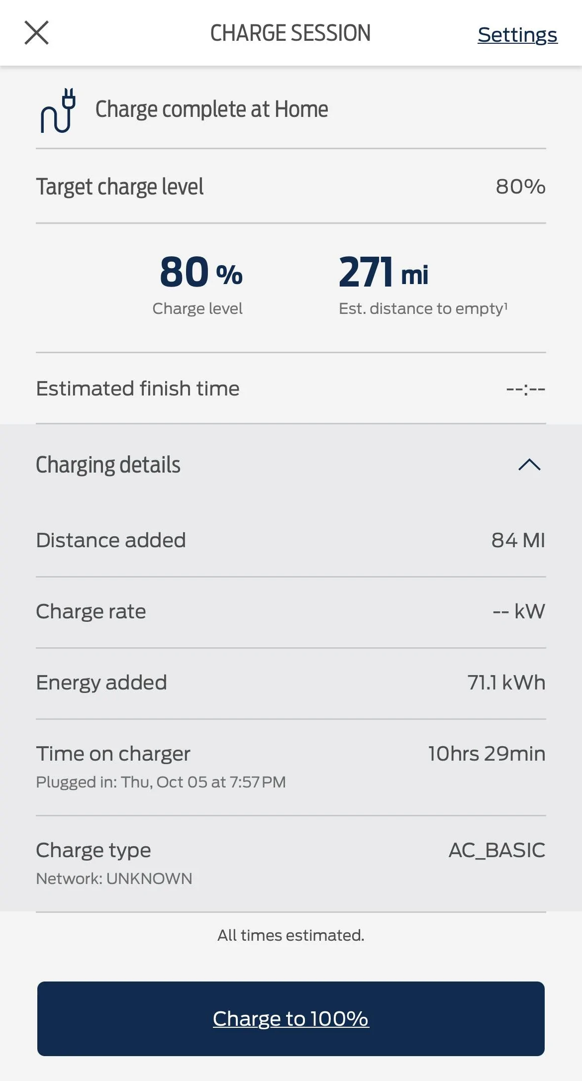

Last night I plugged in about 8:00 pm, it finished charging about 10:40 and at that time it had added about 22 kWh to get me the 84 miles it added.
When I looked at FordPass this morning it showed 71.1 kWh had now been used.
Something doesn’t appear to be adding up with this being “natural characteristics” from my perspective if it used almost 50 kWh to do whatever it does after the max charge was reached while making the humming noise.
