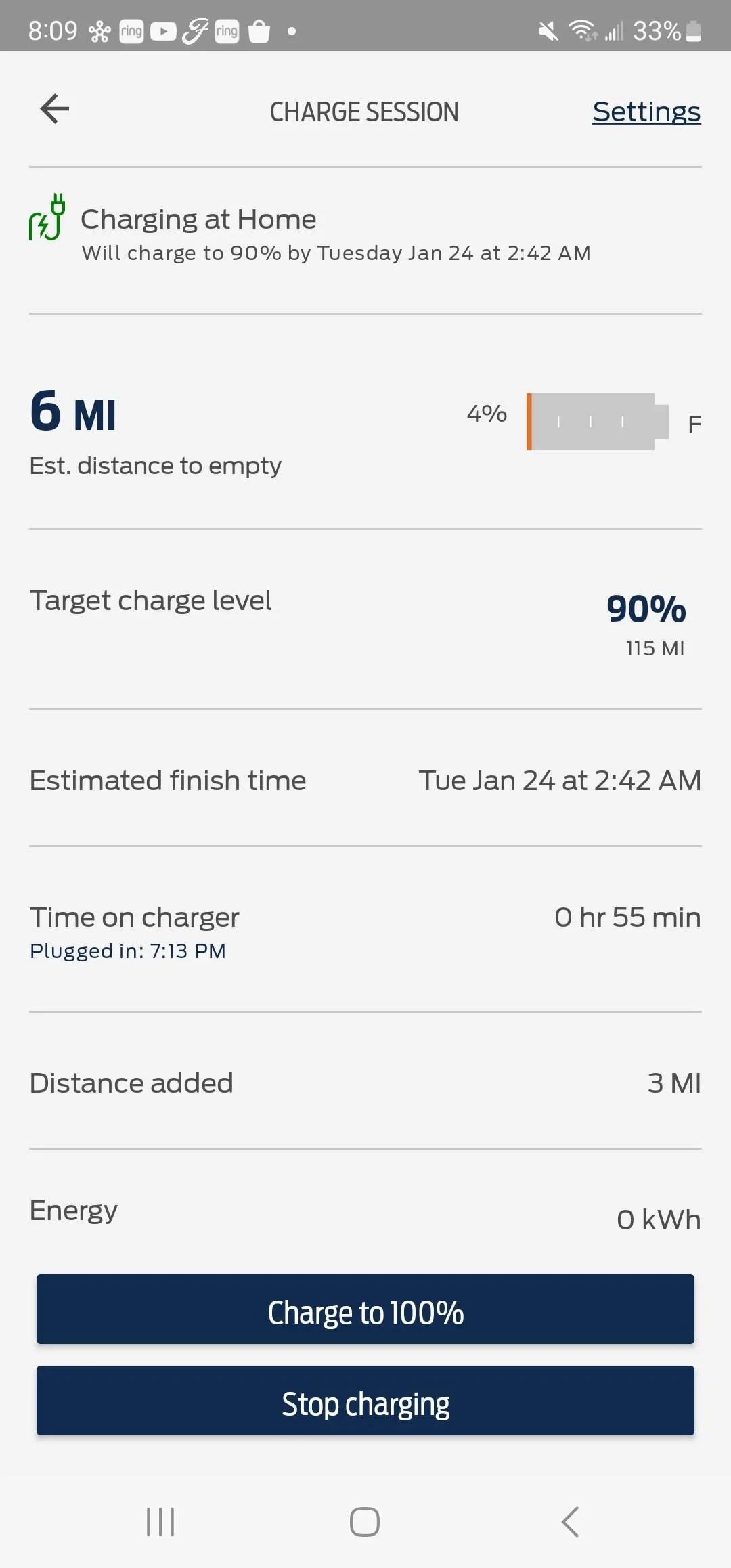

Departure time doesn't work...
Is it a 120 or 240 V charger? 55 minutes on the charger and only 3 miles (2KWh?) added? But it estimates that charging will finish before 3 am, so maybe it was on the charger for 55 minutes, but didn't actually charge...
115 miles looks very low for 90% even for a standard battery. I'd expect at least 135 (1.5 miles per 1%, that is my experience in below-freezing city driving).

It's level 2 40amp 9.8 klwh charger.

I got mach premium and 3 weeks ago I charge it to 80% but range is like 115miles.Any one else with same issue...any suggestions to increase range.
You’ll get to about 170 mi range @ 80% when it gets warmer but will be 190-200 when you start charging @ 90%. My thought is that the ER is a better choice in cold weather but $7000 plus lost rebate makes that a tough decision.
Hi,
I have a standard range awd, currently with 49% battery showing 74 miles on GOM. I live in NY.
Few things you can do, the days you drive please precondition your battery and climate control, set in the car not in the ford pass app. And use climate control as needed ( heated steering wheel and seats are your friends here). And drive 55-60 mph if possible. These things will help you get 150 miles. And you can charge your car to 100 % the day you drive ( it has a top buffer , meaning the battery is not really 100% even though it says 100%. My two cents
The app departure time was supposed to have been patched on latest release.

Pick whichever mode you prefer. Same goes for 1PD or 2pd. I have stuck with 2 PD because I an an old fart and it feels the same as driving my Expedition. I also prefer Engaged. Whisper is super smooth and if I only drove in town I would use it. Every now and then I select Unbridled but the car is quick enough for me in Engaged. If there was more opportunity for wide open driving I would do more. If you are smooth on the brakes then regen in 2pd is equal to regen in 1 pd - basically you never use your friction brakes. Pro Tip - every so often as you coast down a hill switch to neutral and brake. That uses the friction brakes and cleans the rust off of the rotors. So in your case read up the owners manual. On the night before you head for work program in a departure time and also set the charge for 100%. That should get you to work. Question is do you have the ability to charge at work and get home? If so then the same thing there. Charge to 90% otherwise as suggested in manual.

On the days when you need to drive long distances, charge your car to 100%, precondition prior to departure, use only the seat and steering wheel heaters (much more efficient than heating the cabin), and don't drive overly fast. Good luck.
