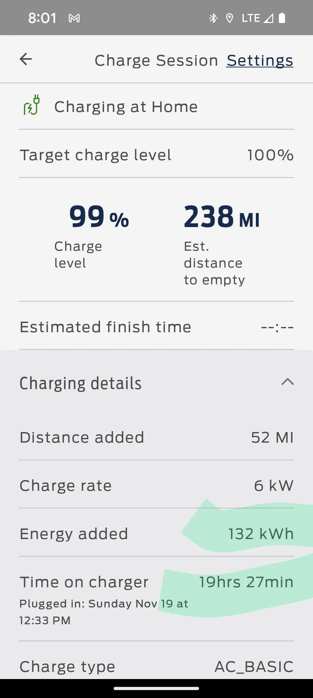

I wish I had 132kW that was charged (=
I was at 79% when plugged in. ~40F temps.
Cold wires and cold 50amp breaker which means "not really charging anything".
The fan ran for 19 hours. I unplugged/plugged which reset back to my 90% default target charge and the fan stopped and remained stopped. kW used is < 1kW
Yeah, I think the issue is that the MME isn't sending the "charged" notification back to the EVSE. Its not "really" charging and killing our house energy bill, its just stuck at the car saying both "charged" and "almost charged" at the same time. Hence the fan running continuously.
Just not sure if this does it at the 90% target same as 100%... like will it stay stuck at 89% forever?

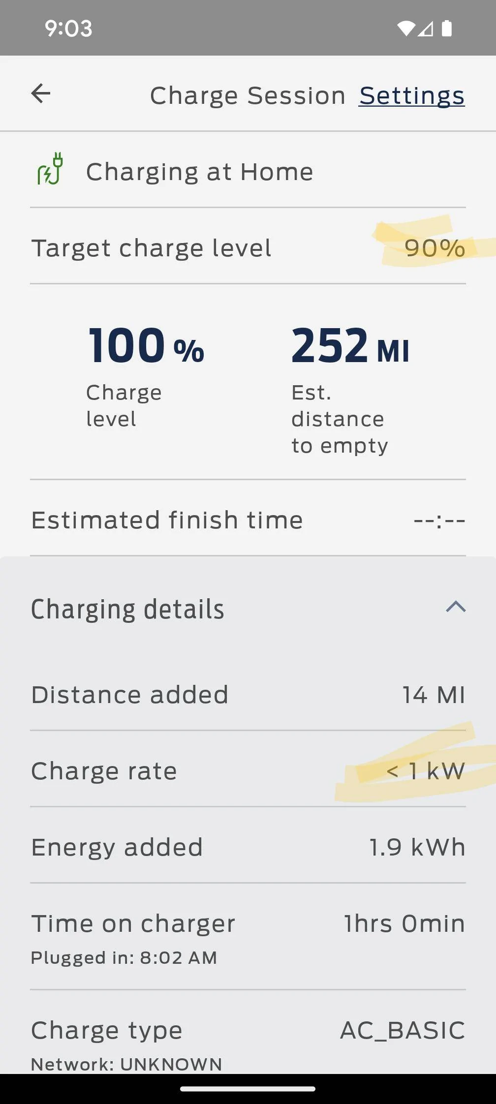

Ford Mustang Mach-E Charging issue 1700493736565
After unplug/plug again
Ford Mustang Mach-E Charging issue 1700493836842
Now showing no charge at all.... this is good. No fan running.
I wonder if the 132kwh is actually used or fordpass just thinks it's used. I mean where would the kwh go, I would think if it was really sending that kwh the battery would explode?
I've tried at 100% 90% 80% and 85%. For me it gets to the threshold (100, 90, 85, 80)but doesn't stop, and the onboard charger continues to run until I manually stop it.
Its a bogus calc. That much juice would blow the battery! I could see this "maybe" if it was -30 temps and you left the car on for 12 hours to keep the battery warm! (=
Its some type of non-critical "charge complete" bug. Just sucks that the fan runs unless you fake out the charge like charging to full then unpluging/repluging to reset the preset target.
