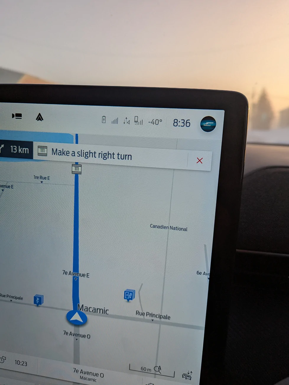

To me, the ability to AC charge has more of an effect than the temperature between ICE and EV. I drove mine up in La Sarre (northern Quebec) earlier this year, and left my mom's house at an indicated -40°C on my way back home. I can tell you that, even with a block heater, it is a rough temperature for an ICE car (my other car is a Ford Edge). It was not a perfect trip (hit turtle mode at 35%!), but otherwise, the car was warm when we left, which is a big plus.
Have I had a 240V or EVSE charger at my mom's house (had to keep it charging on 110V), it would have been for sure an easier trip (had to keep going to the nearest Ford dealer to top it off on DC). Once on the road, the first DC charge was slower while the battery was warming up, but I have to say, I was impressed at how it kept a pretty decent pack temperature afterward. Energy usage was high, but once we got closer to Montreal, it was less of an issue with the numerous DCFC available. The trip is about 700 km (430 mi) each way.
Tha was a bit of an extreme case, but it was a good test (and one of my first long roadtrip in the winter with an EV). If I get to leave from my house, and have good DCFC coverage along the route, I would not hesitate to take the Mach-E; however, if DCFC availability is spotty, ICE is a lot less stressful.

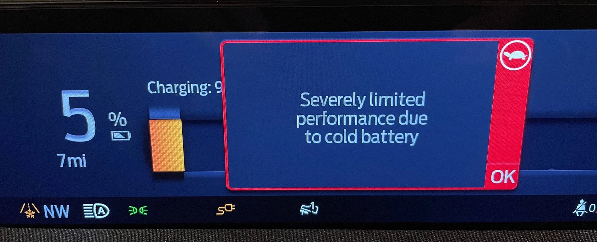

Keep in mind this can happen in extreme cold if you run it down:
…in addition to having no heat.
What battery temperature will trigger this? Or is it a combination of battery SOC with battery temperature?
