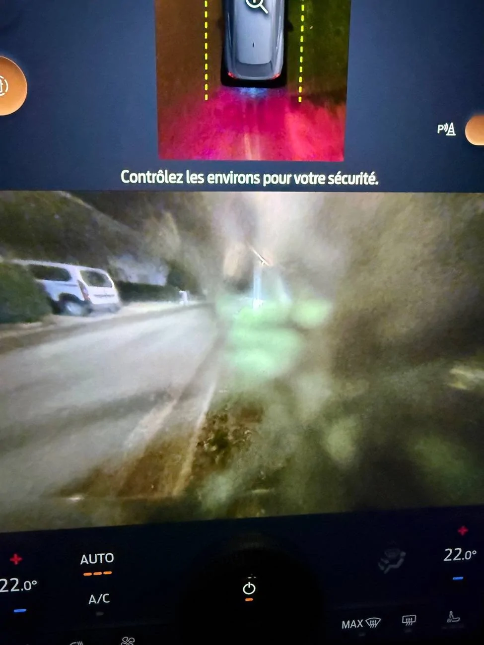

I have the exact same issue , I have definitely no luck at all with this car since I bought it. Can believe I get hit on this small area
Ford Mustang Mach-E Cracked Front Camera Lens IMG_0652
