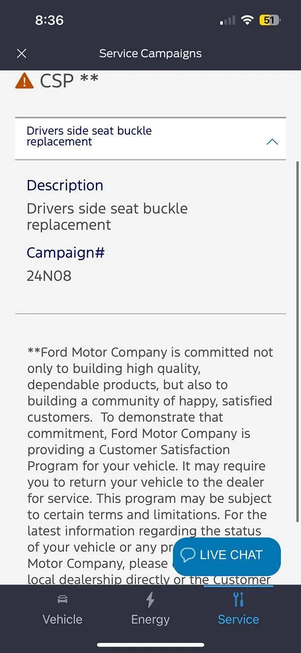

Just saw this pop up for me on my 23.5 Mach-E with a 7/12/23 build date in Ford Pass. Guess I'm calling the dealer tomorrow.
I got the same one. Because I got it the same day a nail was deflating my tire while it was sitting in my garage (got the alert b/w/o Ford Pass App), I brought the car in to the dealer for the tire ($348.75 for the tire and 3 tires' rotation @5200 miles) and showed the tech the seatbelt buckle "Customer Satisfaction" program notification on my phone. Was asked if I'd experienced any problems with it; and I said "not yet." The response was: "If it hasn't been a problem, we're not going to replace it." So, I guess I'm waiting for a "problem." Sure hope it's not calamitous.

A builder botched a batch of buckles.
I examine 100s of vehicles, airbag warning light staying on due to seatbelt/wiring fault in that area more often on the more oft used & moved drivers seat is not so unusual on many models, the MME’s driver seatbelt wiring must be weaker and particularly more prone to this.
