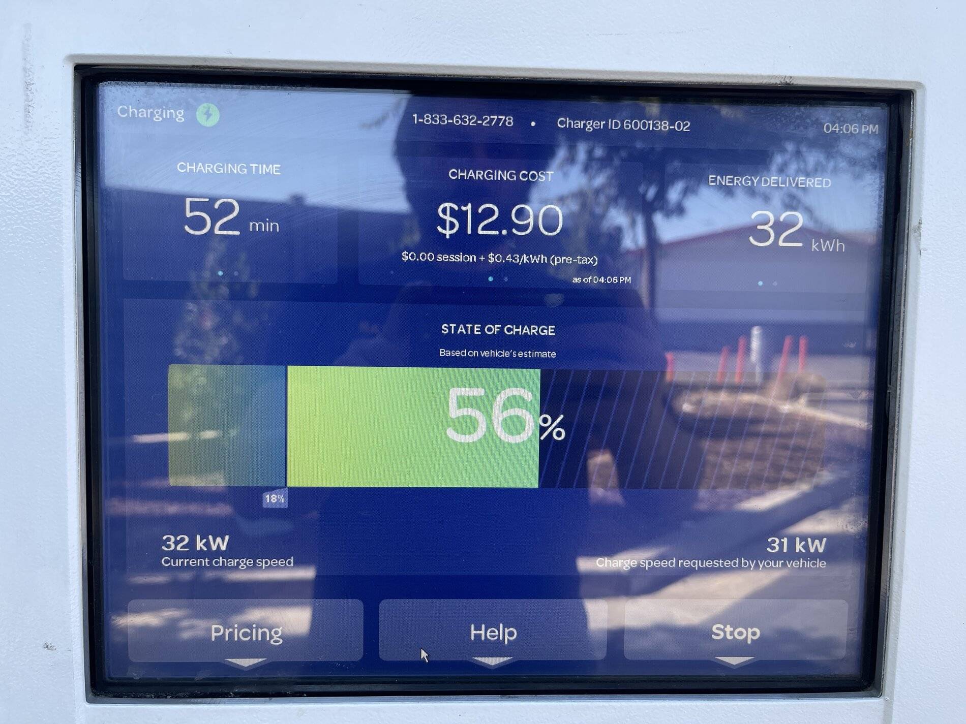

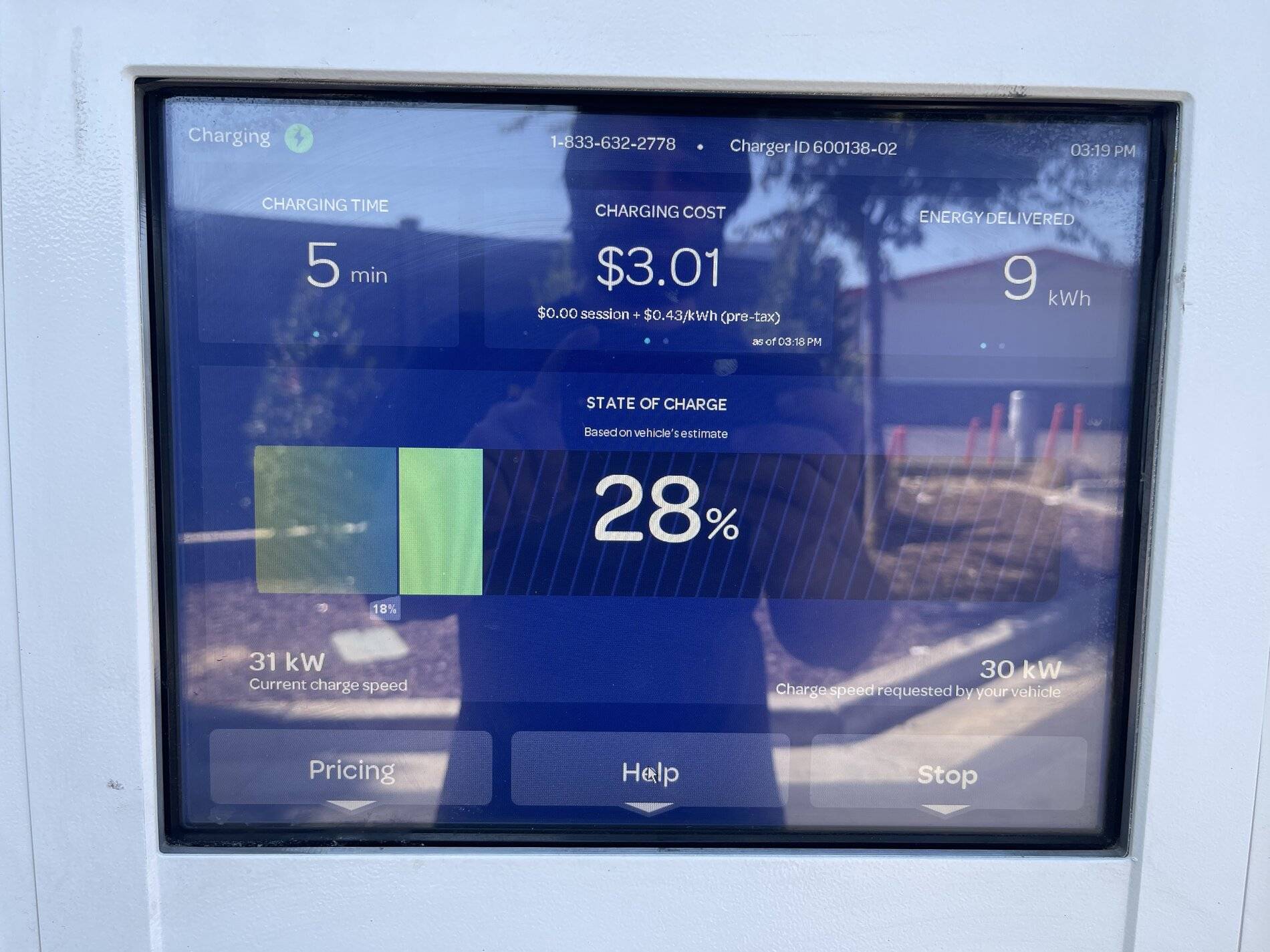

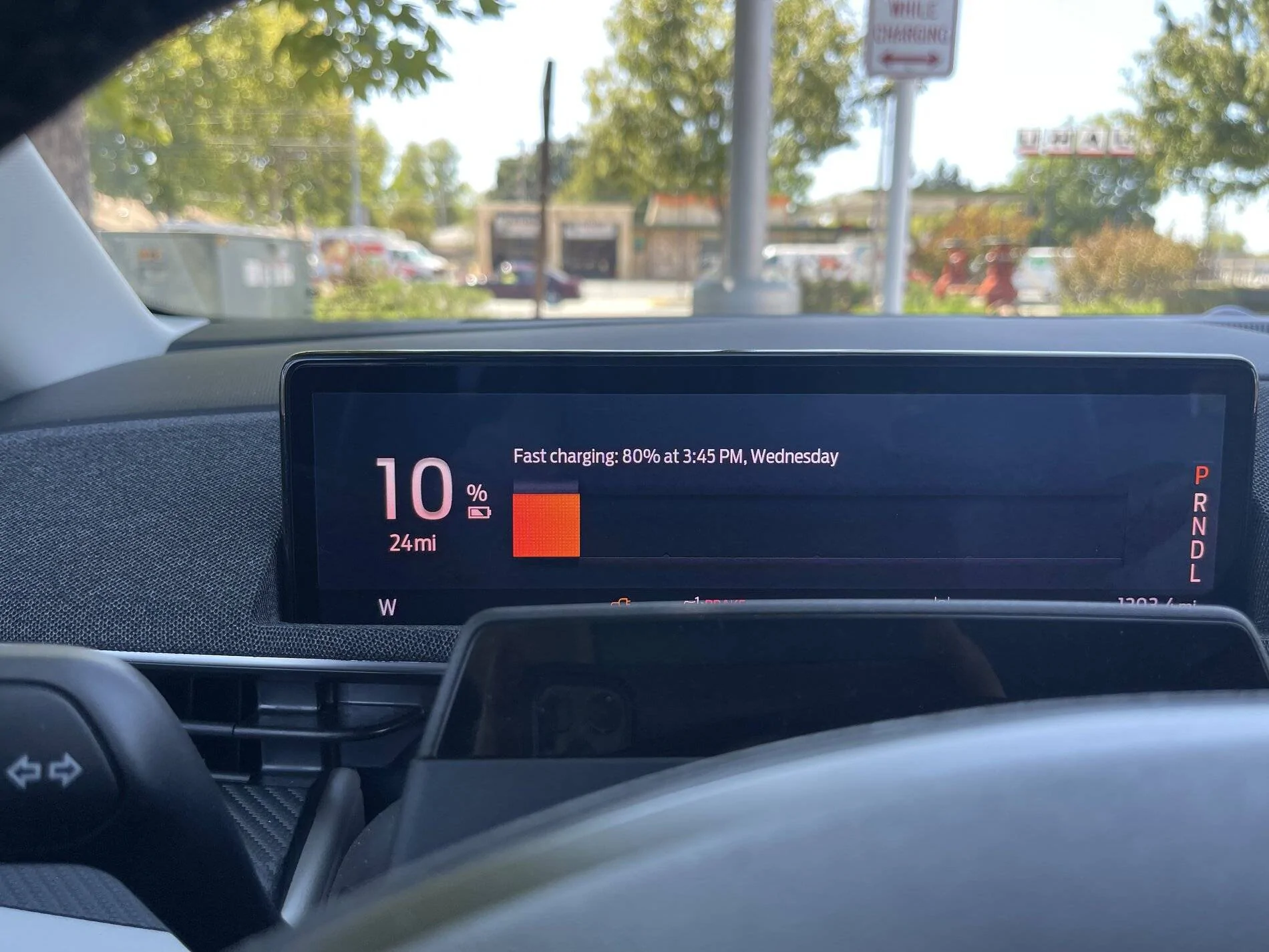

I was just able to pick up my MME E4x 2 Weeks ago and I’ve only been able to fast charge it five times now (at three different EA chargers) but each time has been increasingly worrying. The car has maxed out at 120 KW charge rate every single time. Nowhere near the 150 kW charge rate that other posters have mentioned with their extended range batteries. The next frustrating thing is after only three minutes of charging the charge rate is quickly reduced to 31 kW. This change in charge rate does not seem to be coupled to the current battery percentage as it’s happened equally when the car is at 50 plus percent as well as lower than 10%. I’ve also noticed that even when given time to cool off charging the car with the L1 (120v) mobile charger the car Immediately ramps the fans up to maximum speed and stays there for a few hours. There have been no error notifications In the app or on the drivers display from either of these situations.
The only variable I can think of is that the ambient temperature where I live has remained in the upper 90s to low 100s (F)
I’ve already contacted Ford customer support and they indicated that this was very odd. I’ve set up an appointment with my local dealership to have a look at the car. Will update post if an issue is found.
Just wondering if anyone else is having similar issues.

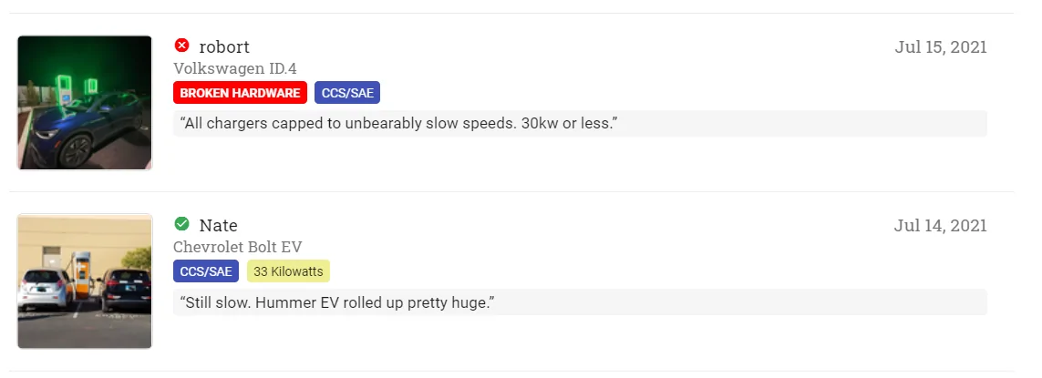

This EA site in Tempe Arizona has 8 chargers, and you can see from Plugshare they are all reported as slow:
Ford Mustang Mach-E DCFC charge rate is abysmal 1626968644475
FYI, pretty cool a Hummer EV was spotted there, I have one of those on order. I was only able to get 35 KW at this site as well, back in June.
