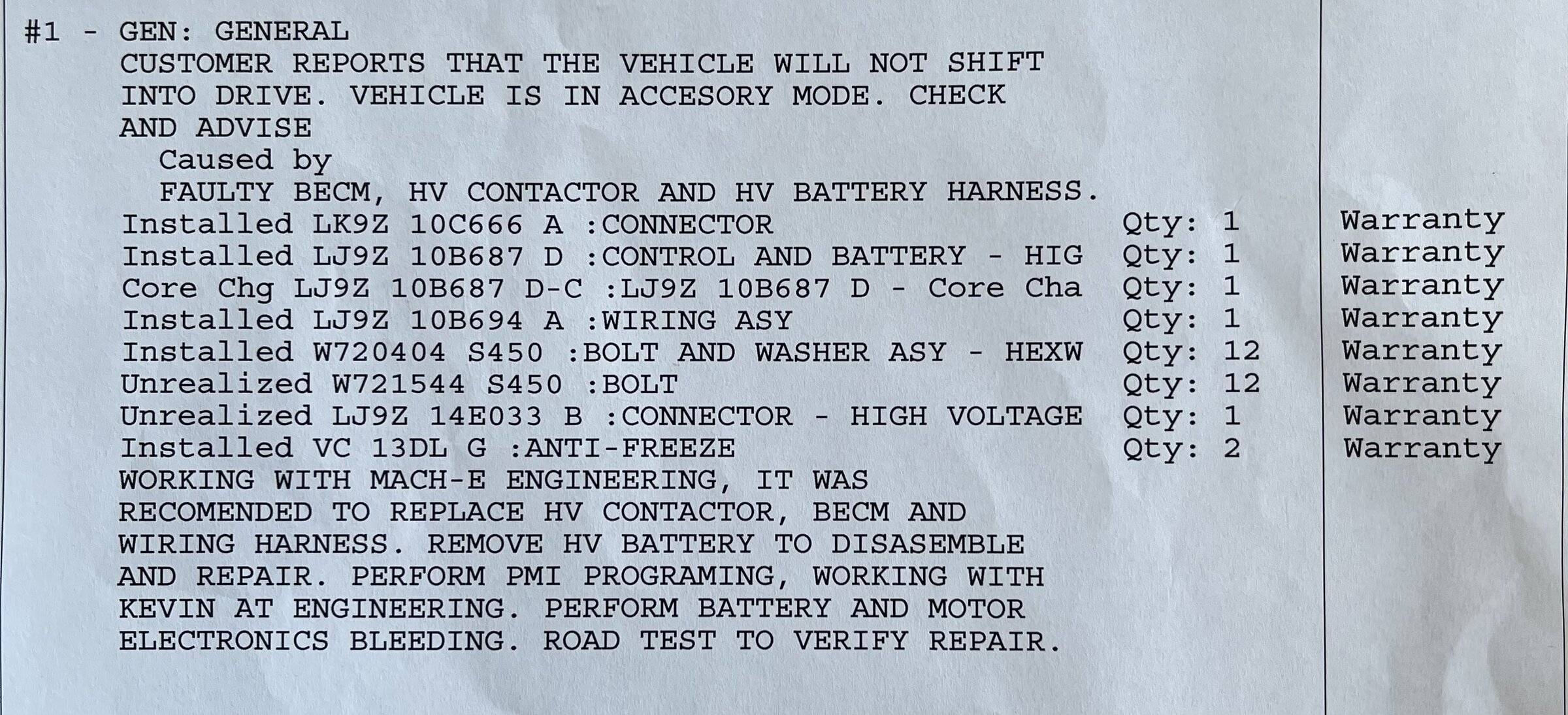

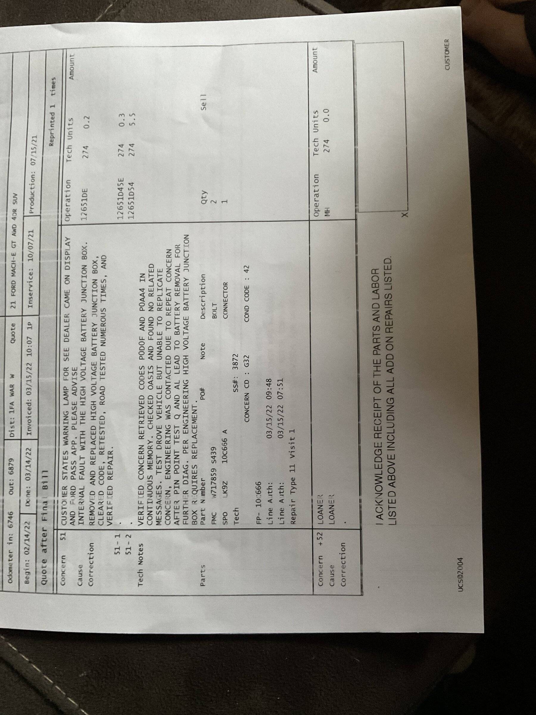

Well I finally got the call and picked up the car today! I’ve only driven it about 4 miles but so far everything seems to be fine. Here’s the final repair documentation
Ford Mustang Mach-E Dead Car Thanks to Cold Temps Causing HVB Module Errors 9F86D560-90B7-4387-A27C-7910B9AE3043

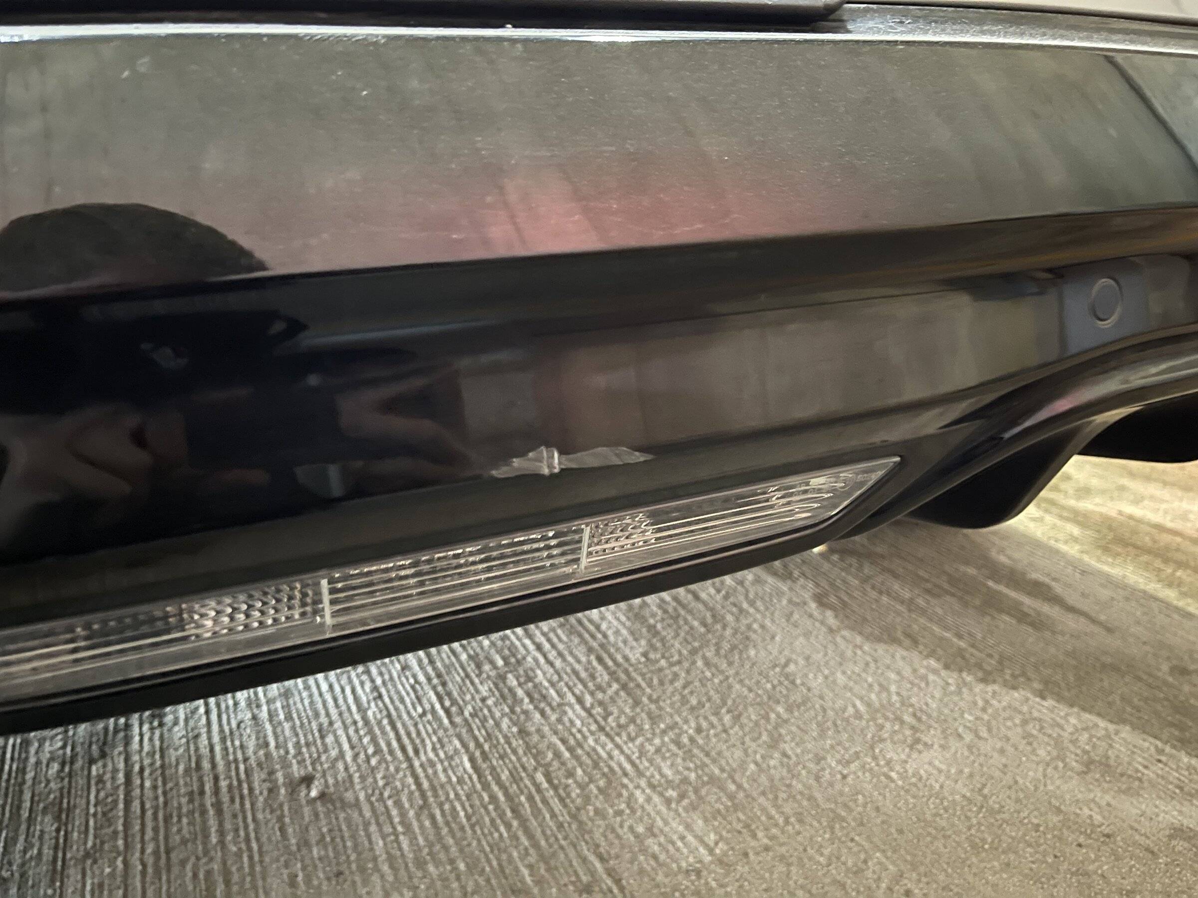

Now the bad news…. I discovered a gash in the rear bumper right over the reverse light. So it looks like someone backed into something and nicked it. Luckily I did a walk around inspection at the dealer and caught it there. I have to go back on Monday since the manager was already gone for the day.
So the saga has not ended yet!
Good thing is, that is an easy fix!
