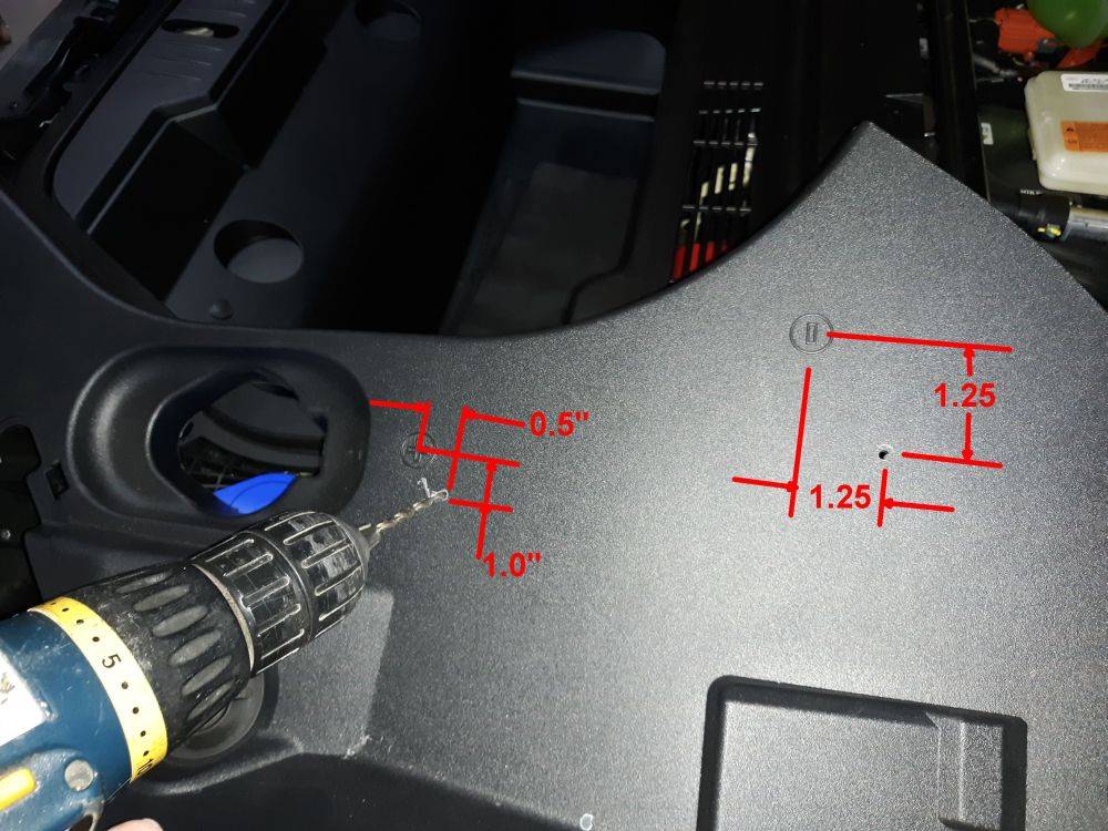

I hear ya, the only reason I did is because of all the reports of LVB problems. Decided to pull the covers and connect a charger for a couple days to avoid problems caused by the car sitting for weeks and weeks.
Best tip I can give you is that the back cover has to come off first because it overlaps the side covers. I think you can get by with just partially lifting the right side, but they will crack if flexed too much.
just bring a drill with a 2" hole saw.... much quicker than pulling the covers.

so yes, IF you have a dead 12v, you could try:
- getting access to the connection points (see 2" hole saw recommendation)
- connecting 'regular' jumper cables from any running vehicle for a good 20 minutes to charge your MME 12v
....then try starting
