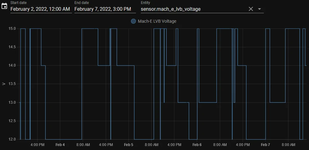

Thanks. 60 minutes off the battery tender and the lvb dropped from 13v to 12v according to the widget. I really hope the widget doesn’t use decimal points or I'm in trouble again.
The car only reports in whole increments. Don't be worried that it's at 12V. The car lives in the 12V range regularly and it's perfectly normal. This happens when it's off and not connected to charge or pre-conditioning.
Most of these people who have issues with the LVB likely have issues with something else that isn't maintaining the LVB, not the LVB itself.

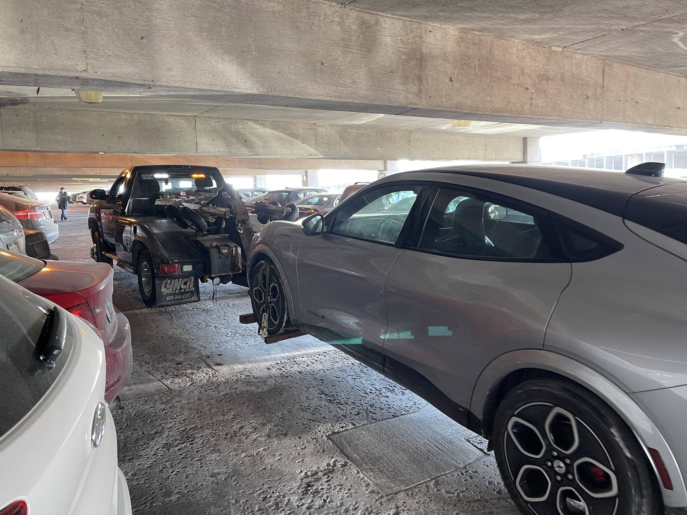

Well the 12V charge over night didn’t fix it, although my widget is saying the battery’s at 13 volts now.
But I was finally able to get a tow truck capable of fitting in the structure and pulling me out. So off to the dealer we go.

Did you get the tow truck or did roadside finally do something useful?
My insurance company found this truck. After the first couple failed attempts they put a special case supervisor in touch with me that was able to book this tow this morning. I haven’t heard from Ford Roadside since my last cancelled tow through them on Saturday.
