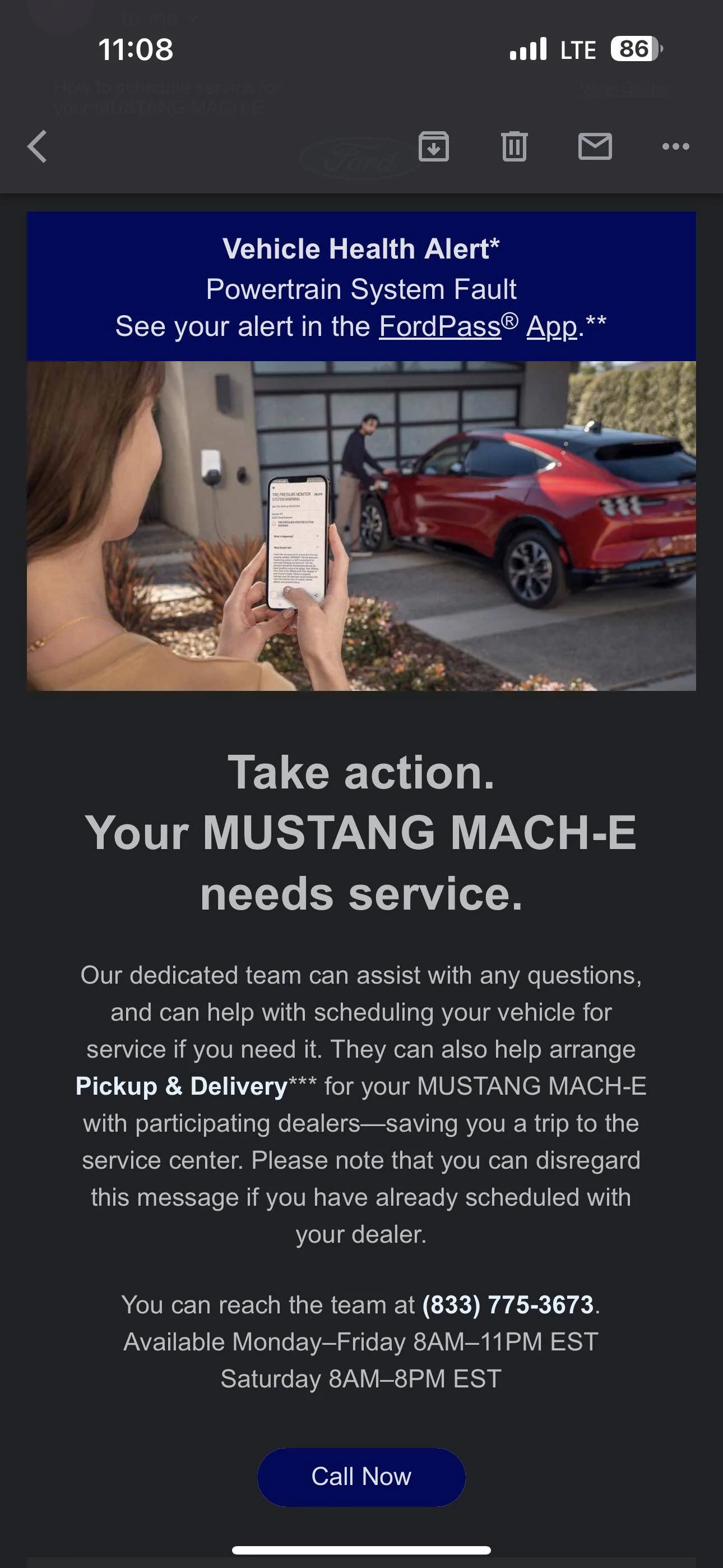

Oddly a month later Ford emailed me just now saying that I had a power train alert. I checked FordPass and the actual car and I have no health alerts. I’m guessing at this point that it’s sending me this from the issue I had here almost a month ago now. Anyone ever experience these kinds if delays with these emails?

Not with respect to this issue but Ford occasionally sends me an email about a Ford GT I had put a reservation on then subsequently cancelled ~18 months ago.
