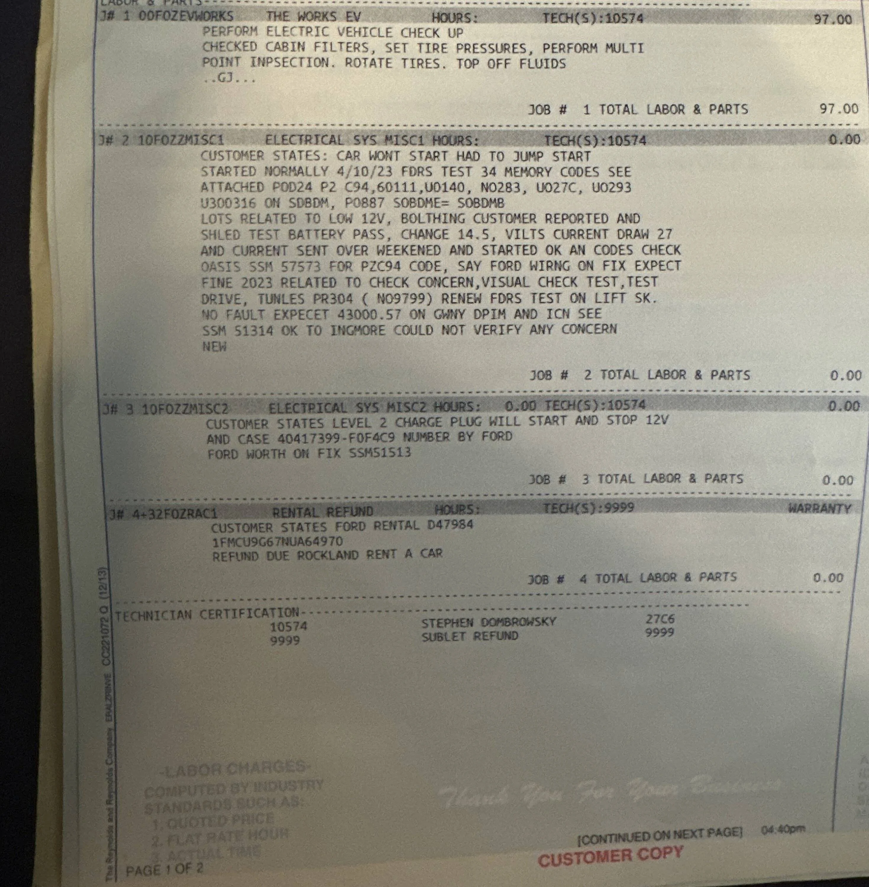

The results are in…
looks like I have to wait for Ford to provide a software fix for SSM 51513. Cars home again and working though.
Ford Mustang Mach-E Car is completely dead IMG_0354

The results are in…
That was a tough read.
Pretty sure you had a SOBDM update available last time I checked, too bad they didn’t apply that. What did your case manager say?
I asked them to update all modules yesterday, they claimed they did. Guessing they didn’t but trying to understand what exactly they did in those notes was rough. Case manager hasn’t responded to me yet. When I got home to charge the car the same behavior continued so it looks like I’m going to be living with it until they come up with a fix.
You said earlier that the car was working, but now also "the same behavior continued."
What behavior? Are you able to charge it?
