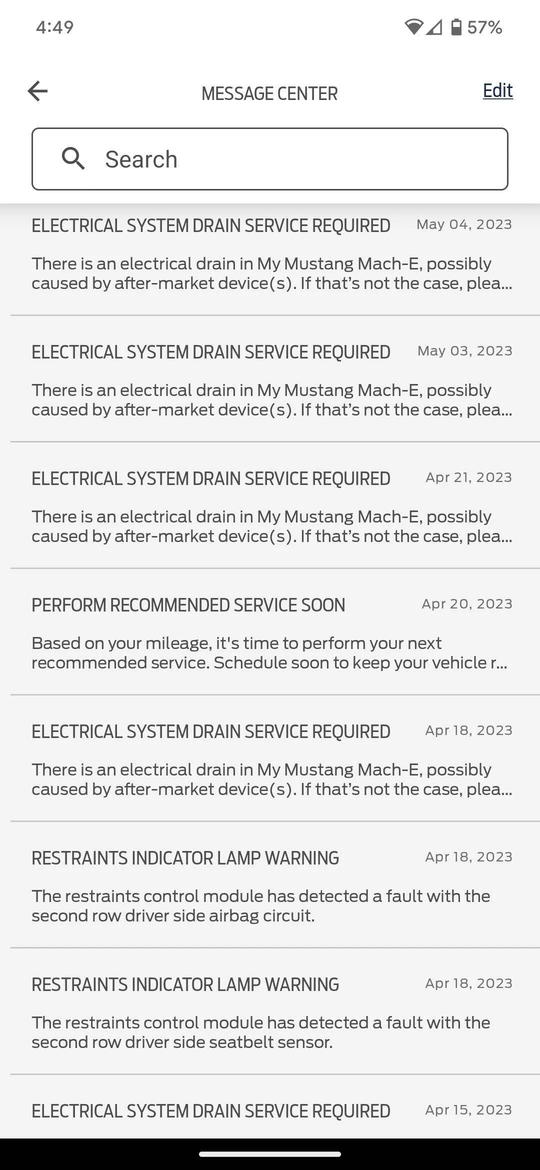

The low 12v battery notice is actually a good thing if you know why it's happening. It reaffirms that the car is doing it's job properly. Even in the notice it states that if you are expecting the drain it's okay, but if it's happening unexpectedly to schedule a service.
This case is different because there was no notice, which would indicate the car didn't do it's job. If I were to stop getting notified I would be worried... I get these notices all the time because of the devices I have running.
Ford Mustang Mach-E Completely DEAD!! Screenshot_20230509-164924
I had no idea why I was getting12v battery low as I don’t have any devices running

What LVB voltage triggers the message / top-off?
If I remember correctly it's 12.2v
I don't have any logs saved and my car is still at the dealership. I can confirm when I have it back and can pull the data.
