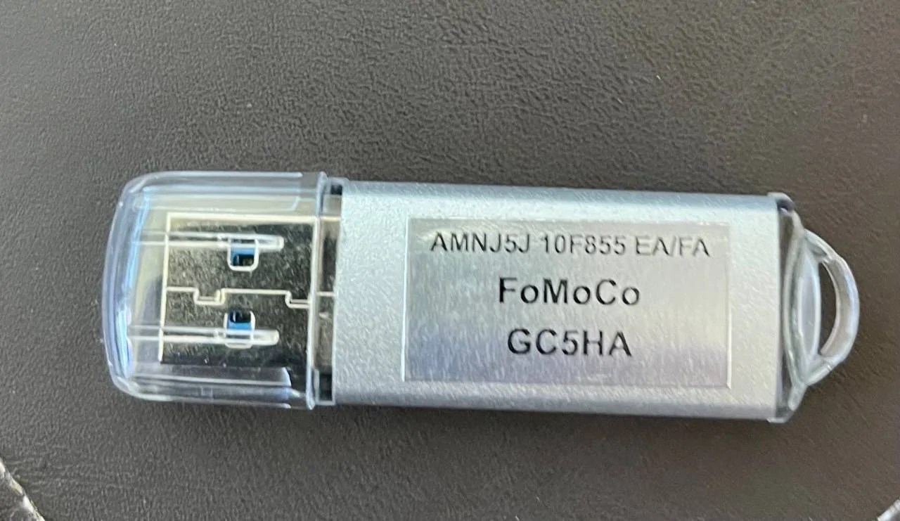

The difference? I present you with the map update for the Raptor:
Ford Mustang Mach-E Completely DEAD!! map updat
Either that or have it idle in wifi range for 90 minutes plus while it downloads and installs. :p
