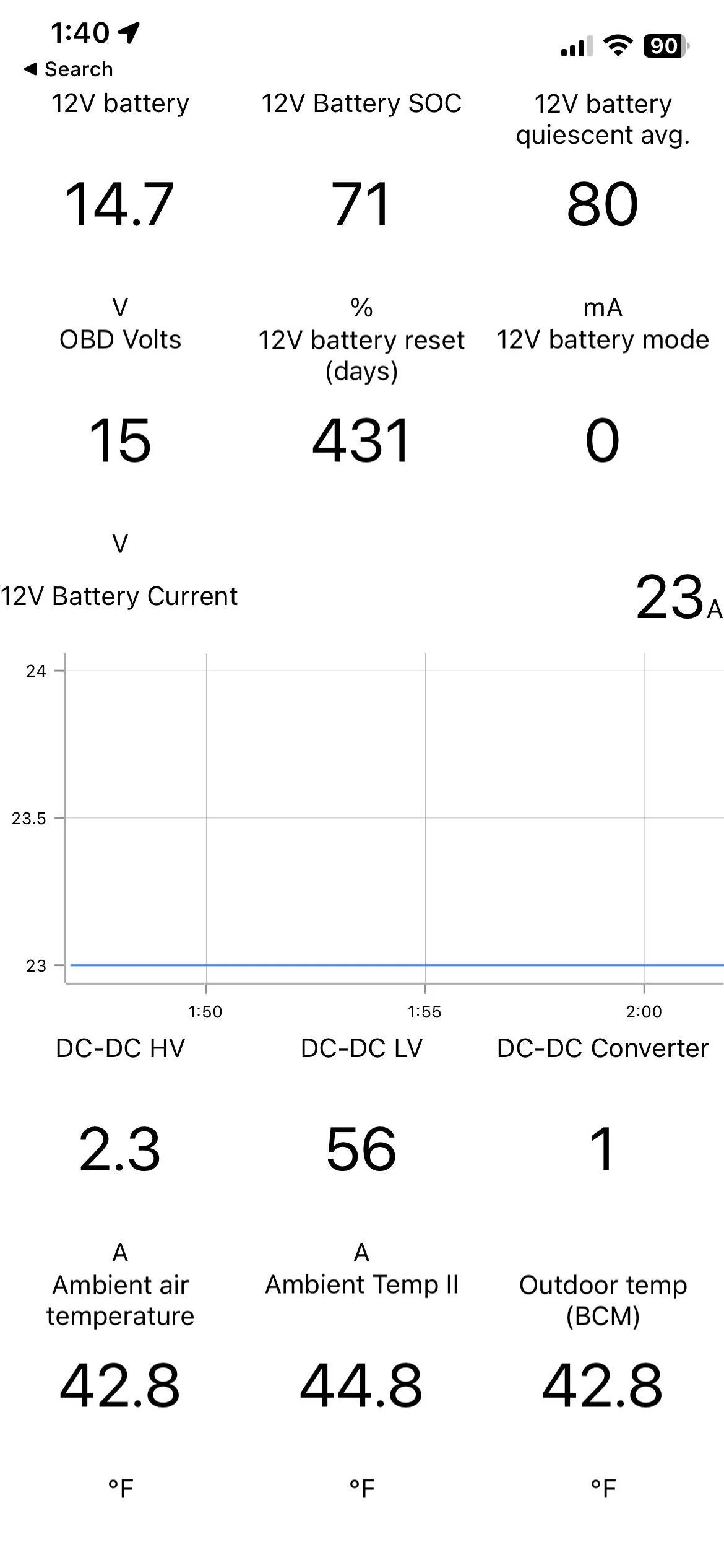

referring to your info image...
so this doesn't show any problems.....
LVB is sitting at 14.7 because your MME is 'on' - fine
calculated SOC of 71% and average of 80% - fine
it's when MME is 'off' that you have to keep an eye on. You can only do that with a voltmeter without waking up the car. get a voltmeter, stick it in the center console port, leave the armrest and console slider open so you can see the voltmeter from outside the car without opening the door..... check the 12v system voltage in the morning, it should never be less than 12.1
