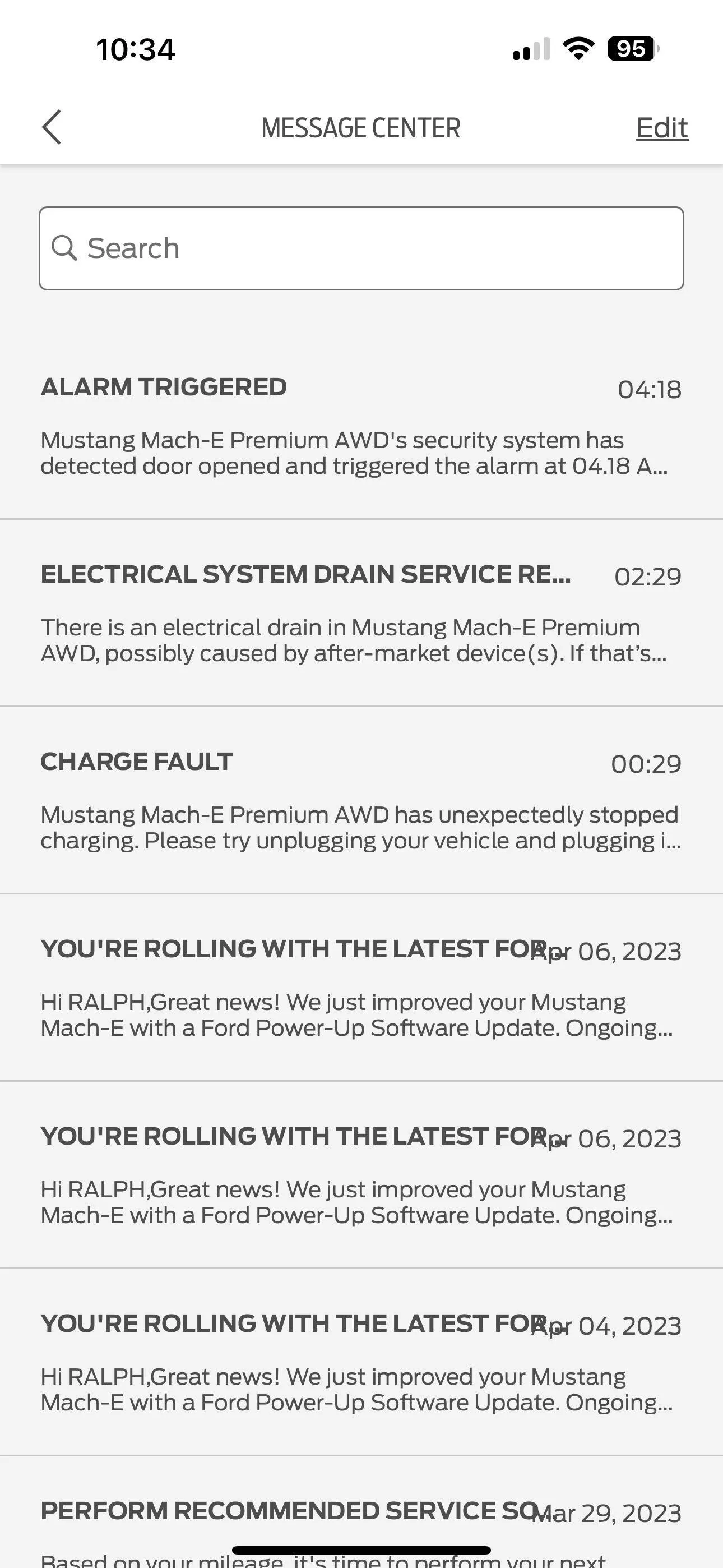

My car got a bunch of messages overnight while charging and now it is completely dead. I cannot unlock the doors and access the vehicle. It’s in my garage and the door was never opened. Also showing red ring when I open the charge door. Any ideas what’s going on here?

This was all handled the way described. Frunk was opened with a jump to the cables in the bumper and the battery was recharged. It showed 14v and the tech disengaged the charger. The car maintained the voltage and I let it run for 40 minutes before driving it to the dealership, which is where it is right now waiting for service. This does not appear to be HVBJB related and is a different issue. I have a job2 2022 and it has the newer HVBJB model part. Not saying that part is perfect but it’s more reliable. Also, the error received has cleared and was different than what others have shown as HVBJB issues. @MachLee diagnosis previously mentioned is on point and we’ll see what the next steps are next week.
