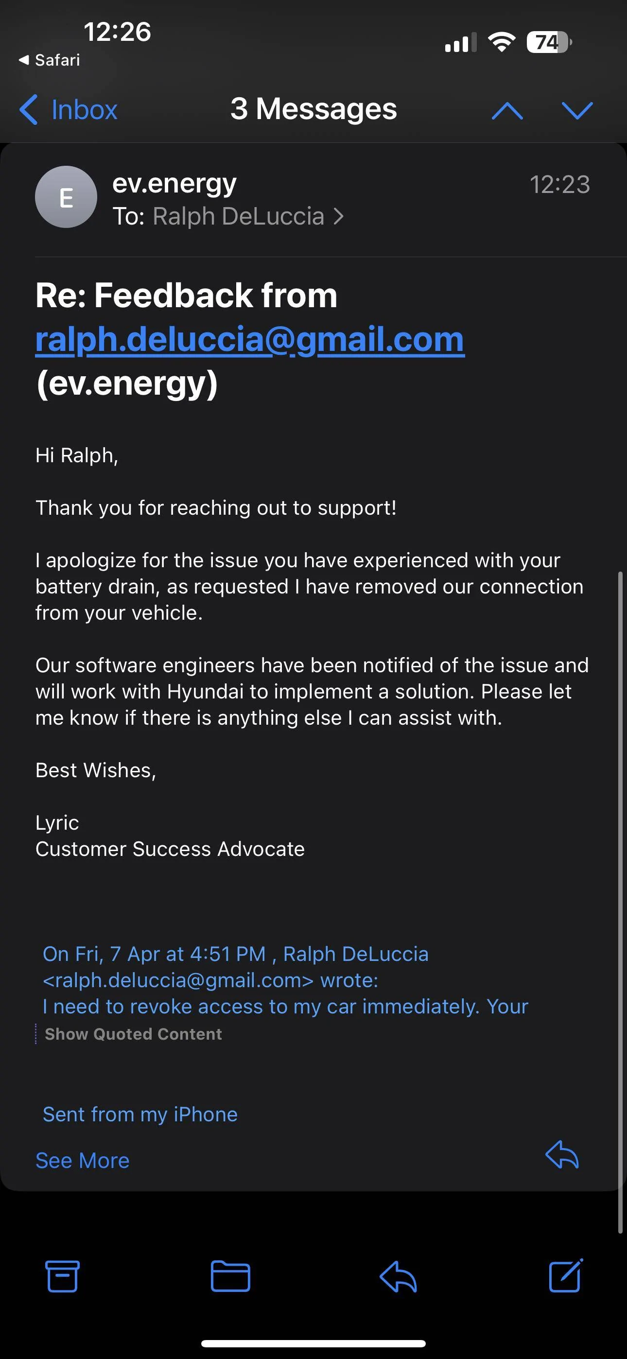

I sent them an email to revoke access as apparently there’s no way to do it in the app. The company is ev.energy
Same thing - they are using your credentials and the API to wake your car.

Yes. It was a new program in my area offered by the electric company. I guess I learned my lesson. Ford roadside wants $95 to come jump it. The car is less than a year old. Is that normal? Once they jump it will it charge at that point?
Your electric company is what killed your 12V. Change your FordPass login credentials as soon as possible so they don’t have access any more. ??

They unenrolled my car from the TOU service pretty quickly. They referred to it as a Hyundai which is interesting. Lol

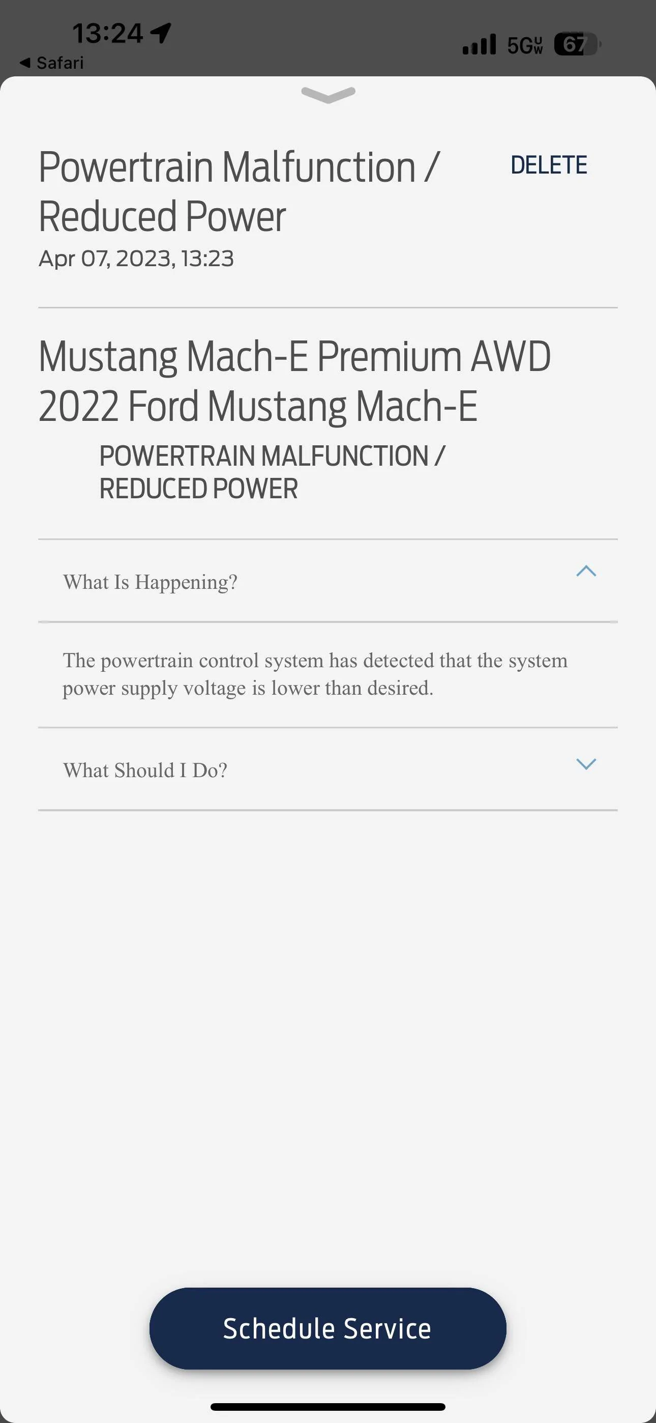

Cars on but it says service vehicle soon. Tech says it takes at least 30 min to charge and to leave the car on and it should clear. Side view mirrors also oddly wont open. I was able to drive the car and I’m letting it stay on. He tested the battery and said it was at 14 and appeared to be charging. I just got the error attached as well.

I know this will sound odd, but you probably need to disconnect the 12V battery for 5-10 minutes and then reconnect it to get all the modules to boot up properly. Removing all power to them get them to start from a clean state. (It shouldn't be like this, but sadly it is.) Once that's done, see if you continue to have problems. It is possible that the TOU app had nothing to do with the issues you're experiencing since I think that alone would unlikely cause the HV charge fault. If the car is still behaving oddly or throwing errors after the 12V battery disconnect/module restart, then you'll need to take it to the dealership. Good luck, I hope it goes well for you.
