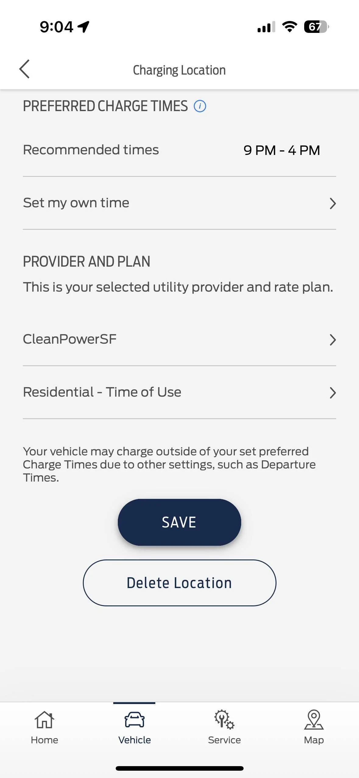

Regarding utility TOU rate plans and setting charge times, you all know that FP has support for utilities and will auto-set the appropriate charge times, right? No need to give your utility access to your car…
