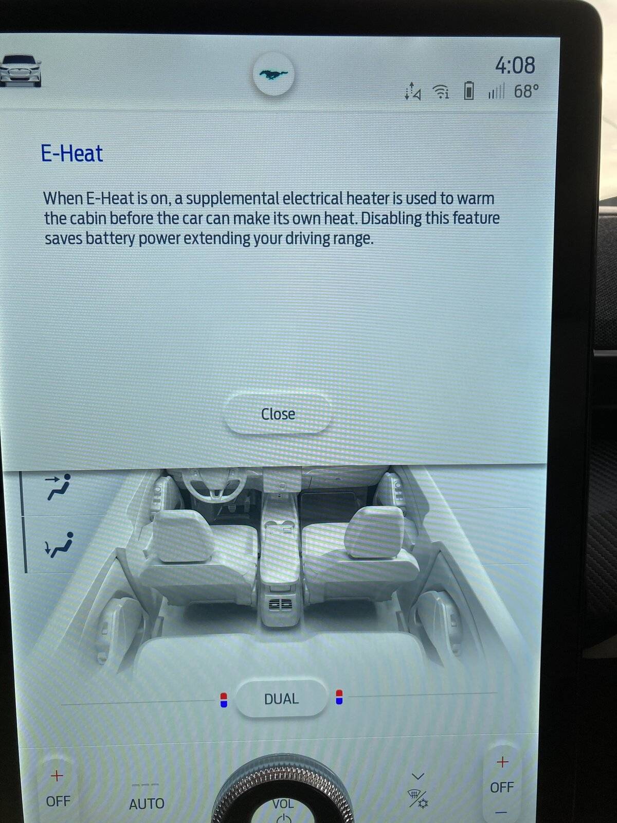

OP, have you tried preconditioning the vehicle before leaving home/the charger and then disabling the electric heater after you start driving? The Mach-E says it is able to heat the cabin from the heat it generates outside of using the e-heater, i.e. the resistive heater. Perhaps leave the e-heat on for a bit once you start driving to give a chance for the drivetrain to heat up before turning off the e-heat? I’m guessing this heat must come from somewhere in the drivetrain.
This is what I am referring to:
Ford Mustang Mach-E Diesel heater, thoughts. 97DBF70E-BC77-4DA2-8A1C-7D2DD85DF765
Frankly, the temperatures you are experiencing may be far too cold for this to work. I’ve never tried it because I haven’t really had any chance to mess around it with it yet, it hasn’t been cold enough.
But I haven’t seen anyone talk about this feature on the forum, whether it works, whether it’s ineffective, etc. As someone said though, it’s easier to maintain heat than bring the cabin up to heat, so this method of heating may work if the resistive heater is used (ideally with preconditioning) to first get the temperature up before disabling it and then using this non-resistive heater to maintain the temperature.
That message is misleading, they need to edit it because whoever wrote it didn't fully understand the Mach-E's thermal system. This has been covered in several other topics about heat, but the only source of cabin heat besides the resistive HV heater is the battery waste heat. However with lithium batteries there is almost no waste heat during operation, so that means the E-heat is the only way to effectively heat the cabin. The motor waste heat cannot be transferred to the cabin because they use a completely separate cooling loop. Therefore if you want cabin heat you must turn E-heat on, or you will be cold.
Message should read:
"When E-Heat is on, an electrical heater is used to warm the cabin. Disabling this feature will turn off cabin heating, saving battery power and extending your driving range."
I strongly recommend you precondition the cabin in the winter, and leave the climate control in automatic operation for the most comfort and efficiency. Once the cabin is warmed up, the heat is not as significant of a draw as you think (maybe only a kW or two), so only 10-20% of your battery unless you are driving slow.
