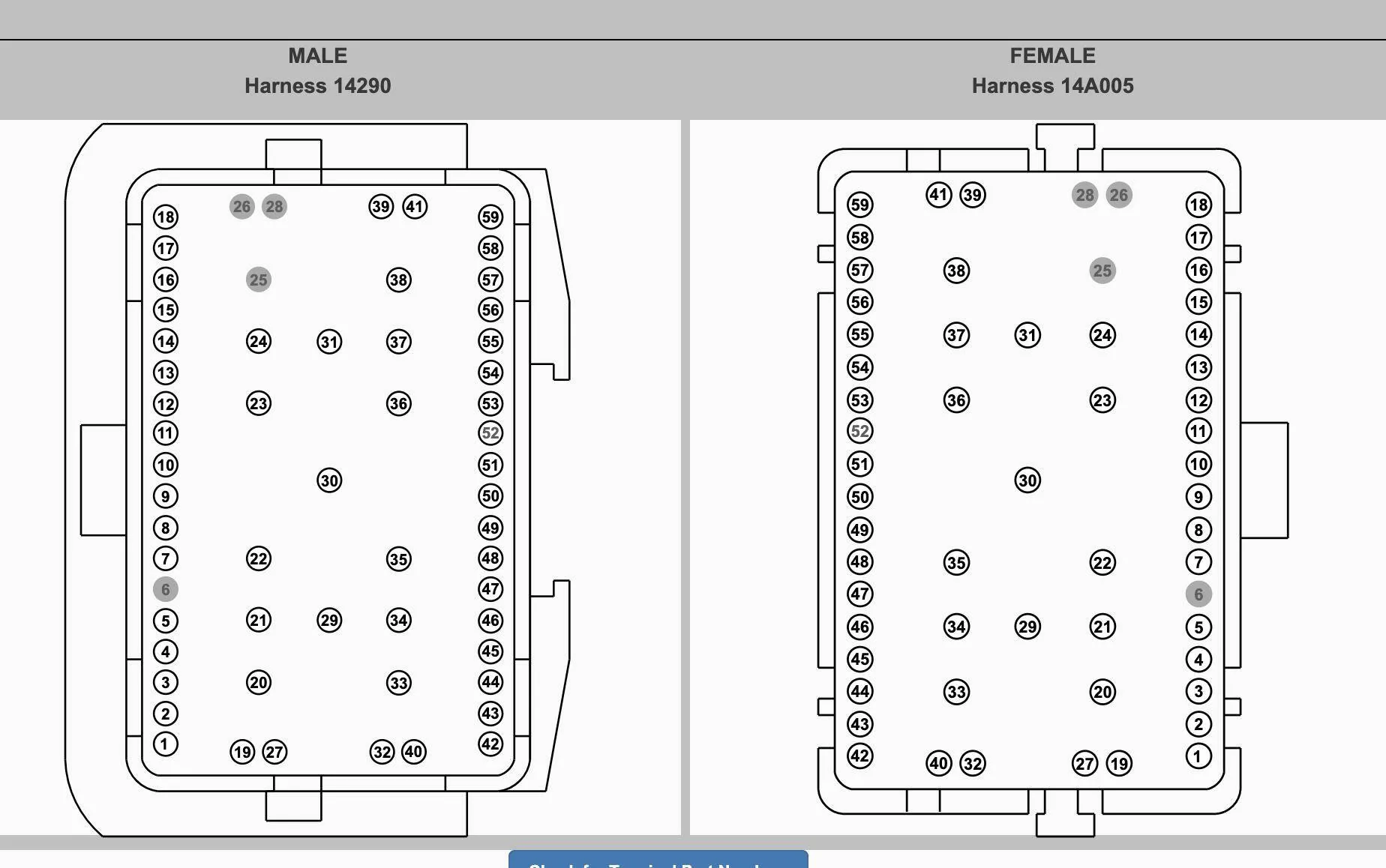

C275 is a giant inline connector. You're probably not going to want to cut wires to put a resistor in the loop there. It is under the dash left side.
I see now that pins 55 & 56 are listed on the schematic. Glossed over that the first time I looked at it. How about C145? The circuit is on pins 2 & 3 of that one. ? ;)
Also another giant connector in the 'engine bay'. 52 pins.
