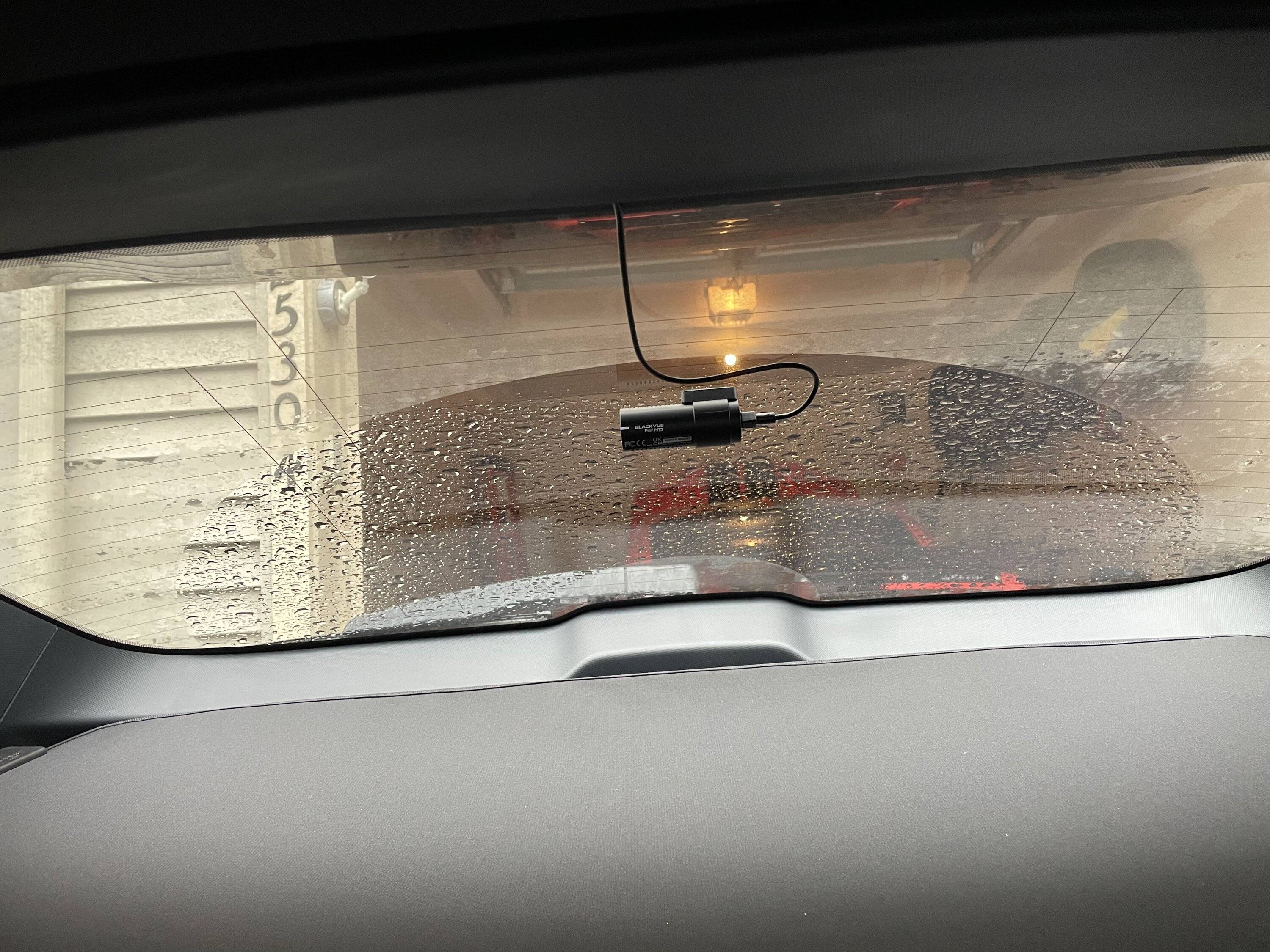

Just one suggestion (non-critical) for the rear camera.
The mach-e rear wiper blade is short. So if your rear window is dirty, only the area covered by the wiper will be somewhat clear. If the camera is "above" that clear area line of sight, your rear camera videos will be poor - recording dirt instead of whats going on behind you.
My suggestion is to place the rear camera lower, within the "wiper clean area".
Within the area cleaned by the rear window wiper that is.
This way if you want to make sure the rear camera has a clear view, just activate the rear wiper cleaning spray.

“This isn’t the way” ? For me it isn’t so simple as you described ?
1. First of all here’s my car and thanks for CA weather https://www.macheforum.com/site/thr...on-how-the-mach-e-gt-dream-became-true.24194/

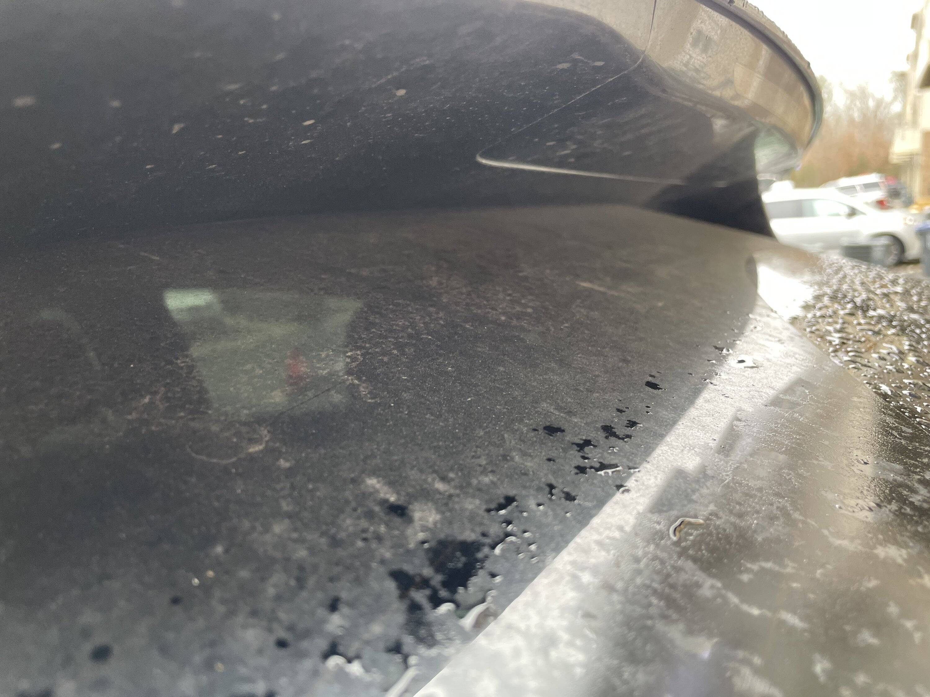

2. Actually under the roof spoiler the area is cleaner then rest of the window.
3. More important to see traffic in rear mirror instead of nicely placed rear camera.

Hasn’t been clean under the spoiler for me ever. It actually accumulates dirt and humidity here in VA. Lucky you!
My rear camera is not big enough to block my view. ??

Agree, with time it’s accumulates dirt up there, but regular wash resolves the problem. By the way under the rain that area is free of water and clear. As a result no need for wipers and makes this place ideal for rear camera.
