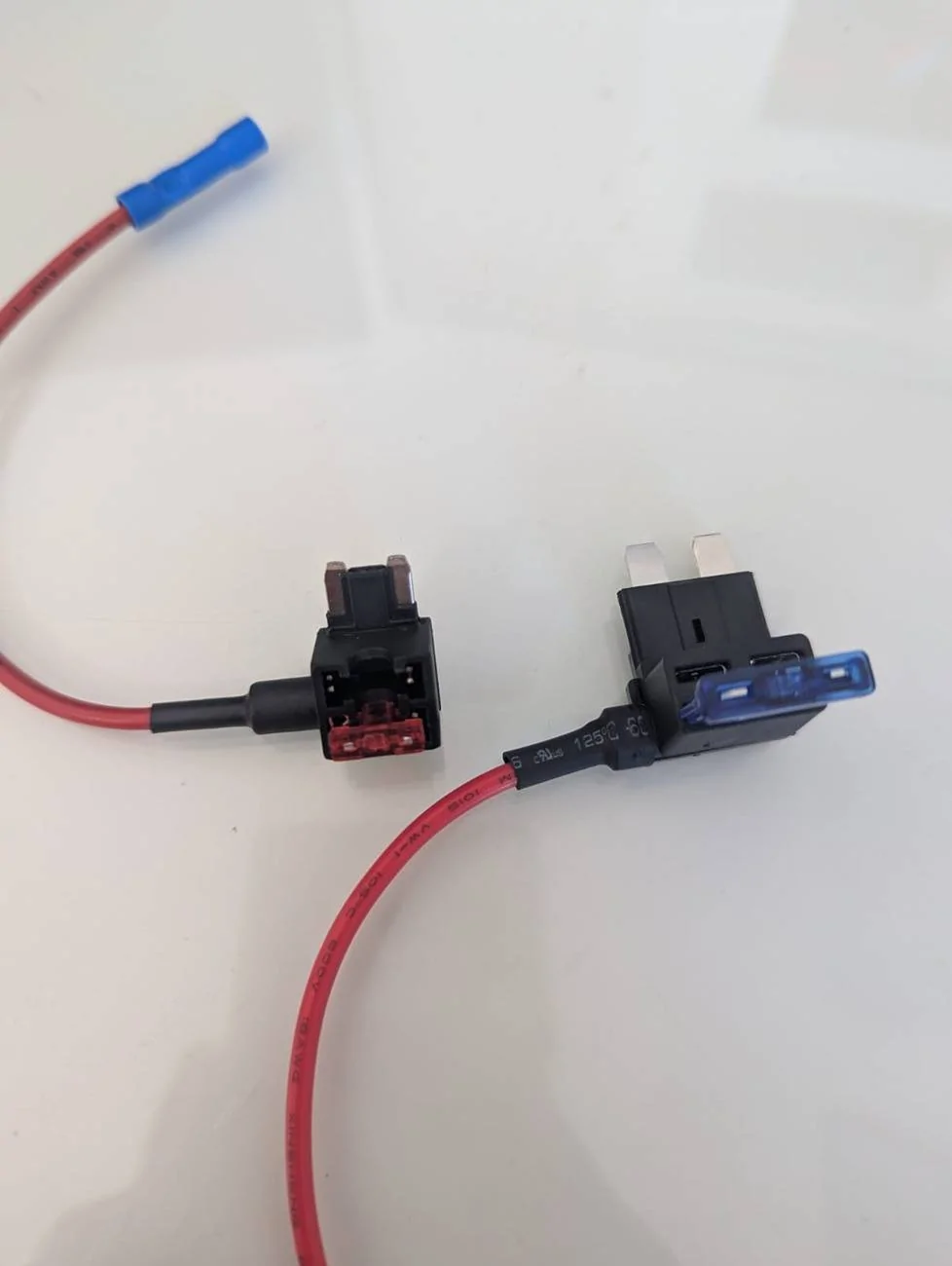

Orb7
Dec 17, 2024
46
IL
MachE Select
Hello,
I found the following fuse taps: a smaller one with a 10-amp fuse and a larger one with a 15-amp fuse.
From what I’m reading, the larger one won't fit the Mach-E, and I should be looking for a Micro3 fuse tap — is that correct?
Also, should I insist on using a 2.5A fuse, or is 10A/15A acceptable as well?
Thanks

Hello,
Thanks
The fuse taps you need are called Micro-2 and Micro-3 taps. If you leave the fuses for the camera in line, you can have a 50A fuse in the fuse tap and it won’t matter, as the smaller fuses will blow to prevent harm to the car in the event of a short or an over-draw. My fuse taps have 20A fuses in them and the fuses included in the wiring for my dash cam are still intact. ??

Hello,
Thanks
As the previous poster commented, you need micro 2 and micro 3. I differ from them in the fuses I use.
I always put a smaller fuse to my dashcam etc than the fuse for the car equipment. My feeling is that I want my aftermarket device to "pop" their fuse before ever risking the circuit for important car functions.

Thanks! Just to confirm — when you said the camera wiring has small fuses, you meant the inline fuses that are built into the hardwire kit near the power wires, right?

My camera does NOT have an inline fuse. That is why I use the fuse-taps. They provide a separate fuse for your aftermarket product
My camera's hard wire kit came with fuses inline with the switched and always-on power leads. This photo doesn't seem to include inline fuses. In this case, you should obtain fuses for your fuse taps that are of the correct rating for those two circuits. ??
