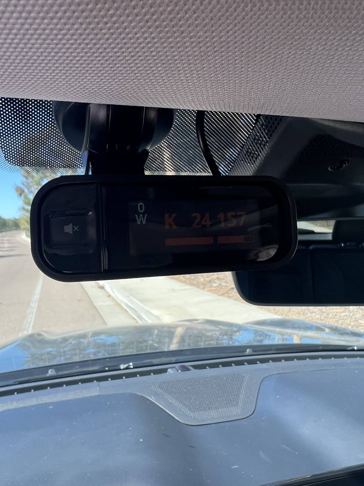

Testing with a speed-sign approx 200m away, direct line of site.
There is another speed-sign on my Monday route. I’ll pull over and take a separate measurement. Been seeing Ka consistently by CHP lately, not sure I want to pull over for that photo-op.
OK that's pretty close, what about at 3+ km range? Put it in another vehicle with a regular windshield and compare detection range.

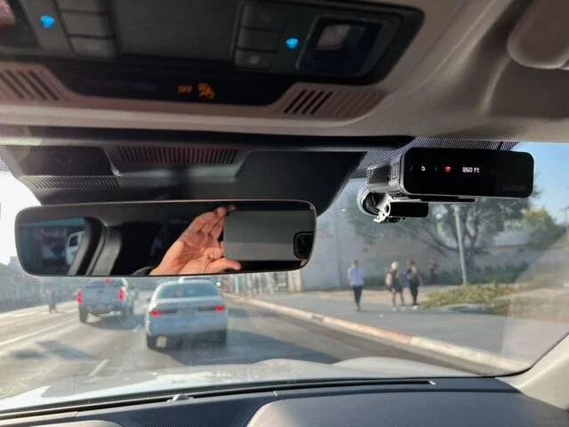

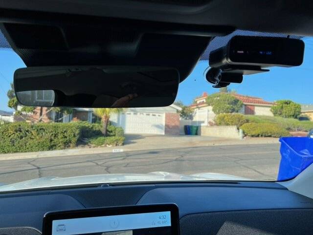

For those who can't find a good mount solution. I found this on Amazon. You could mount the suction below (which is rare) and put the detector on top with 2 sided tape.
https://www.amazon.com/gp/product/B000FGI9R0/ref=ppx_yo_dt_b_asin_title_o04_s00?ie=UTF8&psc=1
Thanks for the link. While I'm not a fan of suction cups, this seems like the best solution for my R7. I know that I'll eventually go with a grill mount, but for now this is an acceptable solution and it works, which at this point is the most important thing.

Very nice. I bought this one too but can't get the right angle for my Escort. I'm going to try to flip the mount over.

Thanks for everyone's research on this. I also have an R7 and wanted to follow up to see how this solution has worked since your install last year. Has it stayed-put? Does it seem to be provide adequate warning to radar?

It works, but I don't have as much faith in the range as I used to have. I have noticed that the detector has started to sag a little bit as well and need to velcro the top to the headliner to straighten it as much as possible. The other concern is the rear facing detector. Since it's directly in front of the passenger seat now, detection could be blocked by the passenger. So far so good though. Plenty of alerts to tell me it's working and no surprises from police.

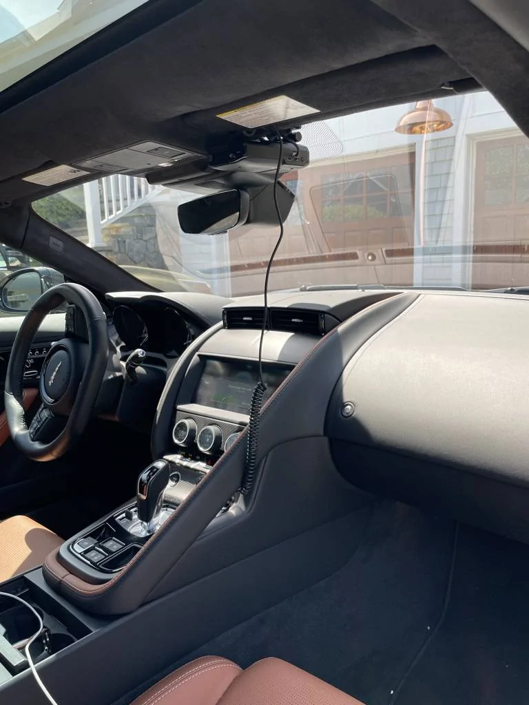

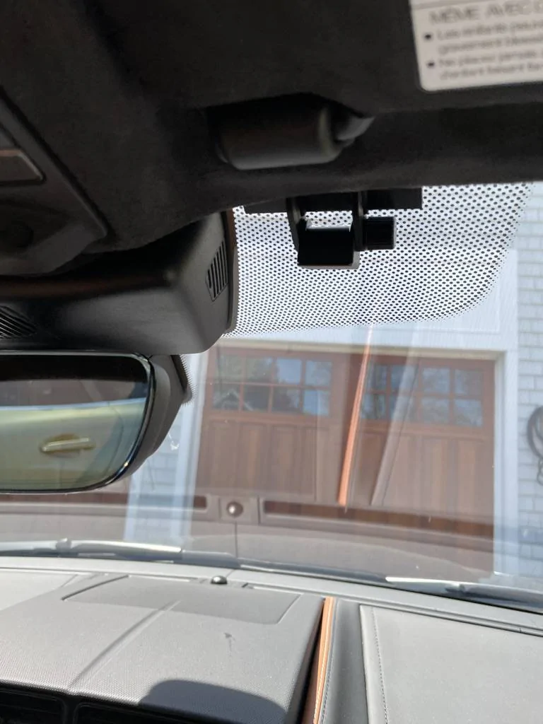

Blend mount WILL NOT work. Your window will block the signals because it's an IRR windshield. While the mount will mount the detector just fine, the detector will be rendered useless.
I actually designed a mount just for this with an explanation. See this post:
https://www.macheforum.com/site/thr...rt-radar-mag-mount-specific.10559/post-401173
In that same thread above, on page one, I also provide a mod that you can use if you would rather modify your suction cup mount.
Here's some pictures from one member here @FarSide using the mount I designed on an F-Type:
