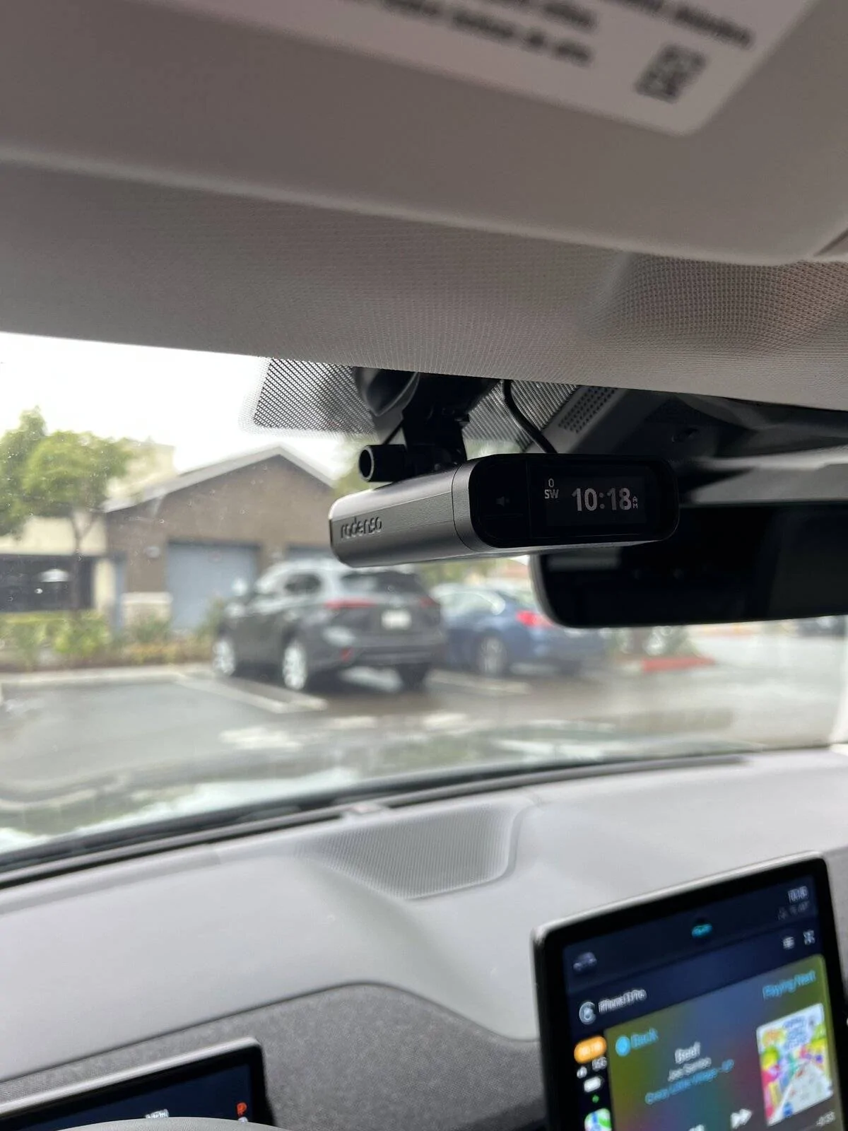

Radenso DS1
I have not had any issues with GPS or radar/laser detection in its current position.

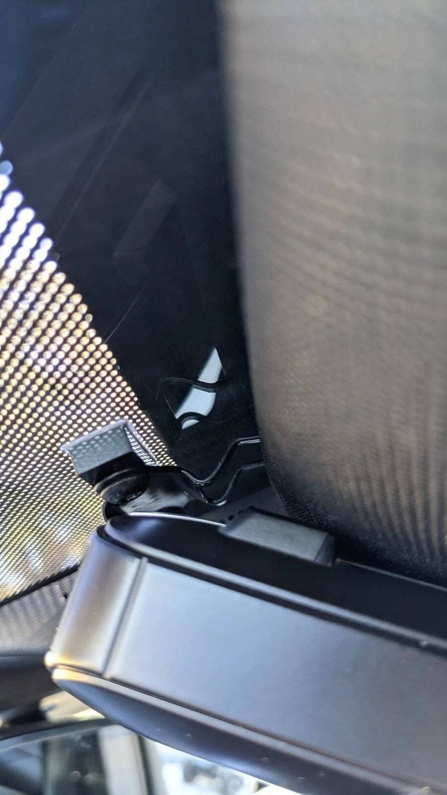

I ended up cutting up a mount using some vhb tape and it appears to be holding well and very minimalistic. I'll see if I get good radar signals next time I have a cop coming at me.

Testing with a speed-sign approx 200m away, direct line of site.
Ford Mustang Mach-E Radar Detector Mounting - trying to come up with a solution. 9F1F4B67-6A7E-4851-8A69-058D6FA410EA
There is another speed-sign on my Monday route. I’ll pull over and take a separate measurement. Been seeing Ka consistently by CHP lately, not sure I want to pull over for that photo-op.

The mount "creation" that I did in my previous post is holding strong. I can't believe how well that tape sticks... I also bent up the radar "anti-bounce" tab and put it under the headliner. It appears to be getting good signals just like before. I think rear radar is a little worse with it mounted up top, but I would rather oncoming over rear.
Now the hard part is that I mounted it using an old radar detector. The newer one, a Redline 360c is magnetic and I need to find a way to chop up the factory mount to get it up there. I think that's Monday/Tuesday's project so I'll take some pictures once I come up with something.
