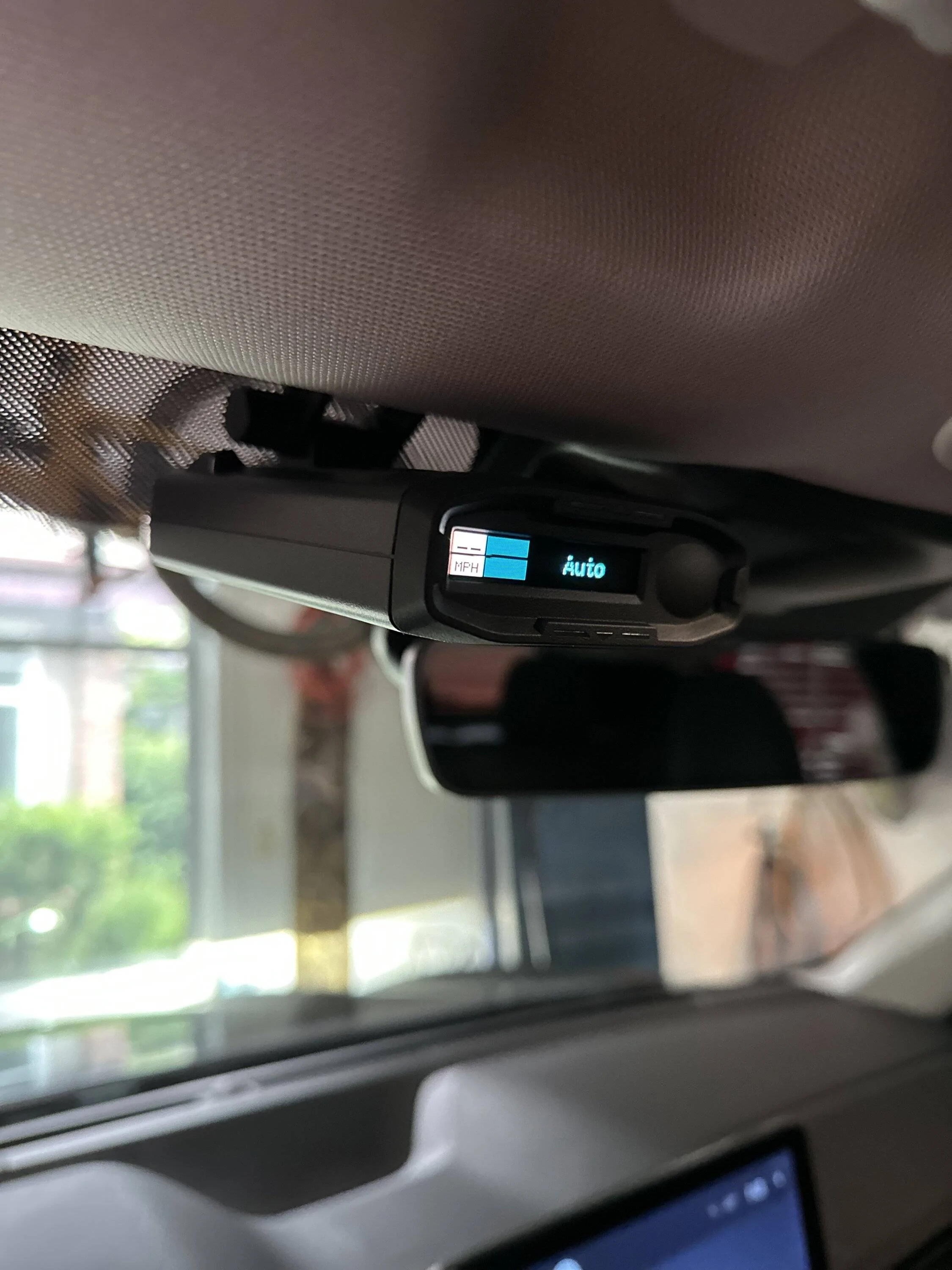

Thank you for this great thread.
Does anyone know if the 2022 models have IR blocking issues due to metallic tints or athermic glass? I know that there is different glass being used in the car now due to supply change problems and perhaps the post windshield recall have changed things? I would like to avoid mounting the RD up by the dotted cut-outs.?
I know that some post recall vehicles have the IRR glass, as my vehicle is post recall. I don't know if all trims in 2022 have it or not, but it's really easy to check. Just look at the driver's side windshield, lower corner. If you see IRR, then you have it.

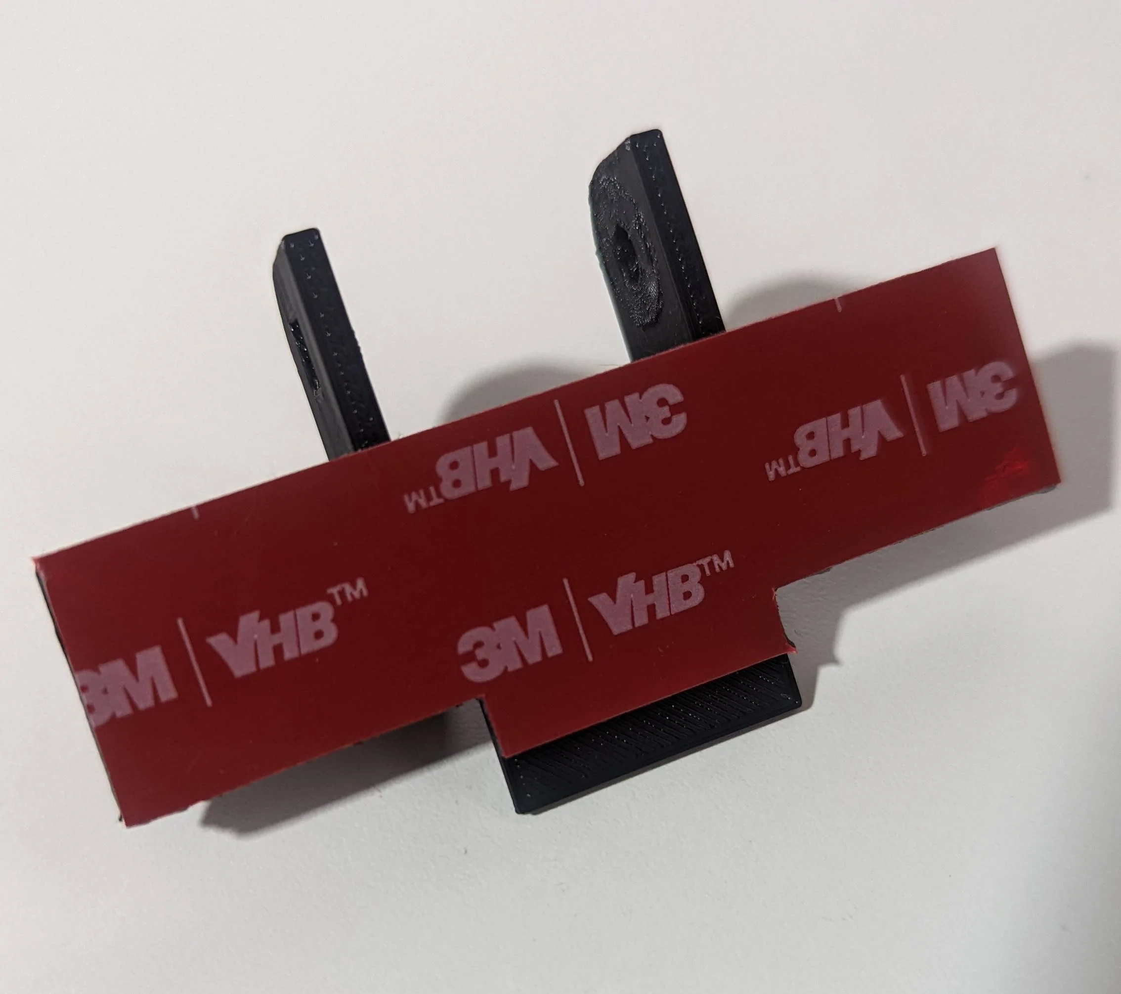

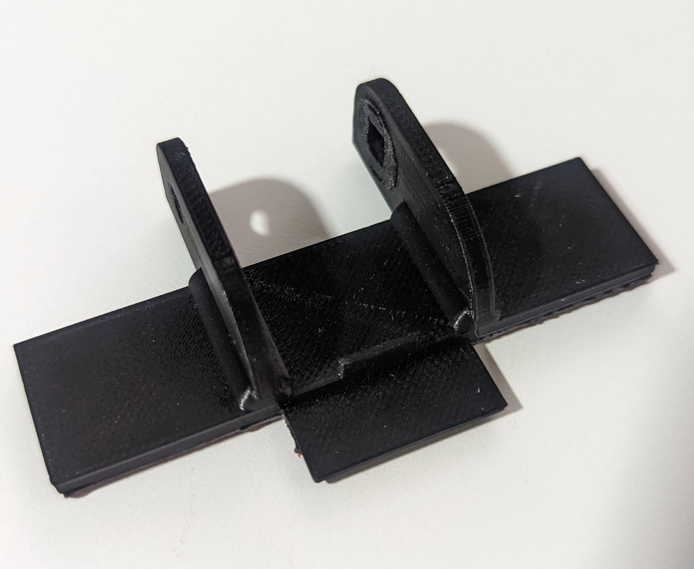

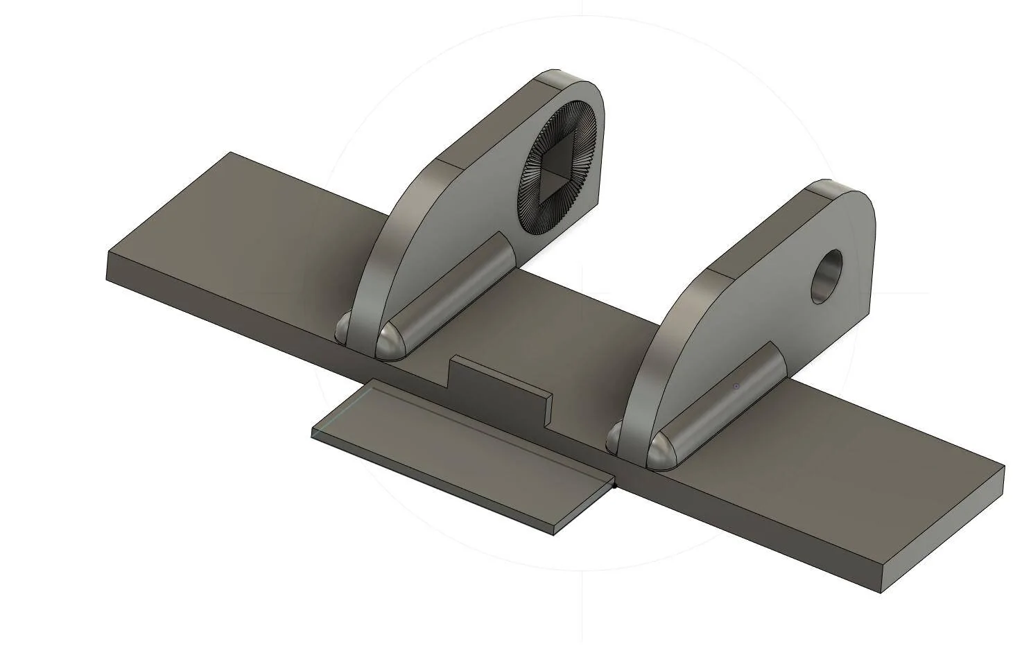

Because this post has got a little attention and there's always a better way to do things. I designed and printed a custom mount. It is the exact width of the detector and provides a much larger surface area for the VHB tape, which means better adhesion. It can also be for those who don't have the tools or the desire to modify the stock mount. Includes the square hole on one side and the teeth (as best as I can get them) for gripping the detector while positioning.
To make it even better I have printed a tab that slips under the headliner and another tab that helps align it to the headliner. This makes for easy positioning. I have printed it in Polycarbonate as it's one of the strongest materials available. I also attempted with Carbon Fiber, ABS and Nylon and each had downsides.
If anyone is interested I would sell it for $25 (shipping included). I can't give these away since I'm printing with more costly materials on a commercial machine that will deliver the extreme heat (200°F Bed / 500°F Nozzle) needed.
When contacting me specify if you want the nut on the right (same as OEM) or left side. I think the left side has easier access when the detector is on the drivers side of the mirror. Also it's just the mount, no magnet included. Does come with tape already pre-applied.
Ford Mustang Mach-E DIY - Mounting Escort Radar - Mag Mount Specific 1650683046033
Actual mount in heat and chemical resistant Polycarbonate.

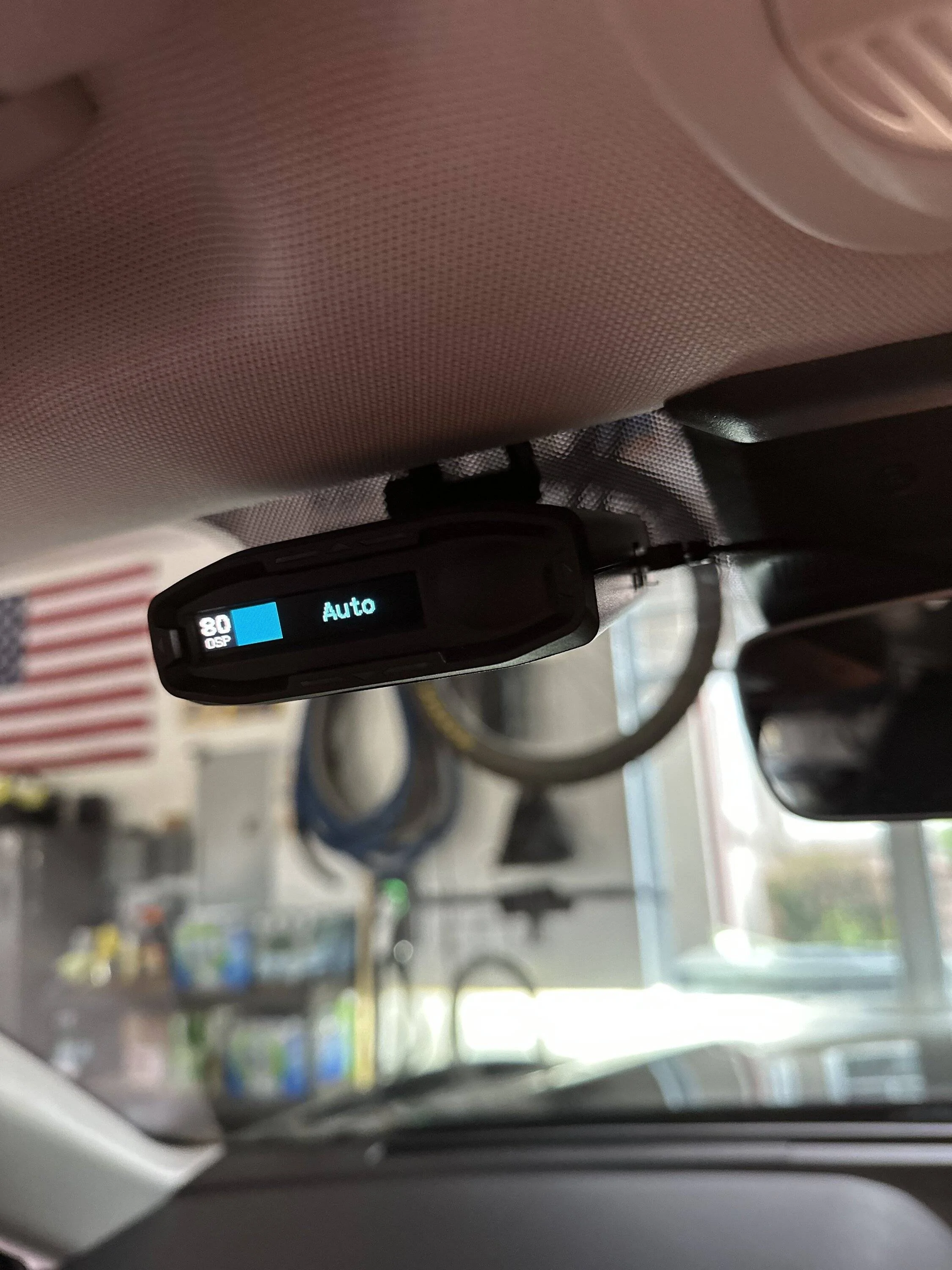

I received my mount in the mail yesterday and had to post that the shipping speed, build quality, instructions, fit and finish are all 10/10. Well worth the $25 to have a great mounting solution to an otherwise fairly limiting situation. Thanks again DSO

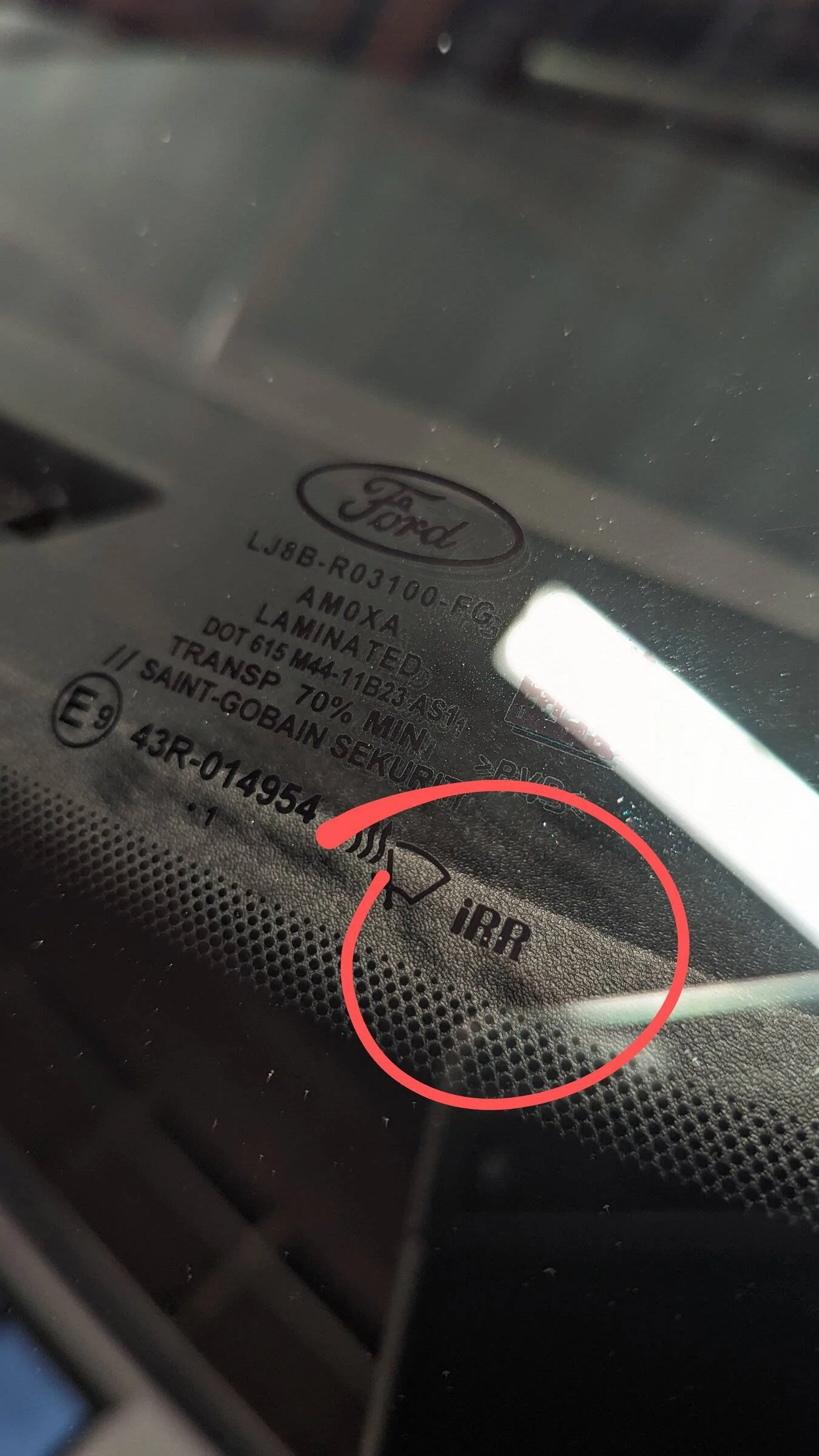

What terrific info and guidance! The things I've learned on this forum go SO BEYOND THE MANUAL and generally known information. A question: by mounting the radar detector behind the black mesh area, does that effect the readibility of the detector? Also, ironically, I ordered and new detector because my older one (Escort/passport) was going absolutely NUTS with, what I can only assume, were false detections (almost exclusively LASER) since these never happened with my previous vehicle and currently does not occur with my wife's car. So the new one that I got goes EVEN MORE BONKERS than the old!! Is this the main issue with the IRR windshield, specifically LASER readings?
The black area on either side of the windshield sensor housing and rear view mirror is not coated with IRR and does not diminish the capabilities of the detector. Anywhere else on the windshield will. Lidar (Laser) uses IR which will be blocked by IRR.

thanks and I read that thread but, if the IRR blocks Laser/lidar readings, why does mine go off almost contiunally? I would think that I would get NO laser readings? Perhaps I am misreading the post(s)?
The most common thing I've seen is caused by IR reflection from cell phones. In the MME this could also be caused by the driver attentiveness monitor above the steering column. Normally, if you have an IRR windshield and you're getting continual laser alerts something inside the car is emitting IR and it's bouncing around.
