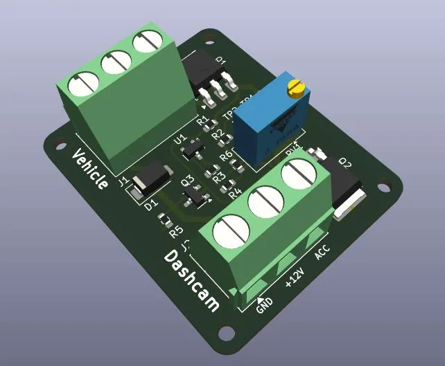

This seems to be one of the dashcam threads which gets lot of references, so I thought I'd add one more post about my experience. I bought a dashcam based on a kickstarter campaign (big mistake, but we move on) and purchased a 70mui A810 to replace it. However, the UP03 hardwire kit had a cut-off at 11.8V, which is useless for our cars. I looked for some options to circumvent this and, since I have nothing better to do with my time now, thought I'd look into a solution using an Arduino.
Long story short: i build a small board which monitors the 12V battery voltage level and will cut off the dashcam once the voltage drops below a user-selectable voltage. Right now it's a hand-soldered Frankenstein perfboard, but it's worked great in testing and I'll be installing it soon. That got me wondering if there'd be anyone interested in using it in their vehicles. Since this a hobby/pasttime as opposed to a capitalist venture, I'd be asking for anyone who wanted to purchase one assembled to just cover my costs for materials and shipping (it looks like materials would be about $21 USD, including having a PCB manufactured for it).
If you'd be interested, send me a DM. If there's enough responses, and/or if this kind of post should really be put under some other forums since it's for "selling" something, I'll pursue that. Right now, I'm just curious whether there's any interest.

Here is a KiCad screen capture of the PCB, which would be attached to a Chinese Arduino Nano clone board. It's mainly just to show it's not vaporware. I can also attach a copy of the prototype, but it's really not as attractive.
Interesting, curious why you just didn’t go with an analog circuit? You could probably whip up something with a MOSFET and a comparator as a cutoff, and use a potentiometer to adjust the voltage cutoff. I guess I’m old school.
I recommend setting the voltage cut off to 12.2 V or higher.
I recommend sending the voltage cut off to 12.2 V or higher.
Good point, but I'm much more computer than electrical so that's my go-to. Plus, shiny Arduino! But I'll have to look at that more closely to see if it would work in my situation.

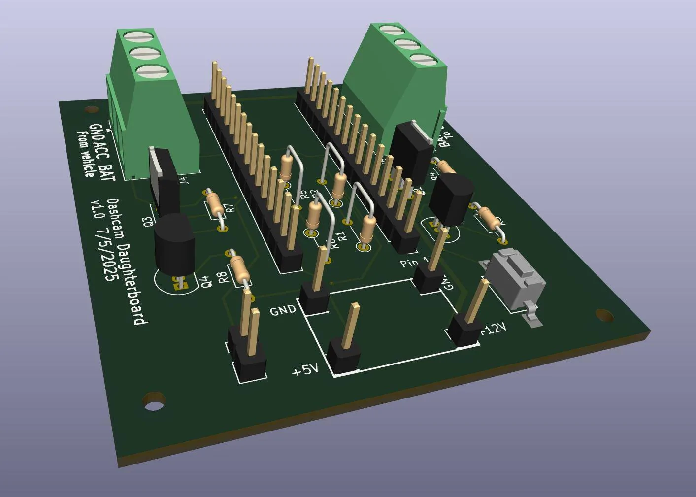

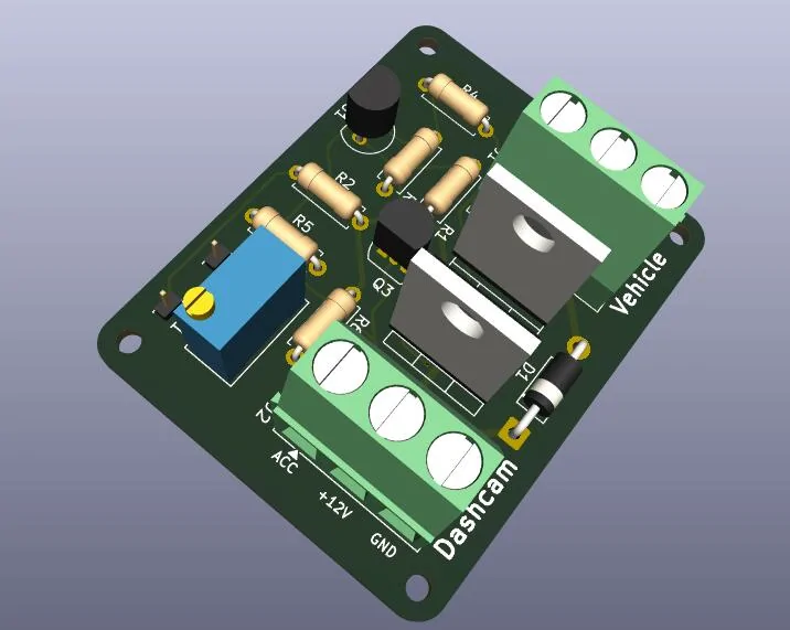

I searched around and found some parts (P-channel MOSFET and voltage reference/comparator) that simulations indicate would do the job, and so I just ordered from mouser.com. Assuming it really works, the total cost would be a little under over $9 a board in quantities of 10 (including the circuit board).

If anyone is interested in the KiCad files just send me a DM.
Edit: I forgot to mention that this design included a multi-turn trim pot and two test points to fine-tune the resistance so that the cut-off voltage can be adjusted, but you can also just install a resistor instead to have a fixed cut-off (and save about $1.50)
Edit again: updated images and price based on modifications suggested by @Mach-Lee. I proto-boarded it and installed in my car yesterday, so we'll see how it goes.

Just a suggestion, make sure to include reverse polarity protection (such as a SS14 Schottky on the input) if you will be selling them.

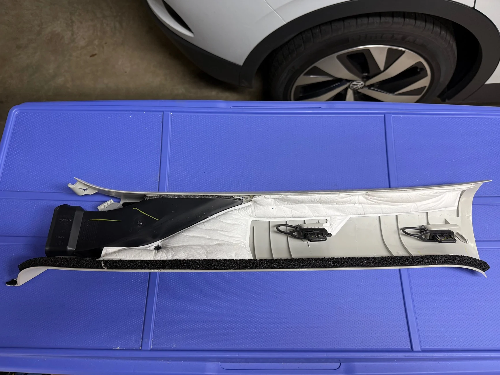

I've taken the passenger side A-pillar off twice in the past and know it's tough to reinstall, but yesterday I spent at least forty-five minutes wrangling it. It refused to pop into place (and I did remove the black pieces and push onto the clips, so it wasn't that). I seem to remember the trick was getting the end by the windshield inserted correctly before trying to reattach, but nothing seemed to work. I did finally get it to snap in, but there's still an 1/8" to 1/4" gap between the top and the headliner. Any wisdom? I re-read this whole thread but didn't see an AHA post.
Follow-up: after ignoring the gap for two months, I decided to remove the A-pillar cover to see what was wrong. I was also motivated because a rattle had appeared in the same area. The problem was I somehow bent the guide pin at the top (the one that goes thru the alignment hole) and it was wedged between the cover and the bracket. Once I straightened it out and was a little more careful, I was able to get it installed flush.

Here's a great how-to guide:
For the A pillar, remove the two black clips from the A pillar, then insert them into the A pillar cover like so:
Ford Mustang Mach-E DIY Tutorial for Hardwiring a Dashcam and Radar Detector IMG_3035
Then put the A pillar cover back into the A pillar, and push the two clips back in.
