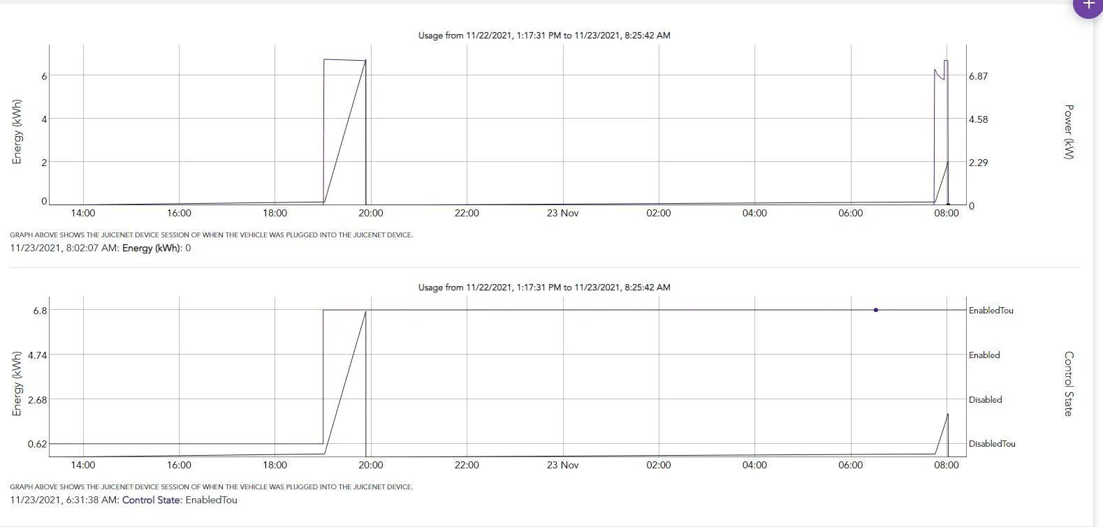

Can't speak to ChargePoint, but my JuiceBox graph will show the power pulled over the entire time it's plugged in. I've posted it before.
I preconditioned back in November. Here's my JuiceBox graphs. I just found out I'm leaving in 18 minutes to go somewhere, so I set a departure time. Vehicle immediately activated, and said it was "cabin preconditioning in progress". It's 22 outside, 36 in garage, and car hasn't been driven in days. The far right of the top graph shows the preconditioning, I suspect it wasn't cold that day, and all it did was prep cabin.

I found this thread an interesting read. I do not have my Mach yet so am gathering as much info as possible before it arrives. It is obvious to me that preconditioning did not take place in the OP initial graph. From what I have read batteries will not pre condition in a 50F garage. My understanding is preconditioning will commence one hourish prior to set departure time if you are plugged in. Cabin conditioning commences 15 min prior to departure. My Mach will be in a heated garage and I have come to understand that I will not need to precondition. From what I have read in this thread it does not answer the question as to whether preconditioning is really matters. I believe it would take a comparison of a Mach parked outside in say sub 30 degrees temps with and then without preconditioning. It does however confirm to me that I will not need to precondition when parked in my garage!
