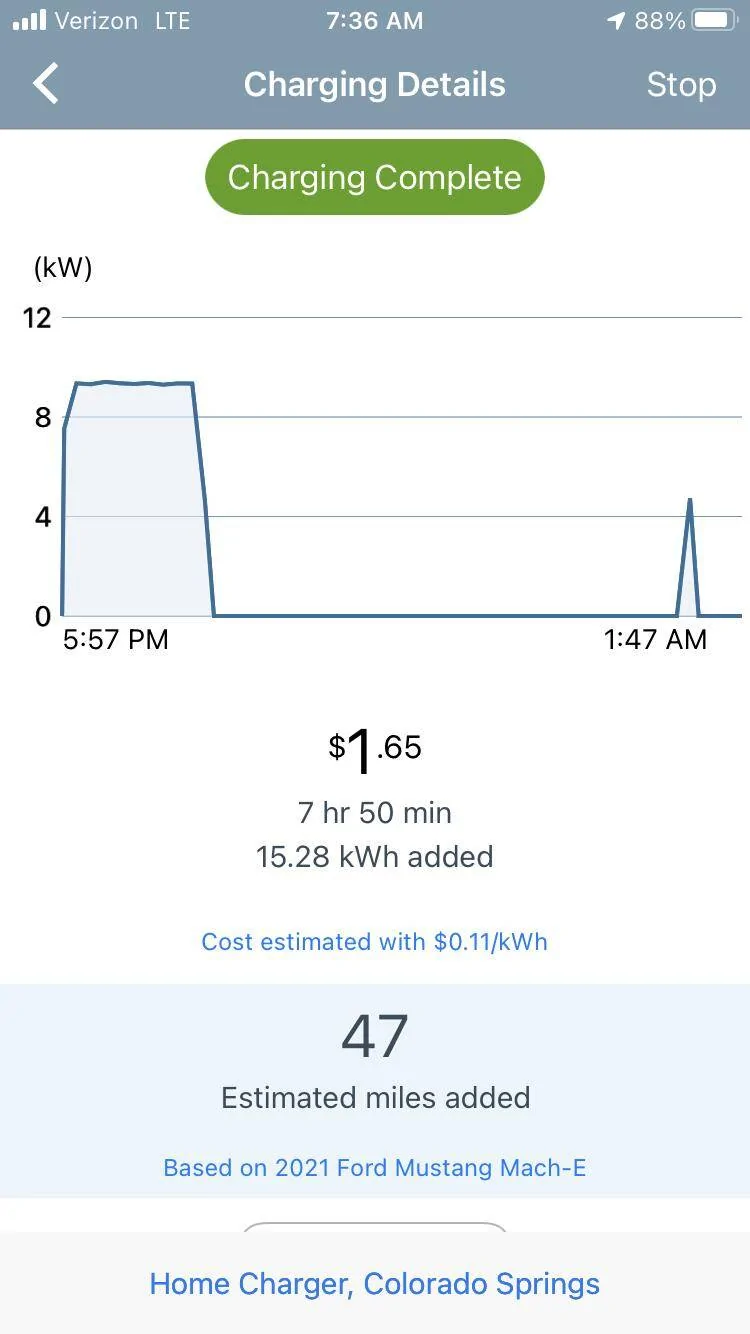

This morning it was zero degrees at my house and the garage was 47. When I came out at 5:30, my car was clearly pulling juice and I swear it sounded like a pump was moving liquid. I was hoping to see this captured in my ChargePoint log, but only saw a blip at 1:47am and zero PC blip this morning.

Can't speak to ChargePoint, but my JuiceBox graph will show the power pulled over the entire time it's plugged in. I've posted it before.
Same. I don’t understand why it went dark at 2:30 this morning…
