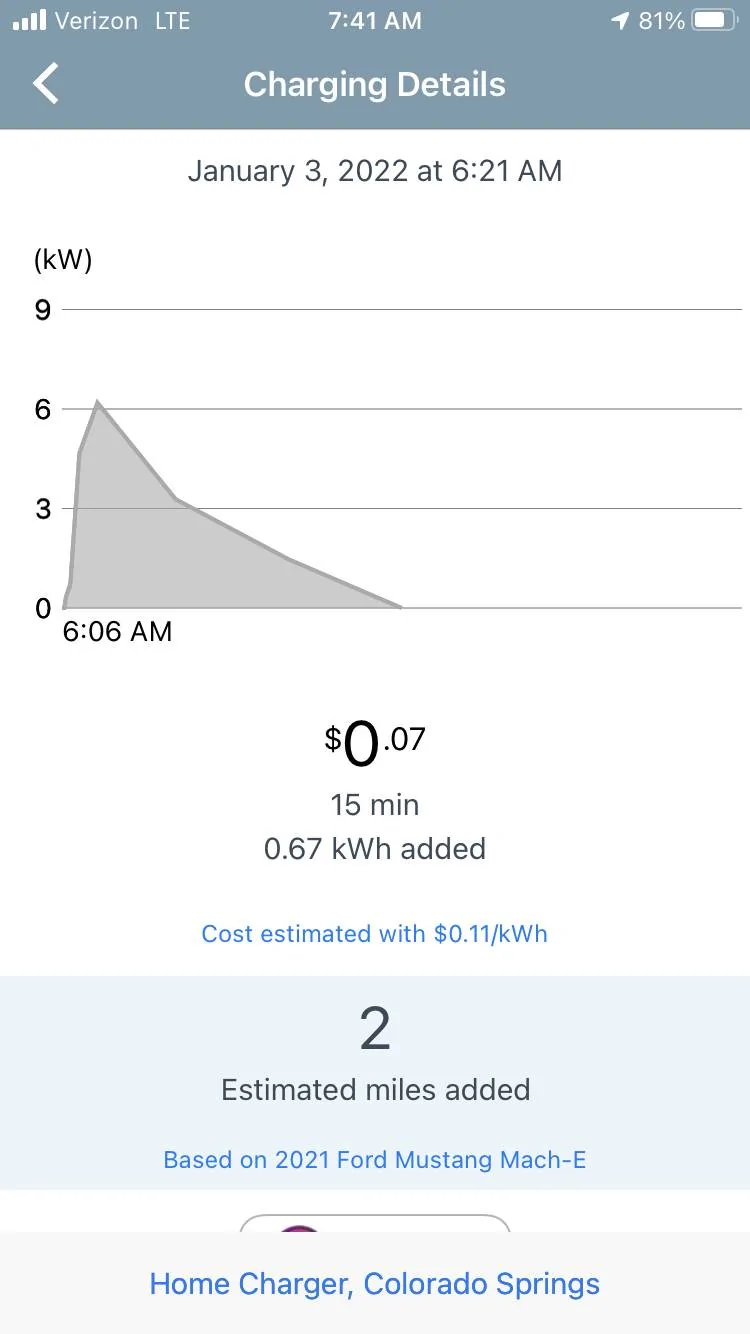

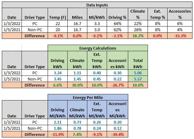

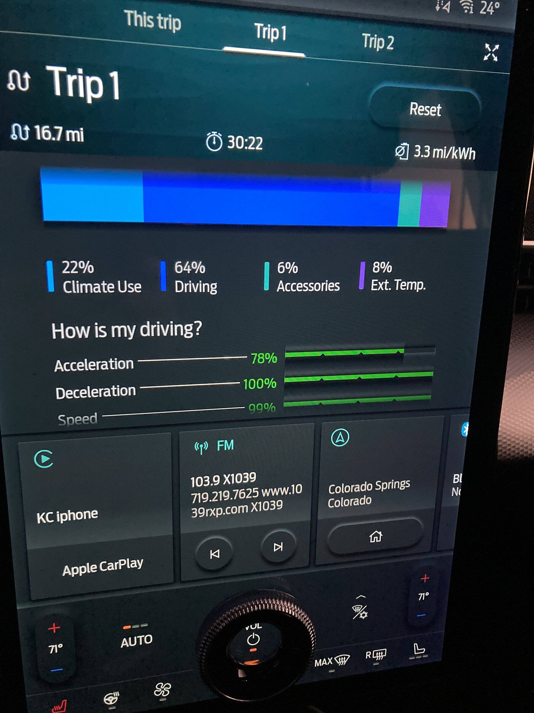

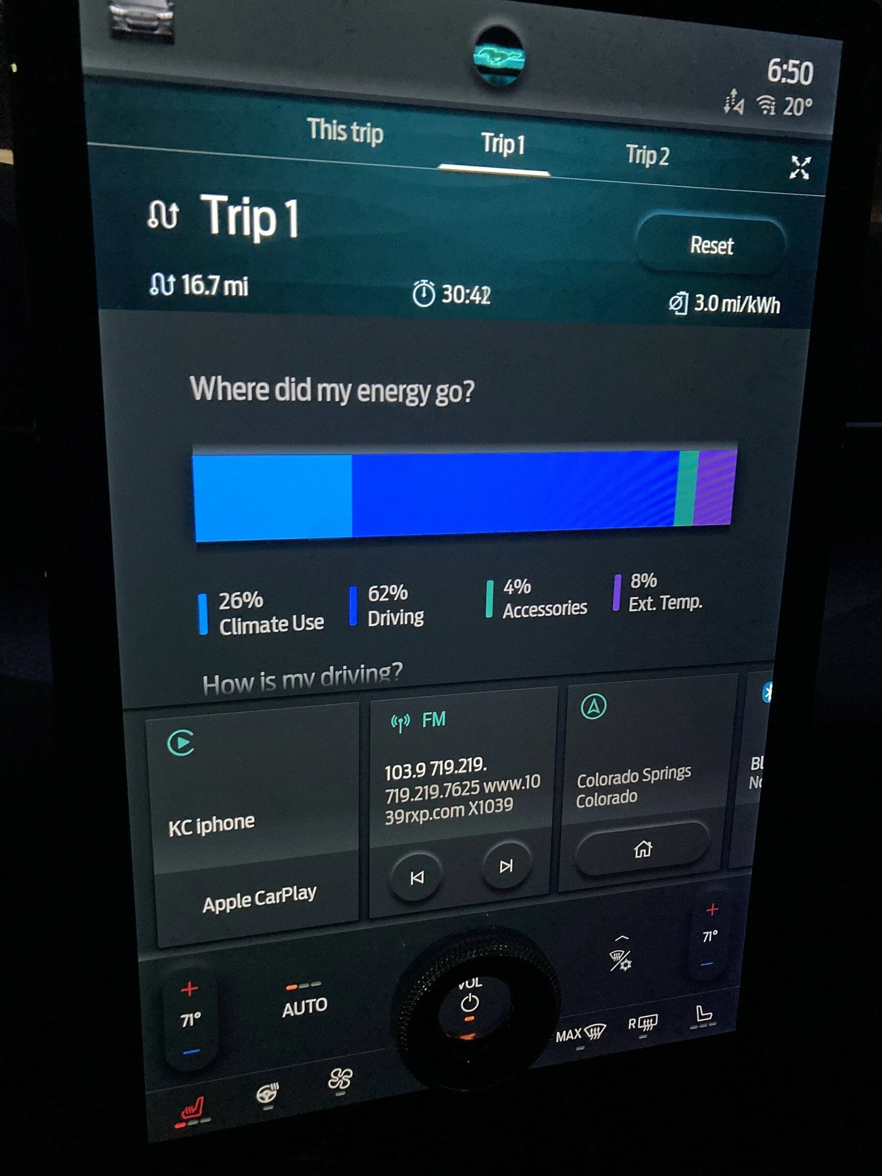

How much of an impact does preconditioning make? Here is a quick test: same route, same climate settings, and roughly the same 20 degree temps, on two different days. The first I have PC set to Medium and no PC the second. As you would expect, I saw 9% decrease in efficiency without PC.
Preconditioning definitely improves your Mi/kWh efficiency and driving range, but does it save electricity? Probably not. If I add the .67kWH that it took to precondition, my energy from that first drive would be 5.73kWh, a 2.9% increase over no PC. That $.07 is a small price to pay for a warm butt and arguably better battery life, but if you are going for maximum efficiency, it is something to consider.

Curious about the cost per kWh you used (I also have a ChargePoint). Is $0.07 what you actually pay for a kWh (though it looks like there are pics with .07 & .11)?
I’m at about 0.18 which includes a per kWh delivery charge on top of the actual electrons. But I can charge for 0.15 at work which makes the calculations to determine the most cost effective charging strategies tricky but probably comes down to how much I want to be warm when I get in the car.
My utility cost is $0.105 per kWh and I recorded .67 used so that charge session used $.07 of energy.

I wonder how much of that energy difference happens in the first few miles. I'd think that you'd see most of the difference in the first 10 miles, but miles 10-20, 20-30, etc. would be the same for both situations.
I see the PC lasted for 15 min. Can it be done in 7 min? This is good information, thanks.
Yes I think that is 100% true. Also it depends on what the trip looks like. Normally I drop my daughter off at school which is 3 miles away and the car sits cold for 5 minutes, I drive 5 miles and the car sits for 5 when I drop my son off and then I drive 10 miles to the office. I think that would negate much of the advantage. For this test I only had my son so the stop was further away and it was only one.
