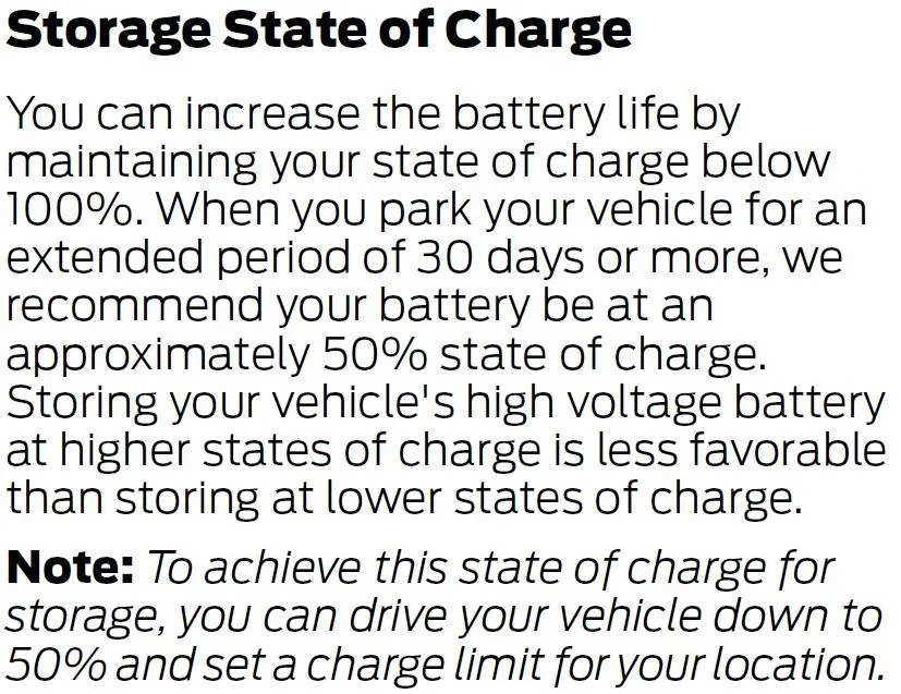

Ford recommends that if you were planning to leave the car parked for a an extended period (many months) that it is best for the high-voltage battery to leave it charged only to 50%. But 16 days isn't very long.
Not many months!!! 30 days or more.
