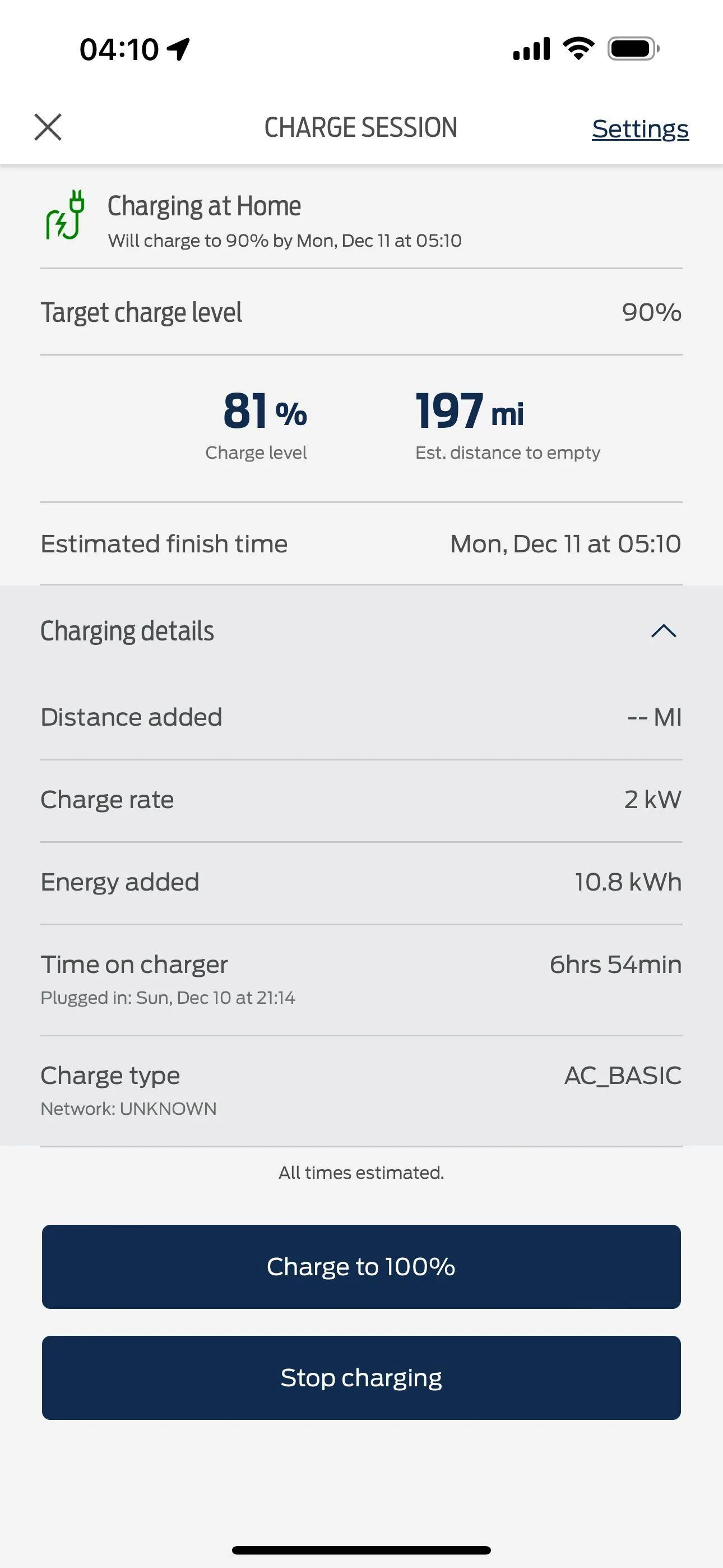

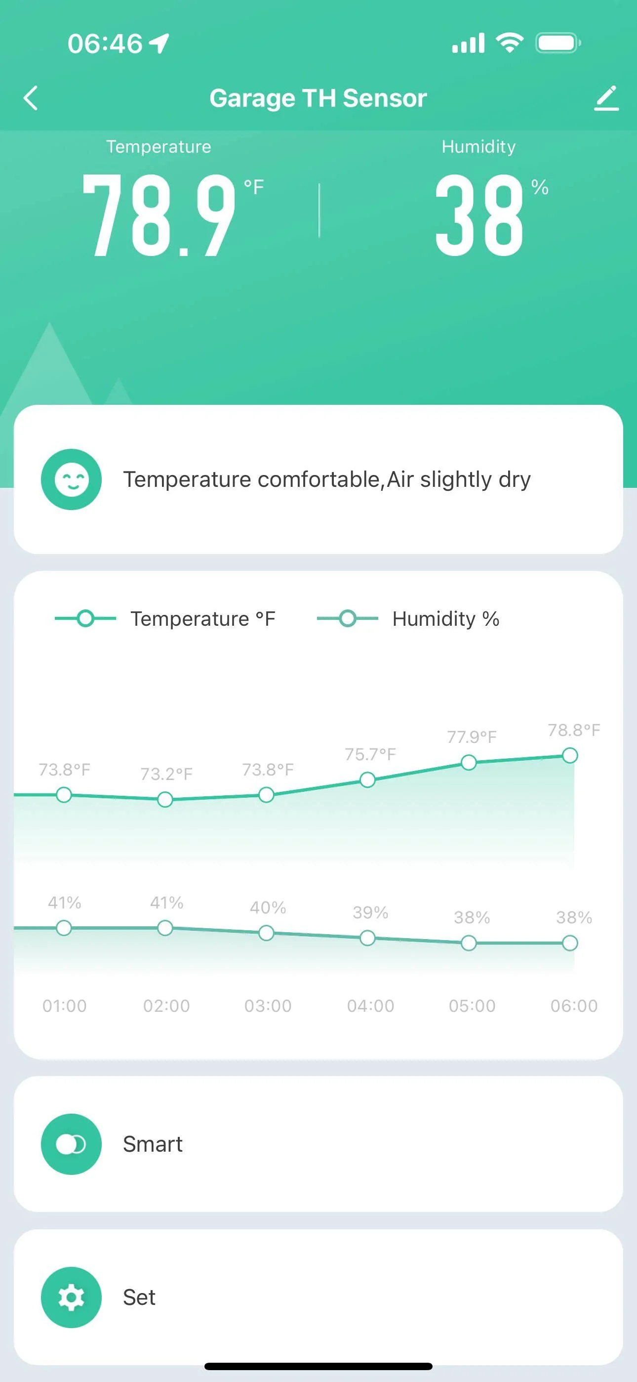

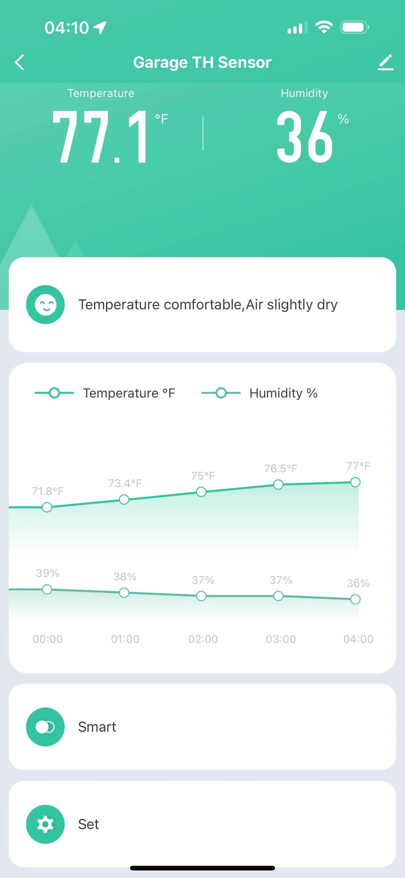

Ok guys, bad news. The car started to act up again. I reenabled charging locations and set mine to only charge from 00:00 to 3:00pm and connected it to a 3kW EVSE (220V 16A). The initial SoC was 80%, by the time (4:10am) I stopped the charging it was 81% SoC. The ambient temp in the garage went from 71.8F to 77F, so I technically can use the car as a space heater :(
screens attached.

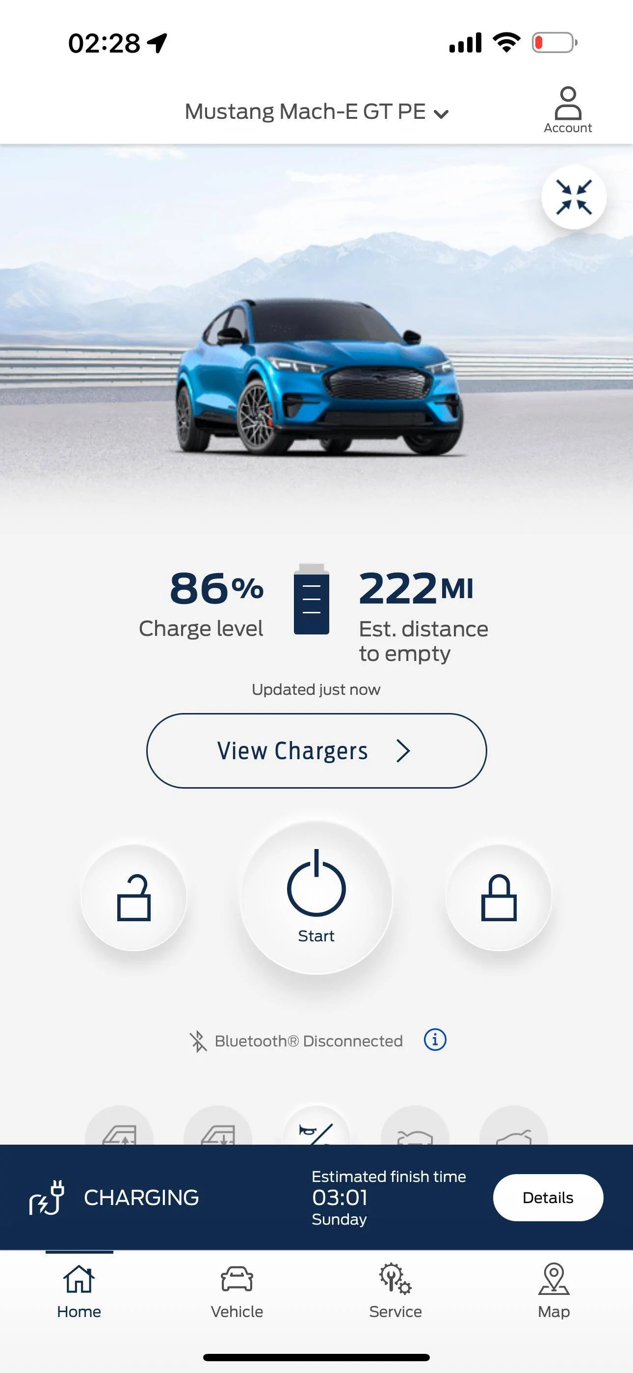

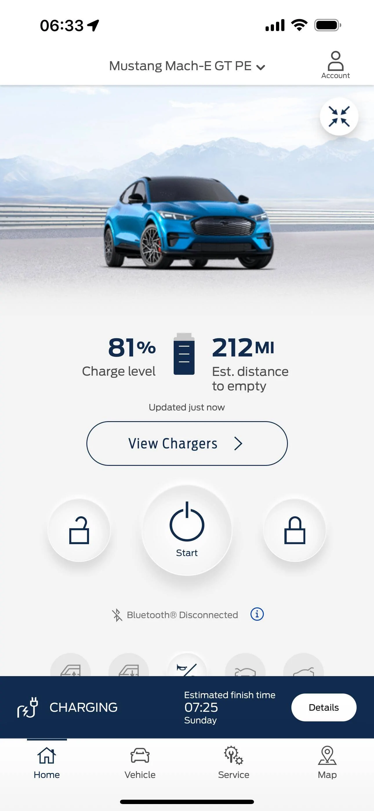

Hey everyone,
Recently a very strange issue started to happen with my Mach-E. It looses SoC during overnight charging at home on Level 1 charger.
Let’s say I plug it with SoC of 86%, then in the morning it displays 81% SoC after 4 hours of being connected to Level 1 120V EVSE.
Also it produces a ton of heat and warms up my entire garage and makes it very noisy there due to running fans non-stop.
I took it to the dealer, told them that it loses SoC while on level 1, showed them videos of car spinning fans and cycles coolant non-stop and of course the outcome is nothing. They simply hooked it up to a level 2 EVSE and found nothing and said that vehicle is ok at this time. I had no time to argue so I picked the car up.
Did anyone come across the issue like mine?
thanks in advance!
PS: DCFC seems to work just fine. Level 2 10kW seems to be slower now and also makes car to generate heat and spin fans like crazy.

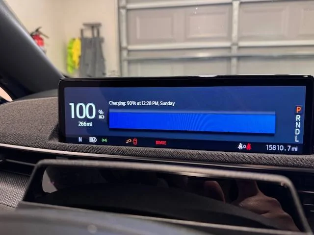

What I also noticed is that car can’t predict when it will complete charge. Basically it’s guessing, e.g. it tells you that it will complete charging in 2 hours, but SoC is 70% and car is connected to a level 1 charger.
on top of that the car battery may be at 100% SoC, but it’s actively charging beyond 90% limit (see screenshot)

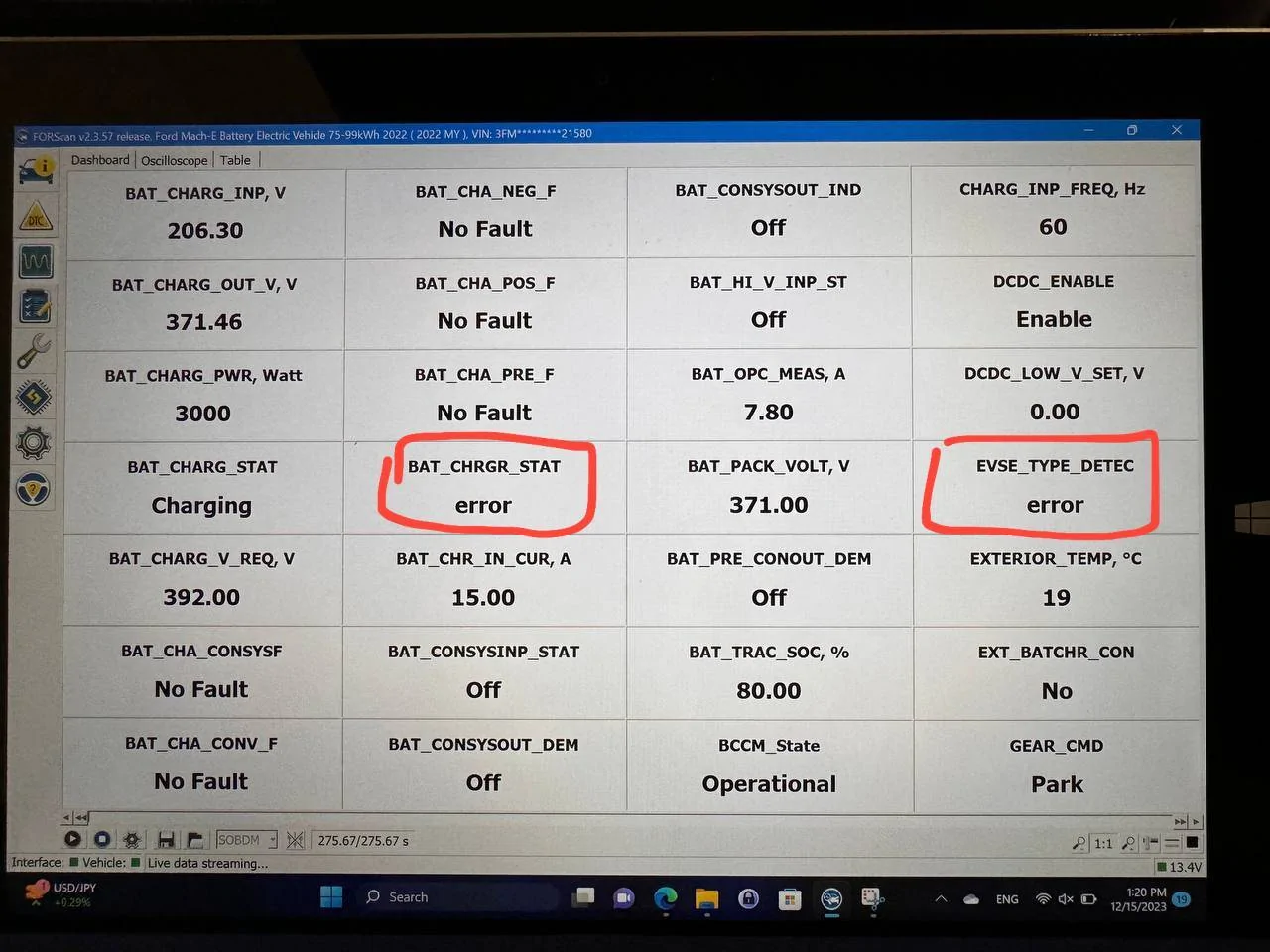

I also noticed that car can’t detect the EVSE type and Forscan kinda proves that (I highlighted params on the screenshot)
Ford Mustang Mach-E My GTPE loses charge while on Level 1 EVSE IMG_6323

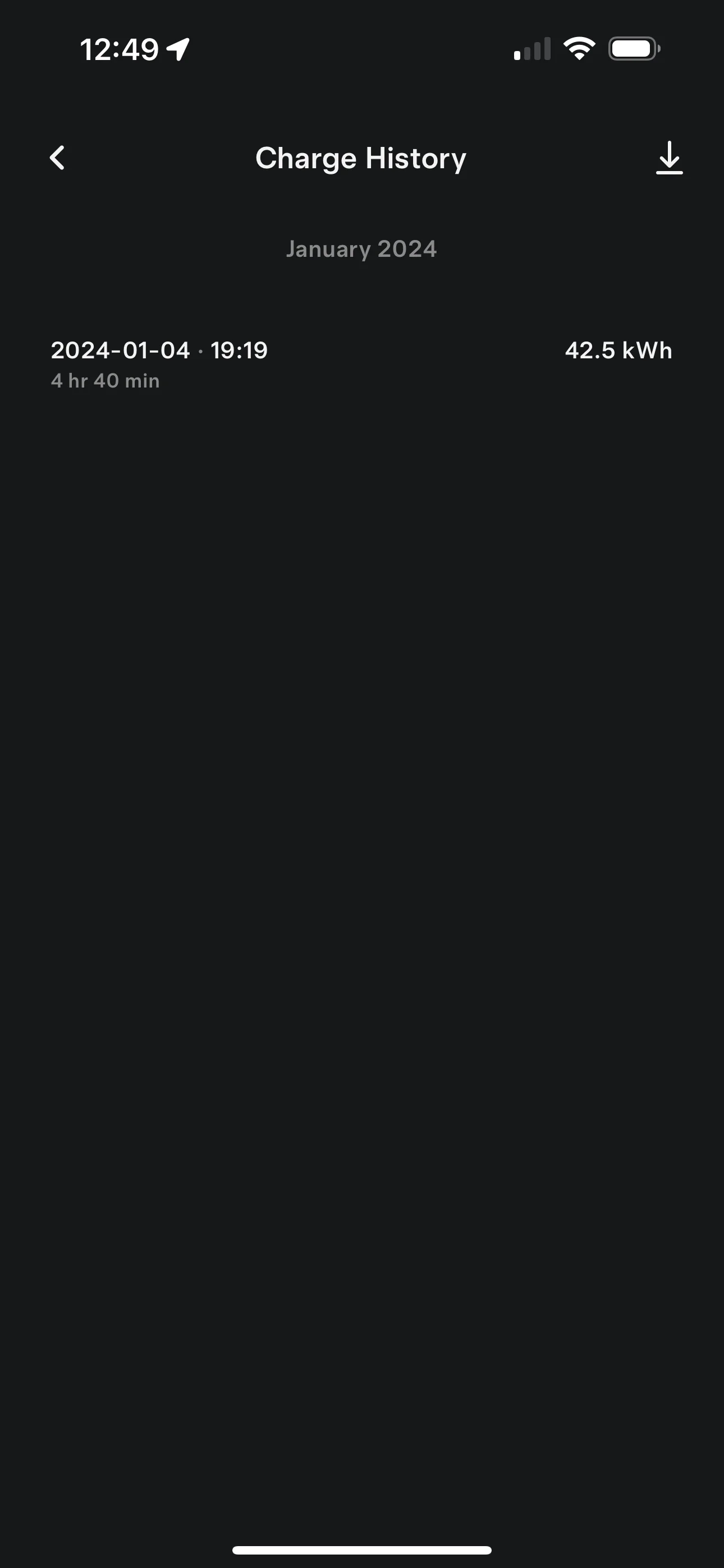

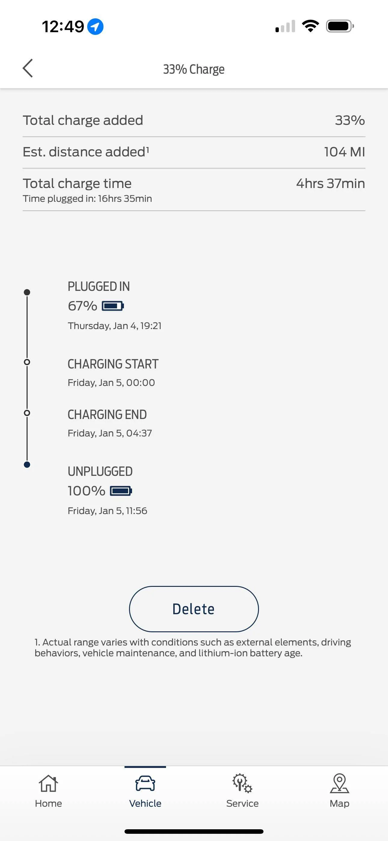

on top of everything I’m getting enormous electricity consumption numbers during the charge on low powered L2 and high powered L2 as well due to battery heating/cooling.
Ford Mustang Mach-E My GTPE loses charge while on Level 1 EVSE IMG_6575
Ford Mustang Mach-E My GTPE loses charge while on Level 1 EVSE IMG_6576
as you see my Tesla wall connector (48A) has delivered 42.5kWh only to top off 33% which roughly is 30kWh +/- 10%
So technically even if you haven’t noticed the discharge of HVB you will see it on your electric bill.
