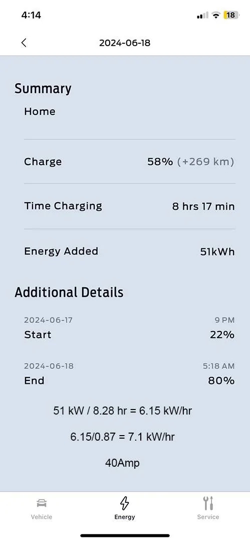

  1. iOS 17. and FP 5.
  2. Scheduled
  3. L2 plug in 40 amp
  4. 2021 and software was install just before it slowed down. Worked for 2.5 years but now it is a lot slower.
Not sure if it has anything to do with the phone for my taper? Appears to be between my car and the charger.
My last and everyone since it started over a year ago.
Ford Mustang Mach-E Does Mach E taper charge on level 1 or 2? IMG_4564
-20C 20C 30C does not matter.
