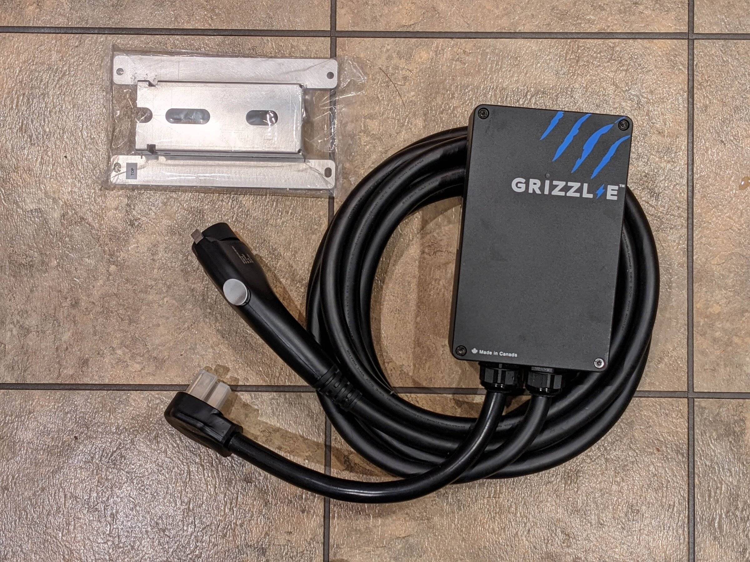

If anyone is interested, I've got a brand new Grizzl-E Smart Classic I'll sell for $400 plus shipping. They replaced a defective one under warranty but I retired last month and took the JuiceBox I had installed at my office. I liked the Grizzl-E, it's really well made. They aren't pictured but includes the wall plate and cord holder/holster.

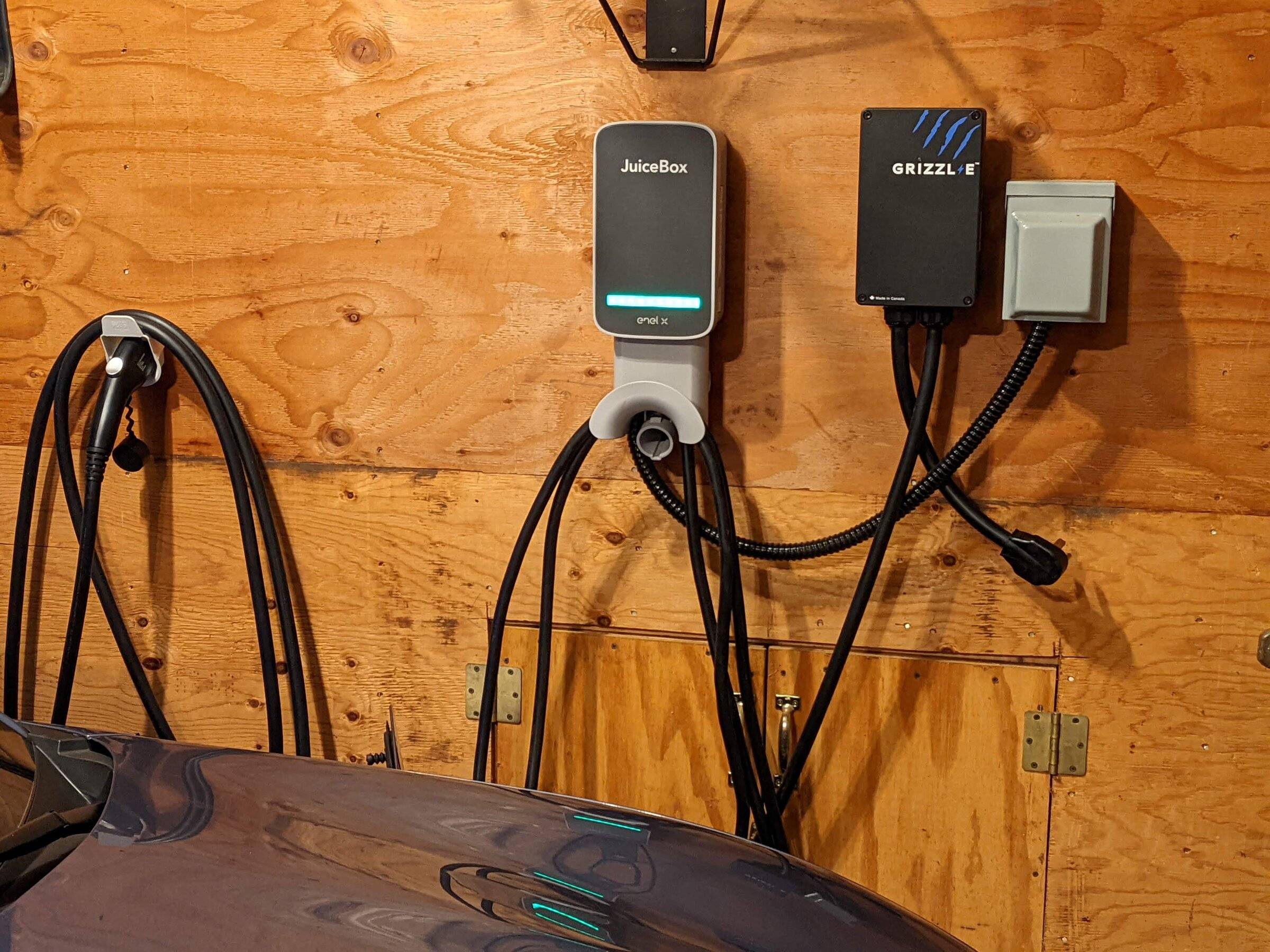

Here's the old one mounted in my garage.

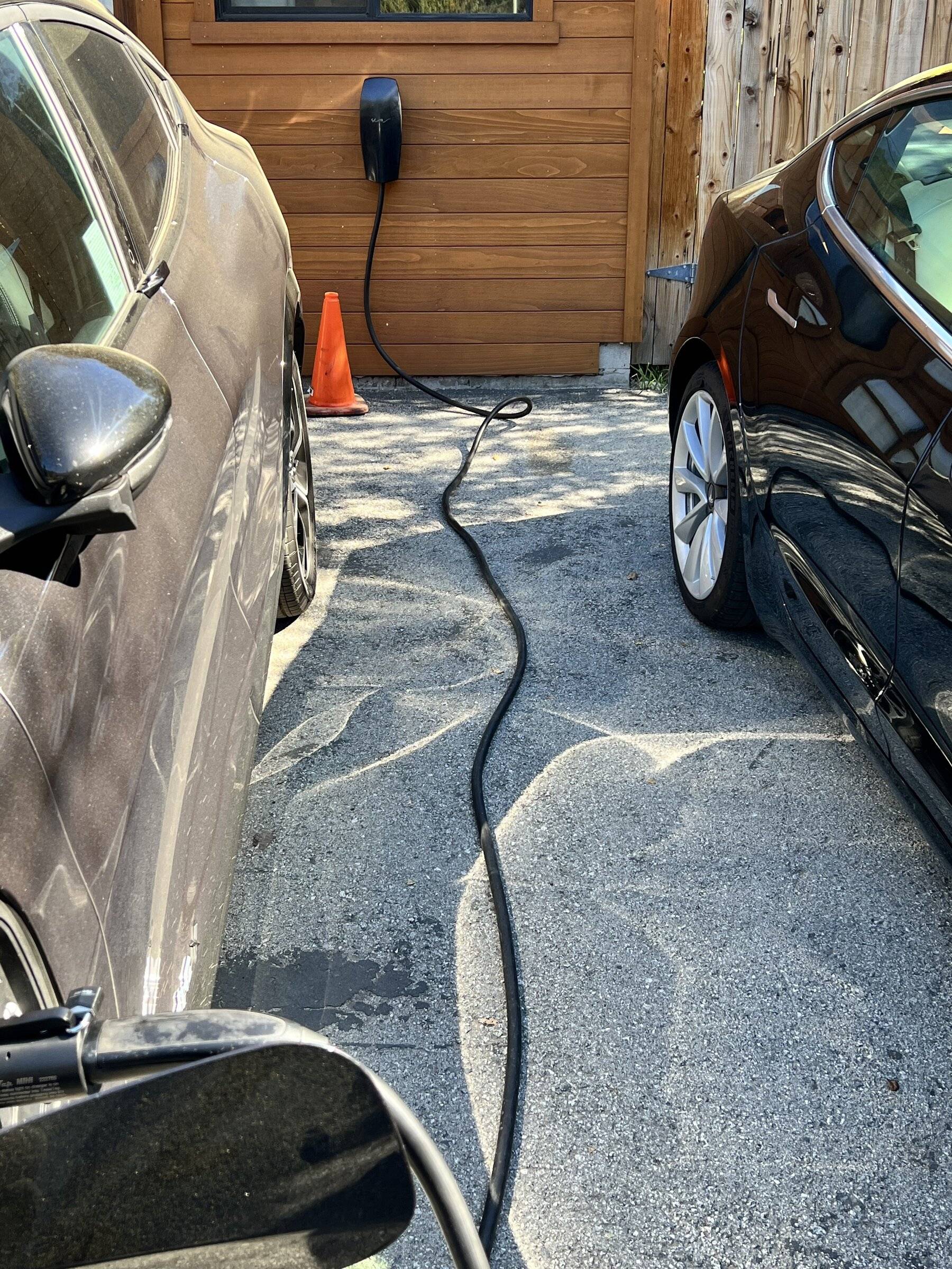

Here's mine. Yes, it may be the heaviest cable I've seen on a home charger.
Just out of curiosity, What is the AWG size of the charge cord on the Grizzle-E EVSE unit?

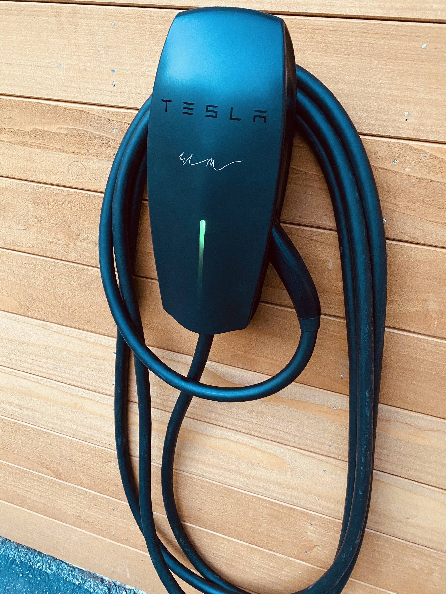

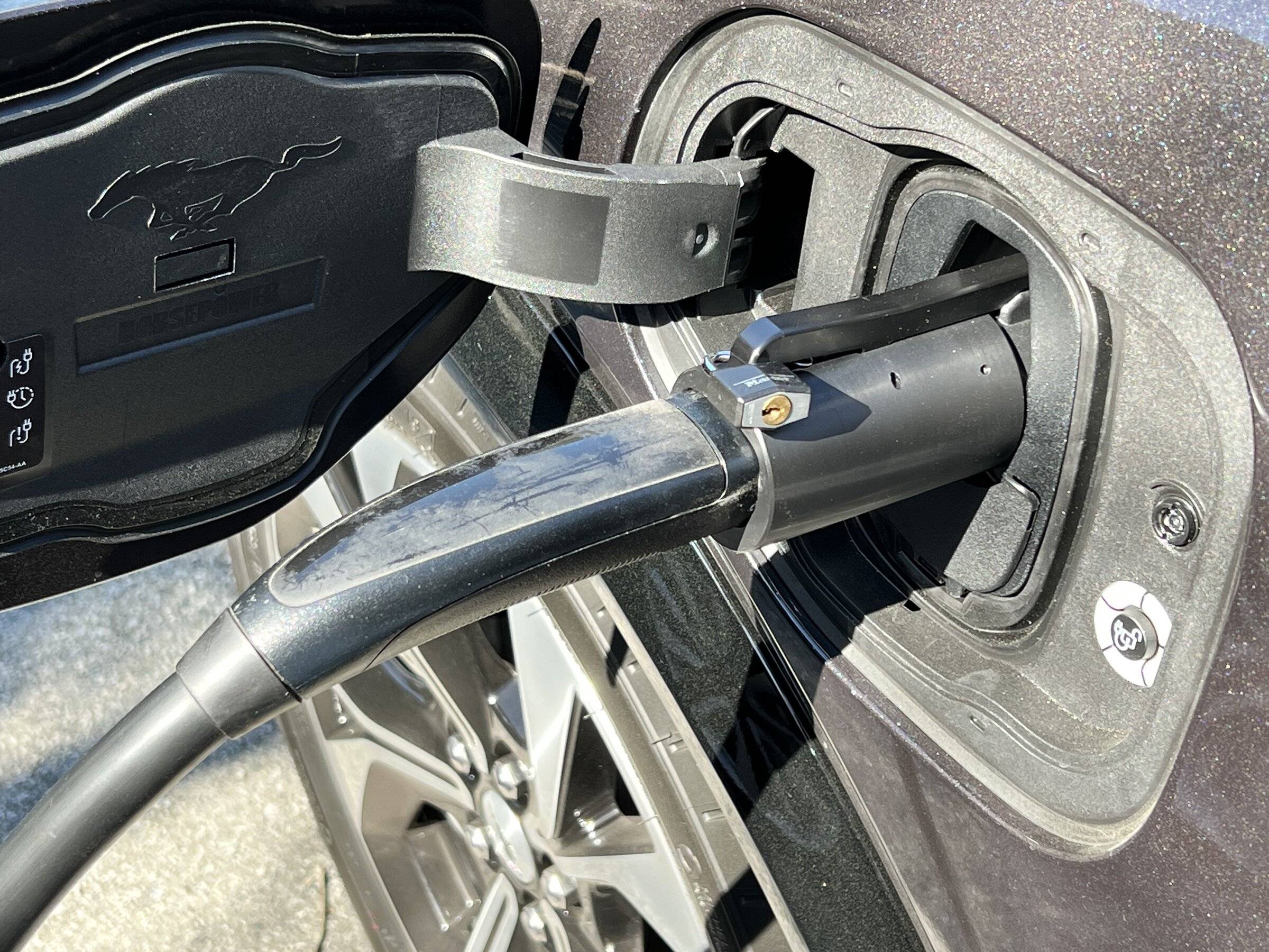

Here's another option you might want to consider if you have (or may acquire) a Tesla. You can charge your MME with a Level 2 Tesla Wall Charger.
My 2022 MME Premium shares the Tesla Wall Charger with my Model 3. The Tesla Tap Mini adapter works very well. It's not cheap but is very well engineered and saves me the cost of installing a dedicated Level 2 charger for the MME. I had to buy the 60 amp Tesla Tap adapter because I didn't want to run 40 amps continuous through their 40 amp model.
Besides, I can't use two Level 2 chargers simultaneously anyway. My garage was built in the 1980s and is limited to 50 amps total draw. So I had to set my Tesla Wall Charger on 40 amps maximum to comply with code, even though my Tesla is capable of charging at 48 amps.
When I installed my rooftop solar system on the garage, I wired the Tesla Wall Charger at the same time using 6/2 Romex. The entire cost was covered by a state rebate for EV charging equipment. I also have two Tesla Powerwall batteries that run the house during peak and mid-peak hours, allowing me to draw power from the grid only during off-peak hours. Both the Tesla and the MME are set to charge automatically after midnight when rates are lowest.
And I agree that the FordPass app is inferior, especially compared to the Tesla app, which gives far more information about charging.
