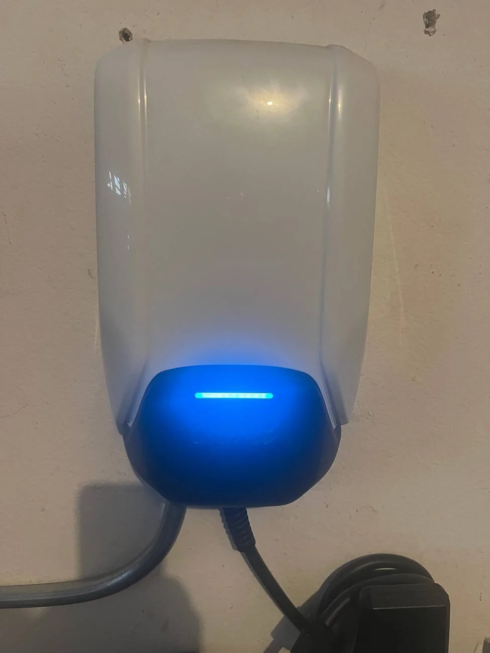

thank you for your detailed response, the Level 2 Ford Charger cost around $800 (Ford Connected Charge Station I think - pictures attached) - My electrician keeps saying that the Vinfast is not compatible with the Ford charger , I have a hard time believing this as every vinfast forum I have been on, no one has any issue with any Level 2 charger they use.
J1772 is an industry standard. Any J1772 charger should charge any J1772 vehicle. So yes the Ford Connected Charge Station should be able to charge a VinFast without issue. Your electrician is wrong about that.
Can you go into the Ford app and verify the maximum amperage you can set the charger to is 40 amps? (For a 50A breaker.) If you can set it higher than that, the electrician configured it wrong and the rotary switches inside the charger need to be set to 40A correctly according to the instructions.
If the breaker is tripping with the VinFast but not the Mach-E, I think there's a problem with the VinFast. I'm going to guess you have a GFCI breaker and there is some kind of wiring fault inside the VinFast triggering it.
