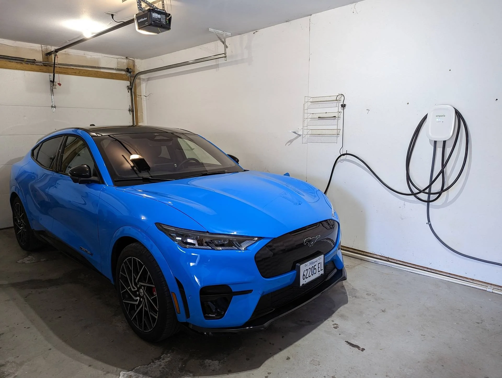

I don’t own one of these, but based on what I’ve read and researched, plus all the comments herein, I’d buy an Emporia if I was in the market for an EVSE right now.
Yep, this is what I did 7 months ago after purchasing my '23 GT. Did a bunch of research on all the different chargers(I know it's technically called an evse)on the market and landed on the Emporia. For the features and price point there is really no competition.
So far it has worked out fantastic and since I did the install myself I saved a bunch!
