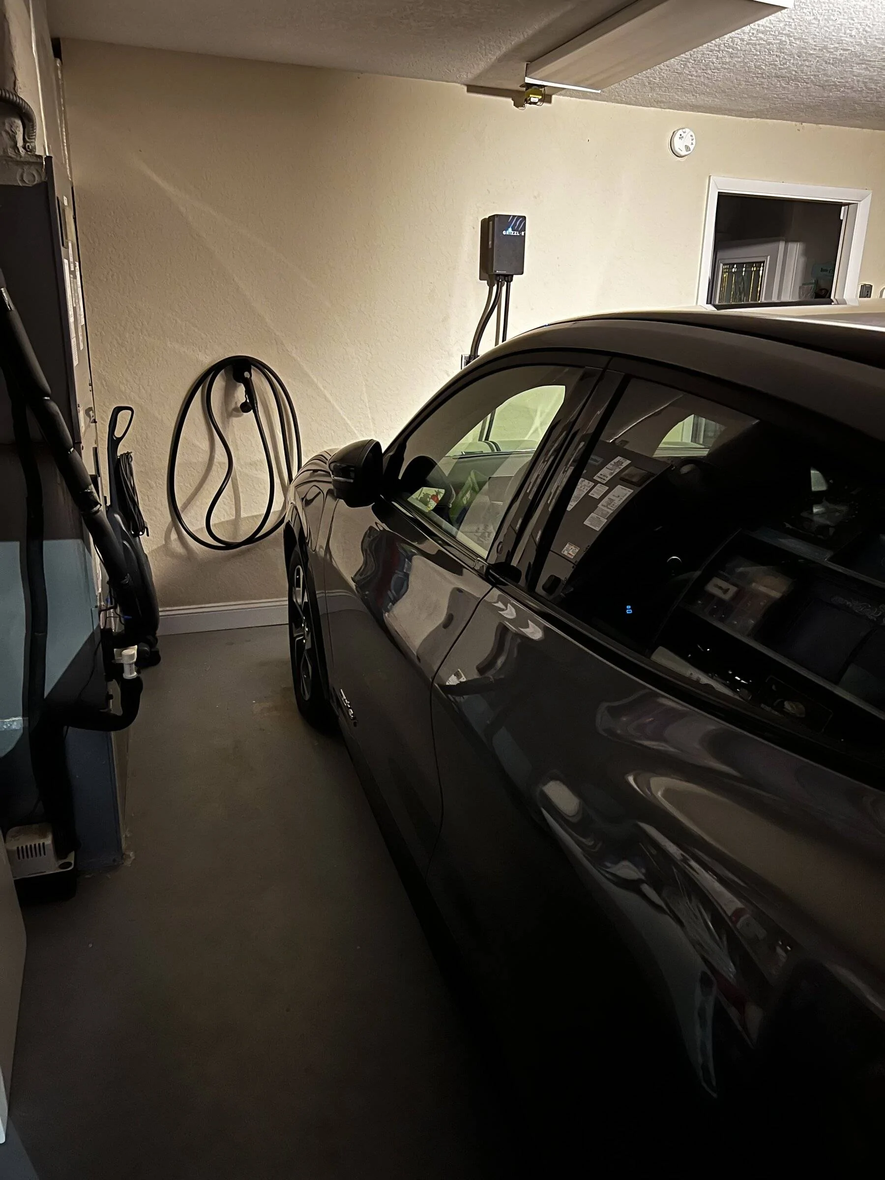

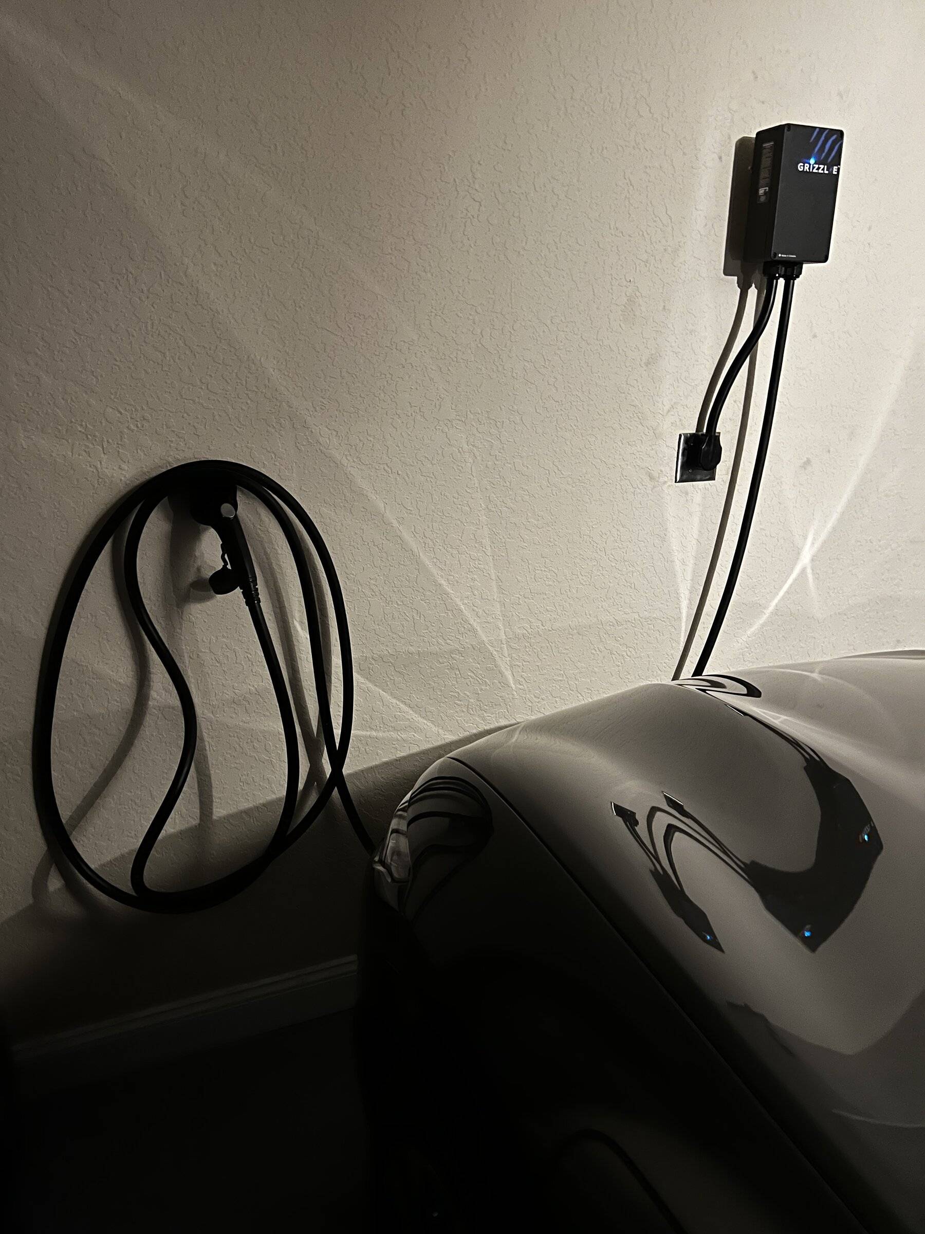

Do you have it set for 40 amps? Any pics of it in your garage? Looks like it has heavier cables than the Ford Mobile charger.
It’s on a 40 amp breaker so it’s set to 32. If you have a 50 amp, you’ll set it to 40. Yeah the cables are much thicker and better quality than the Ford charger.

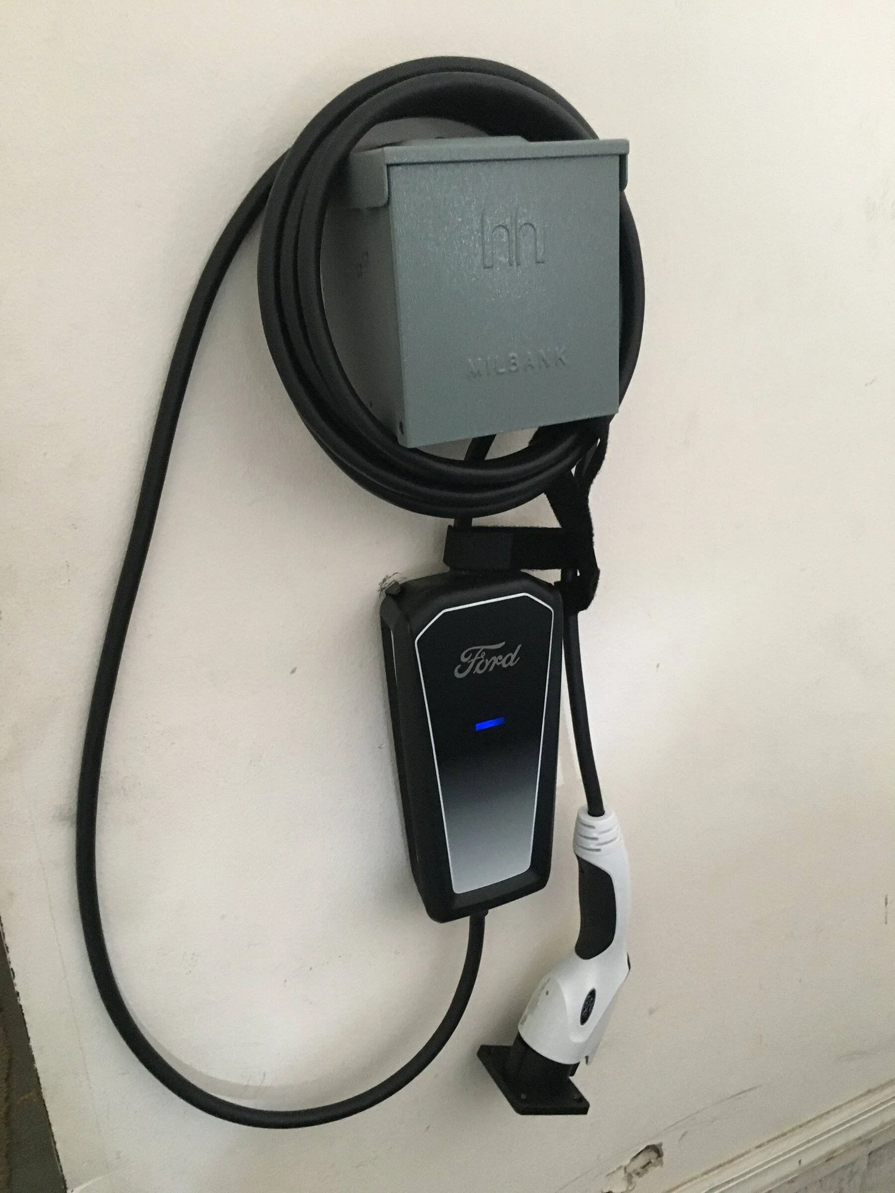

Thanks for the pics! This is my current setup. Looks like I could mount it to the right side of my power box and then loop the 14-50 cable over to it.

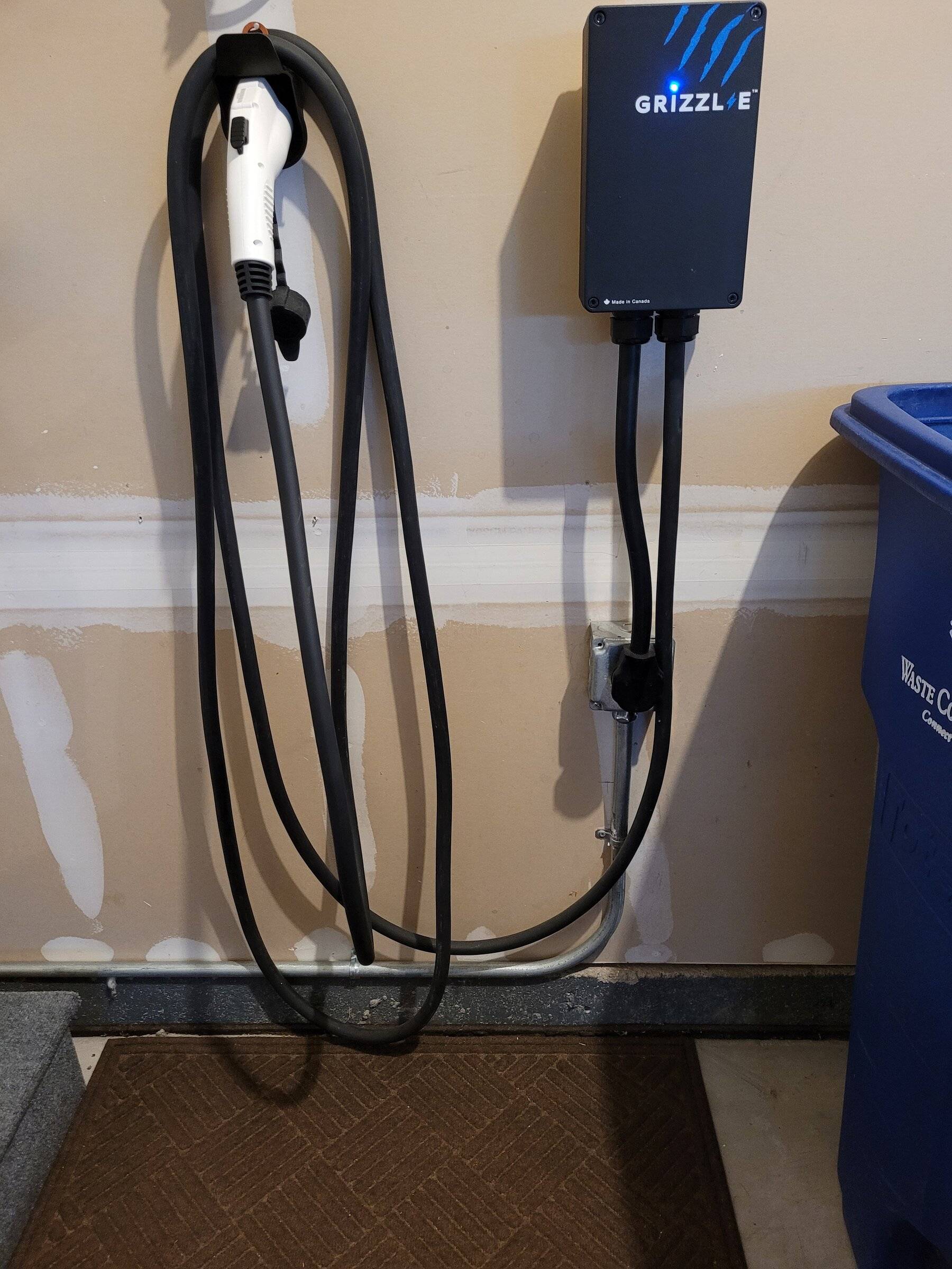

Here's mine. Yes, it may be the heaviest cable I've seen on a home charger.
