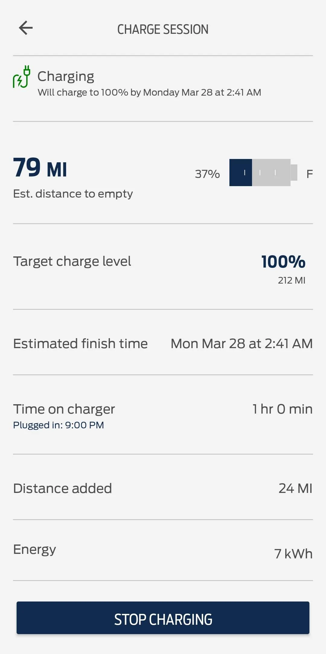

Wrong, Ford Pass only gives you %Charge added not kwh. Yes you can convert if you want. Juice Box 40 gives me kwh added and date. It gives you session totals and cumulative totals. I like to separate my EV usage from my household usage. Some EVSE units allow you to adjust the charge rate from the app, others you have to open to set dip switches, and some are not adjustable.
Ford Mustang Mach-E Mach E Level 2 Charger Screenshot_20220327-220113_FordPass
It does, look at where it says Energy. This is how much it adds after 1 hour of charging at 11 kW. I have the 70 kWh battery.
If you ran an 11kWh charger for one hour and gained 7kWh in energy, you have a big problem.
7/11 = 63.6%, i.e. you have a 36.4% loss. That's a disaster. Or, FordPass is full of crap.
If I look at the charge log, it says I added 13% to the battery on my next to last charge. 88 x .13 = 11.44kWh. So that's not right, because it's for the previous charging session. In that session, Juicebox says I used 12.513kWh. 11.44/12.513 = 91.4%, i.e. a 8.6% loss. That's more like it.

If you ran an 11kW charger for one hour and gained 7kWh in energy, you have a big problem.
Yeah, I have to agree with you, the FordPass app is crap. I said it's on the app, I didn't say it's accurate, haha. I believe my EVSE's app for actual Energy Use.

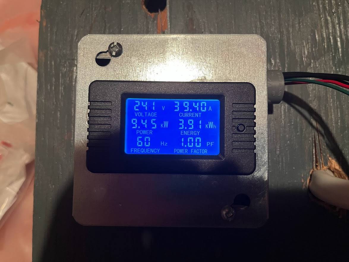

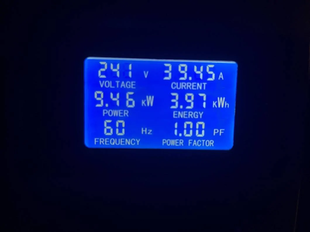

I must admit I was curious about how much electricity I was using, but didn't buy a smart charger. Went with the Grizzle 40 classic.
I installed a meter to check how much electricity used.
I am time of use power and have the car set to charge within those times.
Easy to see
Ford Mustang Mach-E Mach E Level 2 Charger meter 2
how much used by multiplying the total KWH over the month by the cost per KWH.

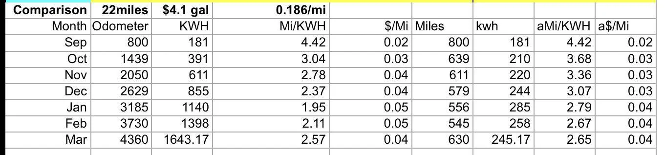

What are you doing with that data? People keep saying that they want this data, but why? (i'm not trying to be difficult, people clearly see value in that data.) Someone mentioned they wanted to know how much of their electricity bill was from the car. I spent about $50 on electricity for the car last month, I don't need to import charge logs to know that. And again, why? Are you paying for the car electricity from a different account?
I knew someone who manually tracked miles driven and gallons of gas on every fill up for over 100,000 miles. He didn't do anything with it, but he was happy he had it. This sort of seems like that to me. Shrug.
Like this?
Easy to see
Want want want!
I'll be using a Grizzle-E 40 amp dumb charger too. That meter is really cool! Where can I get one of those???
I have a similar meter for 120 volt appliances from Harbor Freight that's kind of fun to use. I plugged the 1949 Frigidaire in my garage into it and found out the sales literature from '49 is correct: the thing uses about 120 watts when the compressor is running, but of course that jumps to 160 when you open the door to grab a beer and the light bulb goes on.
