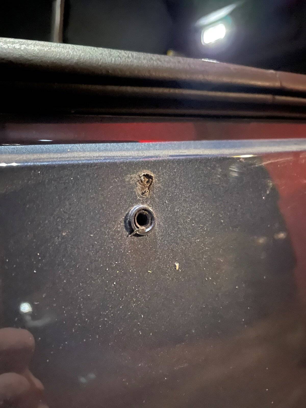

Took the car into the dealership on March 5th to get this fixed, and got it back today, finally. They had to do body repair work from issues present upon delivery (tried to drill holes through the back bumper to install temp license plate rather than just using provided bolt holes, a gouge and misaligned panels). Upon opening the door the very first time at the dealership, the kickstand remained extended. No joke, the exact reason the car went in to get fixed in the first place and it happened on the first try. I tried to replicate at home but couldn't do it, in fact the kickstand retreats immediately after opening so now I get this fun thing. Seems I've replaced a door randomly swinging open with now a pinch hazard..... :rolleyes:
Needless to say, we will be taking the car to a different dealer to try again at some point, but first I'll be putting in a call to the Ford corporate number to let them know what's going on in hopes they can guide me.
Do I have this right? The dealer installed plates on the bumper by adding holes for it?
That is correct. The rear bumper. They must have realized that something wasn't right as they holes did not puncture all the way through, but deep pocks where an attempt to drill the bolt/screw that holds the license plate on had been done. Here's the right side bolt hole as an example. Found it when I went to install my new plates:

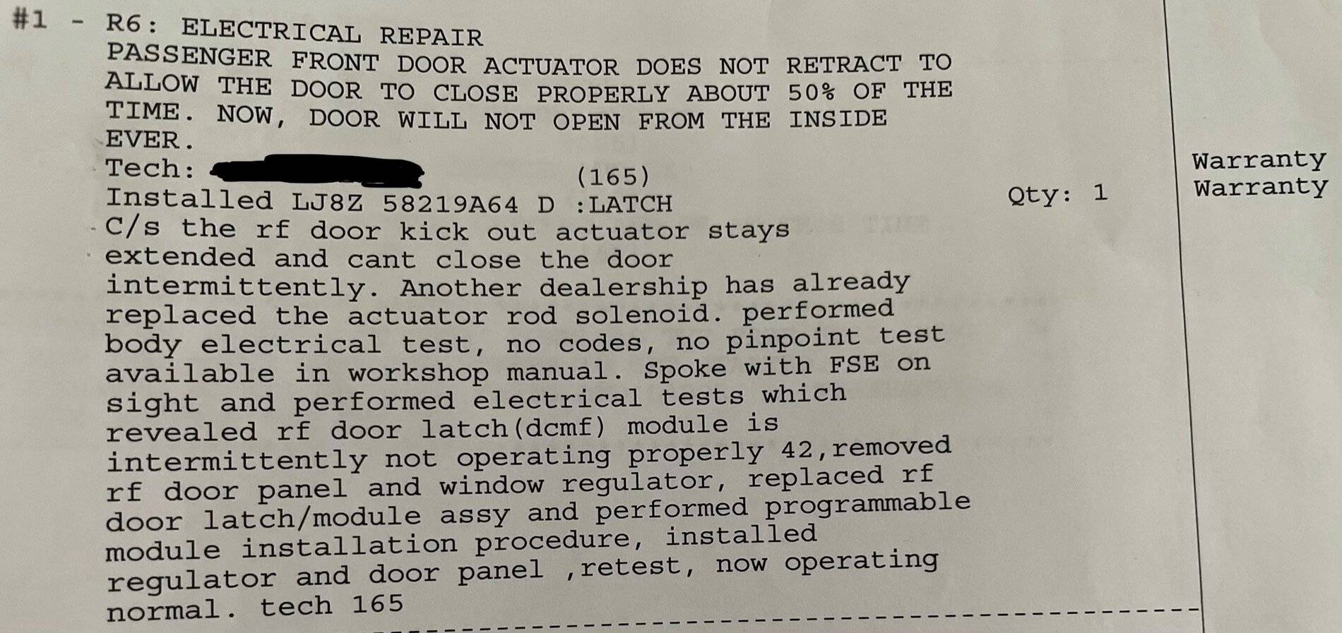

Update to this. Took the car into a different dealership, and they spoke with Ford and actually had an engineer onsite. They couldn't reproduce the problem, but with videos I provided and diagnostics they could see there was an issue. They installed a new door latch, and we haven't had any other problems so far (fingers crossed). Below is the service writeup:
Good to hear.
That is a case of if the component is replaced and the issue remains then the module that controls the component is the next item under suspicion.

Another update on this. I was contacted by the dealer and apparently a Ford engineer reached out to him about this fix. They agreed that the latch was the right thing to replace and the engineer also said that Ford is releasing a new software update for the door modules. Apparently it can't be done via OTA update, so I'll have to take in for the latest. Not sure how they push this out to all of the other cars on the road...
