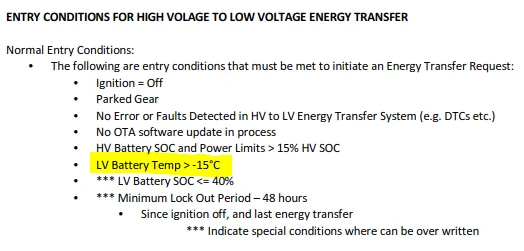

The nugget about not transferring power to the LVB when temp is below 5F (-15C) could be a big deal for people in cold climates. If the car is parked for several days in the cold, you could end up with a dead LVB even with everything functioning as designed.

OK, I was busy last week so missed all this action. A couple things to add:
The "HV to LV Energy Transfer" simply refers to charging the 12V battery when the car is off because it got too low. It is done the same/usual way with the DC/DC converter powered the same/usual way from the HV battery so it's not a special method or different route of charging. It's a special condition triggered by a 12V battery that has gotten too low, which should be rare. When an energy transfer occurs, you get the FordPass message about battery service. They call it an energy transfer because 300 Wh of energy is transferred, which should add back about 70% charge to the 12V battery. The BMS can measure and keep track of energy transferred (volts and amps), which is the basis of the SoC reading it maintains. Some of you noticed the SoC reading changing even though the battery voltage didn't, this is because of temperature or because the BMS is updating the SoC estimate after measuring the open circuit resting voltage after being parked several hours. This is why "idle time" is important for the BMS to update accurately.
The HV to LV transfers are supposed to be limited so as to not cause excess drains to the HV battery or wear and tear on the 12V battery. This is probably the reason for the 48 hour lockout, to eliminate an unnecessary transfer when the battery could just be charged when you drive it the next day. Also, a transfer won't occur when the HV battery is below 15% (to save the HV battery from dying), I think this is why new cars show up with dead 12V batteries. The Mach-E is supposed to be charged if it gets below 25% during transport so that doesn't happen, but most rail yards don't have EV chargers.

The nugget about not transferring power to the LVB when temp is below 5F (15C) could be a big deal for people in cold climates. If the car is parked for several days in the cold, you could end up with a dead LVB even with everything functioning as designed.
Are you talking about this note?
Ford Mustang Mach-E Down for the count :( 1642436399326
it is negative 15C, but I looked it up and it does resolve to 5F. Agree.....that could be a little annoying for the vehicles in northern regions.
I wonder how the car knows what temp is for the LVB? Is there a temp sensor on that thing too?
Yeah, thanks, I inadvertently dropped the minus sign for C. I corrected it in my post so I don't confuse anyone. But below 5F is a regular ocurrance in a lot of places.
