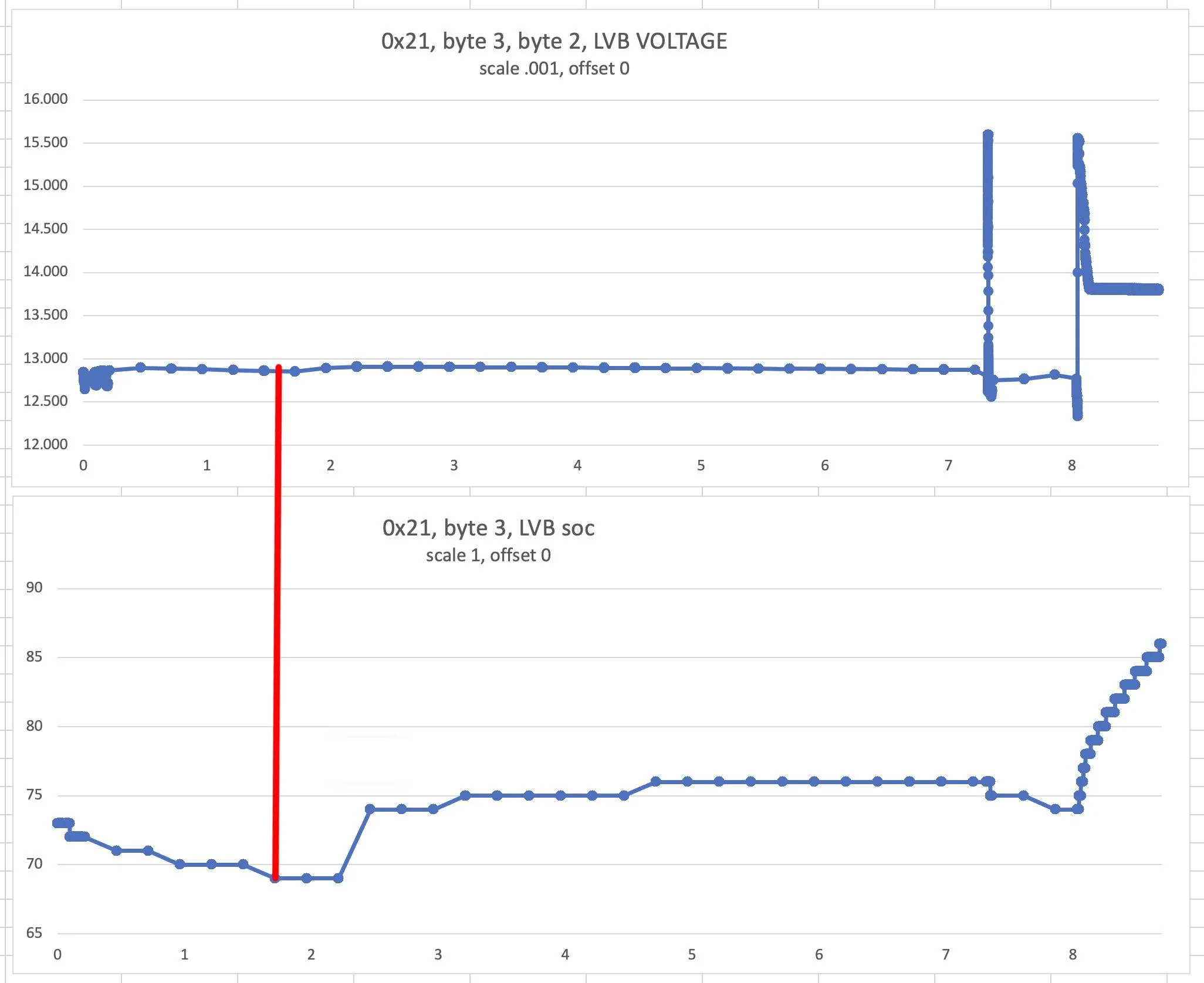

yes, interesting (your red line above), possibly temperature, maybe also measurement error and uncertainty (that first change in soc with no charging).

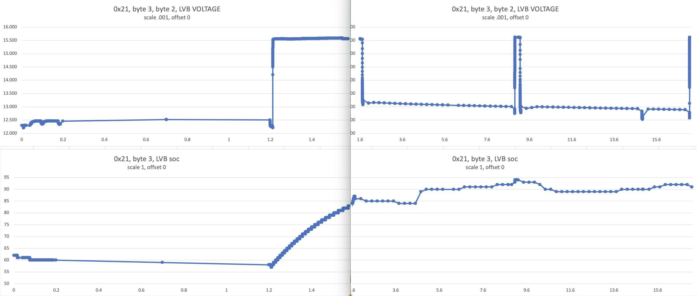

Overnight we fell to -10F by morning (garage not heated). Plugged in (L2), MME OFF, Fri Jan 14 08:23:42 PM 2022, ran though early today Jan 15. 1.2 hours in, MME of its own accord, charged the LVB above 85%. The variation in soc after that is a bit of a mystery.
One of my goals last night (did not expect the LVB to charge by itself, but hey, I guess you never know, until we get a better understanding of the rules) was to put the fob in a small stainless steel pot on the other side of the home, and to turn off iPhone. Note that, at least overnight through this am, did not see any of that discharge pattern back down towards 60%. Forgot to turn off iPad and Apple Watch. Usually I keep the fob in the kitchen, close to MME in the attached garage, and iPhone is all over the place during the day.
I think there are several issues, as others have mentioned before, I wonder if some of it is fob, phone motion too close to MME constantly waking MME up and turning lights and other active systems on.
I do think everything short of physically dead/damaged LVB will be fixed by software changes.
odd, MME went to sleep (or "rest" anyway) about 12 minutes in (0.2), then of its own accord (I think), it woke about 1 hour later, 1.2 hours in, and started to charge the LVB for about 0.4 hours (24 minutes, odd I see a 24 minute charging period, almost always at the beginning of testing in auxiliary mode).
Note the change in time scales. The first plot starts Fri Jan 14 08:23:42 PM 2022 and runs for 1.6 hours, the next b plot 15 hours or so. There was no change from the first plot to the second, here I set the LIN monitor to start a new file every 1 MB. When MME is awake data comes in at 25 pts/sec (40 ms), but slows to one point per 15 minutes asleep. Spaced apart dots are 15 minute sleep cycles for perspective. Click on image for a bigger graph.

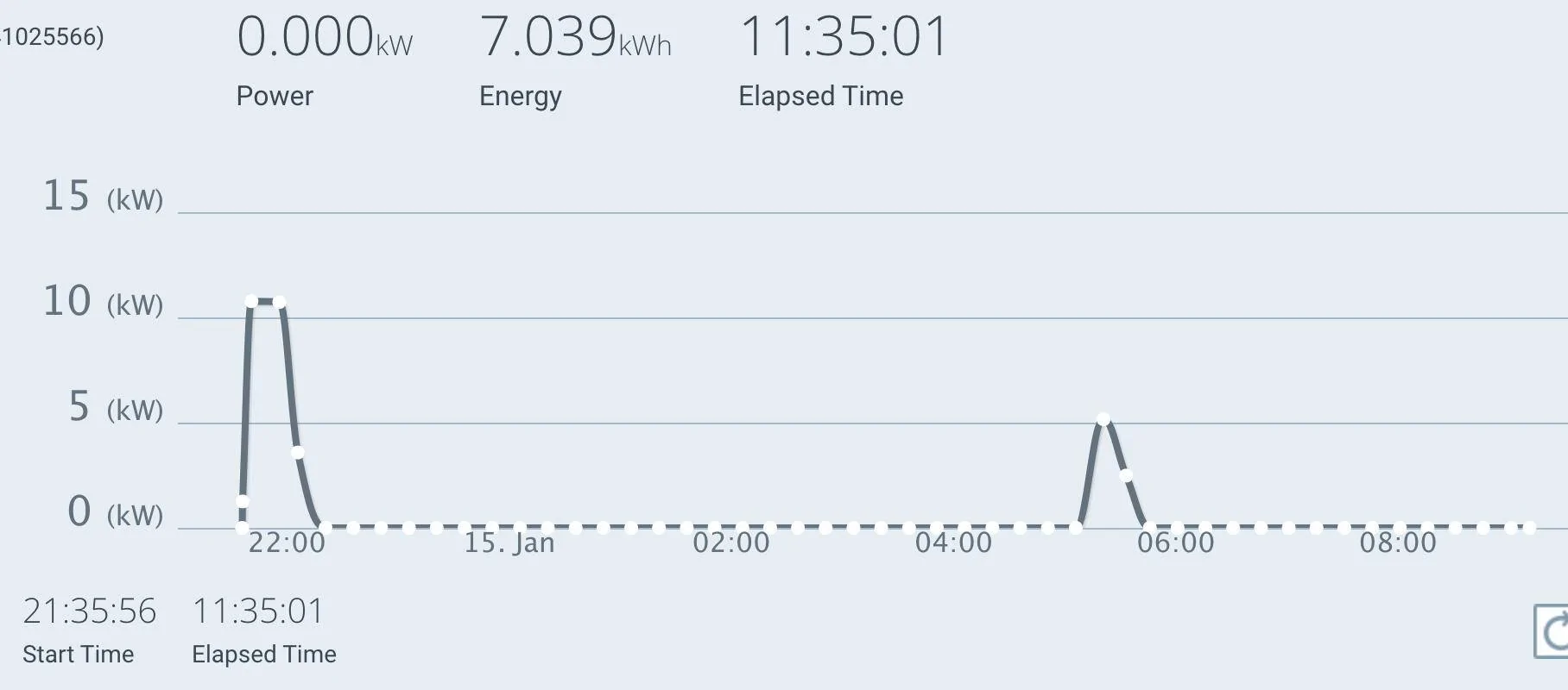

This entire test was plugged in L2, chargepoint rough record overnight. May have topped off the HVB to 80% on that first round.

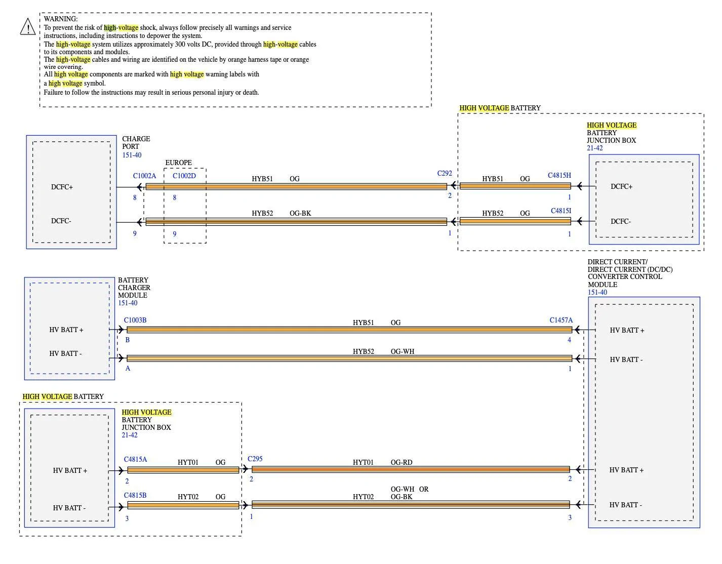

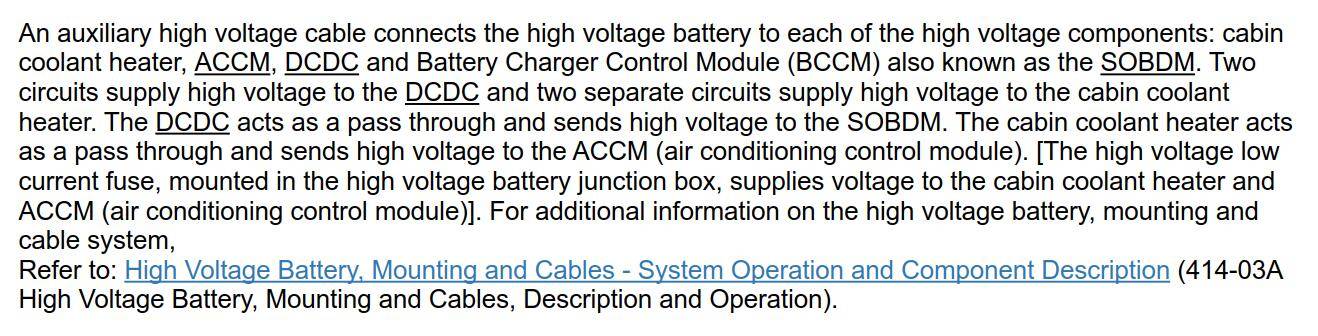

Interesting, I do not completely understand it yet, but this diagram seems consistent with what you are saying. There do appear to be two separate paths to power the DC/DC converter (the bottom two, the top is DC fast charge).
An auxiliary high voltage cable connects the high voltage battery to each of the high voltage components: cabin coolant heater, ACCM, DCDC and Battery Charger Control Module (BCCM) also known as the SOBDM. Two circuits supply high voltage to the DCDC and two separate circuits supply high voltage to the cabin coolant heater.
It might be more like, one is run from the charger (L1, L2), the charge port, the other while driving, possibly including, not driving, auxiliary and "power on", when not plugged in.
It looks like the battery charger is only active/alive when plugged in (the J1772 plug). That does not mean LVB charges while plugged in, rather, LVB can charge according to the rules, from the HV output of the charger when plugged in L1/L2 (DCFC is different).

I finally remembered where I saw some text that discusses the wiring. Found it in the 412-00 Climate Control System section of WSM.
Ford Mustang Mach-E Down for the count :( 1642281113987
This helps support the theory about two separate LVB charging methods (Energy Transfer and Charging). I the DCDC is passing HV through to the BCCM directly then that likely is for the energy transfer. There must be a resistor in there to regulate current but could the LVB be exposed to 380v during the Energy Transfer? If so, that would explain the notation in the document provided by @Astraea which said if an energy transfer occurred daily then the LVB would be damaged. I would think so....if that was exposed to HV on a regular basis then it will cook fairly quick.
Interesting....
There is no direct connection between HV and LVB, such as by a resistor.
Only the DC/DC converter can charge the LVB through one path. The only low voltage direct LVB path is from the DC/DC converter to the 12V bus via the heavy cable from the DC/DC converter to the LVB. That same cable is how the DC/DC converter powers everything 12V. When the DC/DC converter is on, the 12 LVB just sits there like a parallel capacitor.
There are at least two HV paths to power the DC/DC converter.
The HV charger which takes AC power from a EVSE plug makes HV to both charge HVB and can power the DC/DC converter, diagram below (middle).
The aux HV cable (and aux hv contactor) is just the way the HVB powers the other HV components, including the DC/DC converter and cabin heat. Diagram below (bottom). I think they wanted to separate it from the main contactor which powers motor drives.
