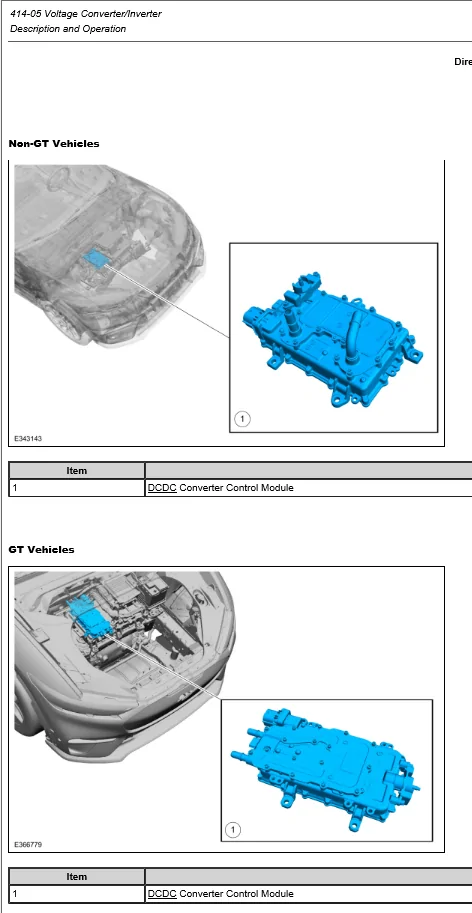

It's interesting that they recommend against any trim level besides GT, due to the inadequacy of the 12v battery to handle additional loads on non-GT trims.
Do the GT trims have a higher capacity LVB from the factory? And if so, what's the reason?
I went back through that document and comprehend it a little better the second (and third) time. :)
They are recommending the GT because it has a larger DC/DC converter 220A compared to 160A in the other trims. They are also recommending the larger HVB for extra range.
The LVB is the same in all trims. 35 AH
It sounds like there are two ways to maintain the LVB. HV to LV Energy Transfer and Charging.
In the WSM is says the DC/DC converter is responsible for Maintaining and Charging.
Maintaining could be the Energy Transfer
Charging could be Charging.
The system might have different contactors for each purpose. Which sorta makes sense because if the car is off then you really don't want the entire HV system energized just to "Maintain" the battery. There might be a backup set of contactors of lower amperage for the energy transfer to the LVB. And that would make sense why there are different conditions for that system. The the requirement for the vehicle to be OFF and in PARK makes sense. When this method is used, the charge rate is .3kW
The other method would be Charging while the vehicle is running.....like we normally associate with an alternator. In that scenario then the charging rate varies between 12.0v and 15.5 volts.
So, two different things are discussed in that article IMO.

I don't think the battery is different.
The detail I noticed was the reference to a 220a dc-dc converter as opposed to the 160a on other trims. I do not know if this is true. Only thing I can think of is that the GT trim would be specified for higher pursuit speed, and the possible extra dc load for the Magnaride active suspension.
They appear to be different parts. Physically different because of the larger motor up front but also different in amps. Shows as two different parts in the Parts Catalog as well....
