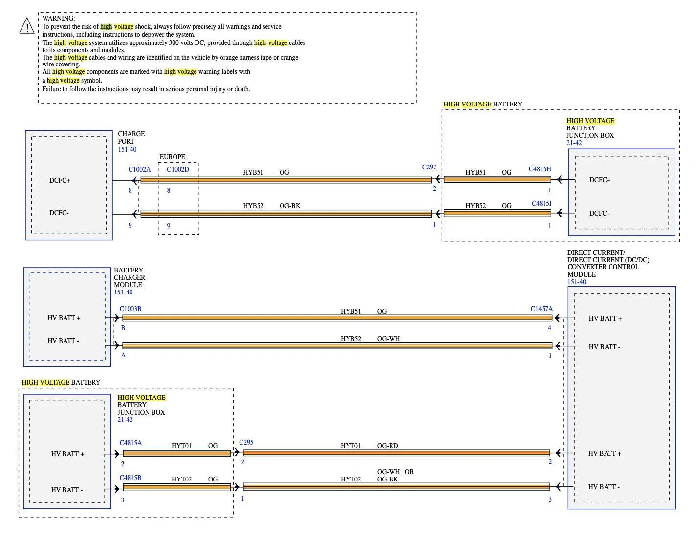

See my post above. I believe Energy Transfer System is different than the LVB charging circuit.
The ETS is for when the car is left parked unattended for a period of time while the LVB Charging System is for normal day to day use.
Interesting, I do not completely understand it yet, but this diagram seems consistent with what you are saying. There do appear to be two separate paths to power the DC/DC converter (the bottom two, the top is DC fast charge).
An auxiliary high voltage cable connects the high voltage battery to each of the high voltage components: cabin coolant heater, ACCM, DCDC and Battery Charger Control Module (BCCM) also known as the SOBDM. Two circuits supply high voltage to the DCDC and two separate circuits supply high voltage to the cabin coolant heater.
It might be more like, one is run from the charger (L1, L2), the charge port, the other while driving, possibly including, not driving, auxiliary and "power on", when not plugged in.
It looks like the battery charger is only active/alive when plugged in (the J1772 plug). That does not mean LVB charges while plugged in, rather, LVB can charge according to the rules, from the HV output of the charger when plugged in L1/L2 (DCFC is different).

Yes, I also came to the same conclusion after trying to make sense of the info as written. Just a case of the target audience not being the casual reader.
I'm glad that there are at least resources available for us to better understand these and how they work to better diagnose problems. Although it still leaves the software side of things to question now that we have the hardware a little better understood. Unfortunately software is probably where my input and basic understanding will end. ?

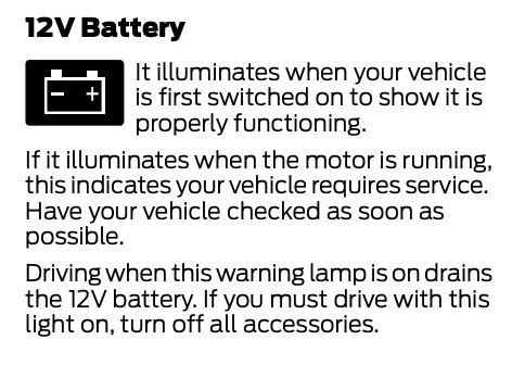

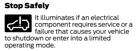

It was Both that one and the "oil change" icon Kinda like this but more neon red -> âš
Nothing to worry about with the battery icon.
Ford Mustang Mach-E Down for the count :( 1642125179472
I'm not sure what the other one was. Was it this?
If so, it means that your 12V battery is likely low. Can resolve itself automatically. Or was it something else you saw?

So as I understand it, there IS a system that will charge the LVB while the vehicle is in motion and a separate one that monitors and chargers the LVB when necessary while the vehicle is off. Does that sound correct?
It sounds that way. A main system that charges the LVB when the vehicle is in Ready mode or when charging the HVB and then another system that transfers energy from the HVB to the LVB. I suspect some sort of latching relay(s) with a control signal from the DC/DC converter. The WSM says the DCCM is able to function even with the main HVB contactors closed. (Or something to that effect....)
Yes it was the second one! And it did say Stop Safely. Of course I was already stopped. Thanks for the help. Maybe it's not the same issue as the OP?
Probably not as severe, but I do think it's related to your 12V getting low, especially since you saw it resolve by itself later. If you ever see it again, just schedule a dealer appointment and suggest the 12V, although there's no guarantee that's what it was.
Might behoove you to put the battery on a maintainer for a couple of days while it's parked at home.

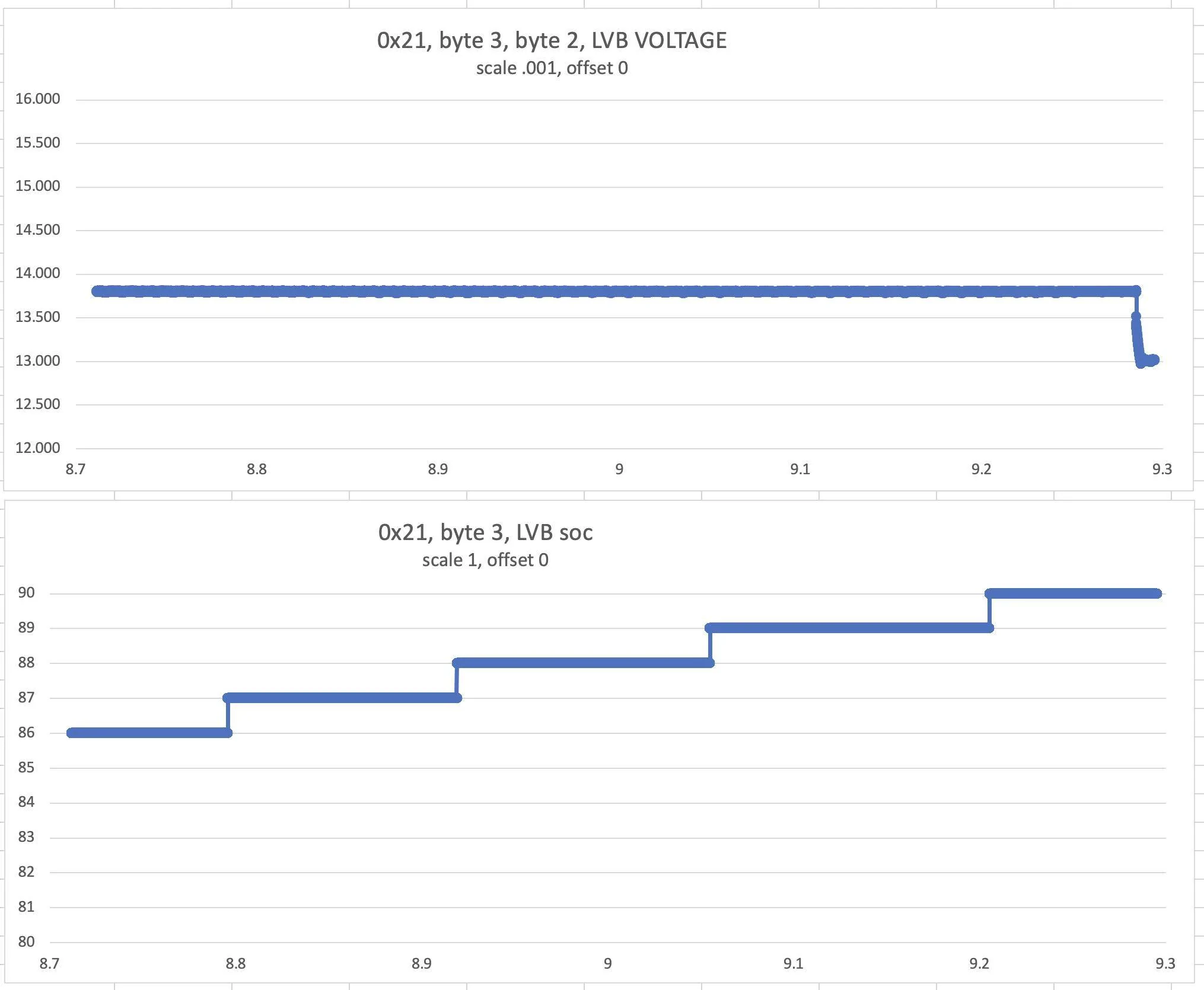

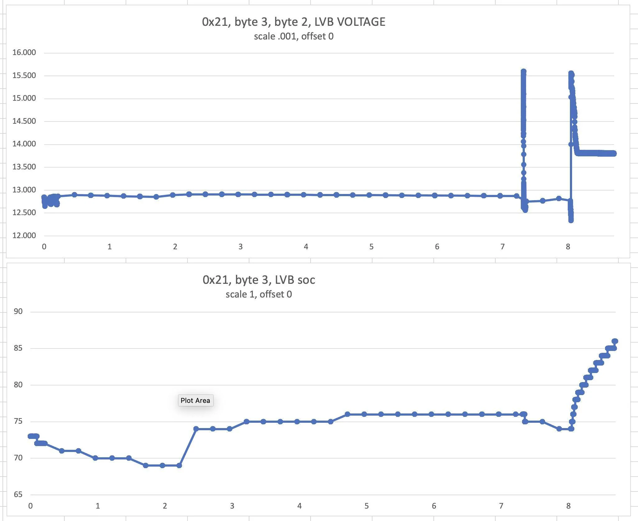

Well, here is another quick anecdotal report from overnight (mild for here, 30sF). First set (voltage over soc) is overnight L2 plugged in. Second set continues where at the end of the first graphs, unplugged MME, turned ON (not accessory). Here, MME charged LVB the entire time on.
Note how BMS (where this data comes from) is active, then goes into the 15 minute sleep/report one point every 15 minutes, then when MME is ON, back to 25 reports/second.
The spike (DC/DC converter on, but only for a moment) after 7 hours is probably from my iPhone and FordPass this morning. Unplugged and turned MME ON about 8 hours into the record (7:45 am). Zero hours on the plots is Thu Jan 13 11:44:11 PM 2022.
Ford Mustang Mach-E Down for the count :( Screen Shot 2022-01-14 at 9.30.07 AM
continuation from above, MME ON, unplugged, then turned OFF, SD card removed to read it. Making progress on WIFI reporting to an Amazon AWS S3 server, but not there yet :(
